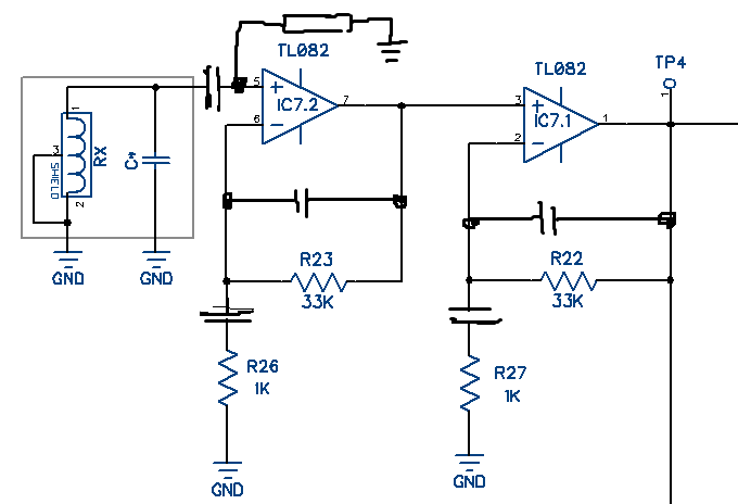

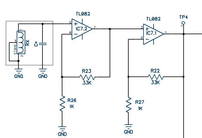

        How about changing preamp configuration (1000 gain vs ~600 in the original schematic). Example:
        • #64
          This circuit has many problems. The original schematic is the best variant. Well, you will do good if you don`t try to discover America. Click image for larger version

          • #65
            Тhe best variant AC amplifier.Click image for larger version
            • #66
              Where is the problem in this circuit example
              • #67
                DC stability.l are not teacher for electronic .
