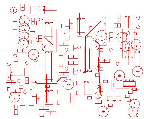

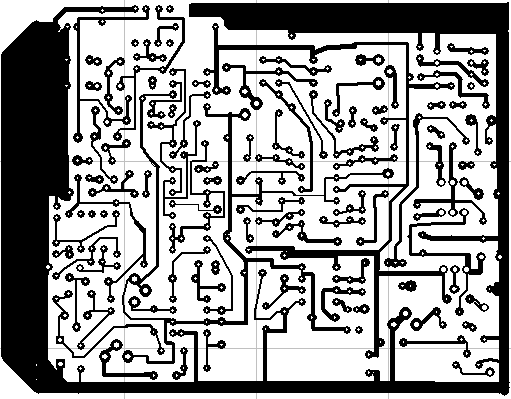

    • Bill of Materials
      Can anyone post a BOM?

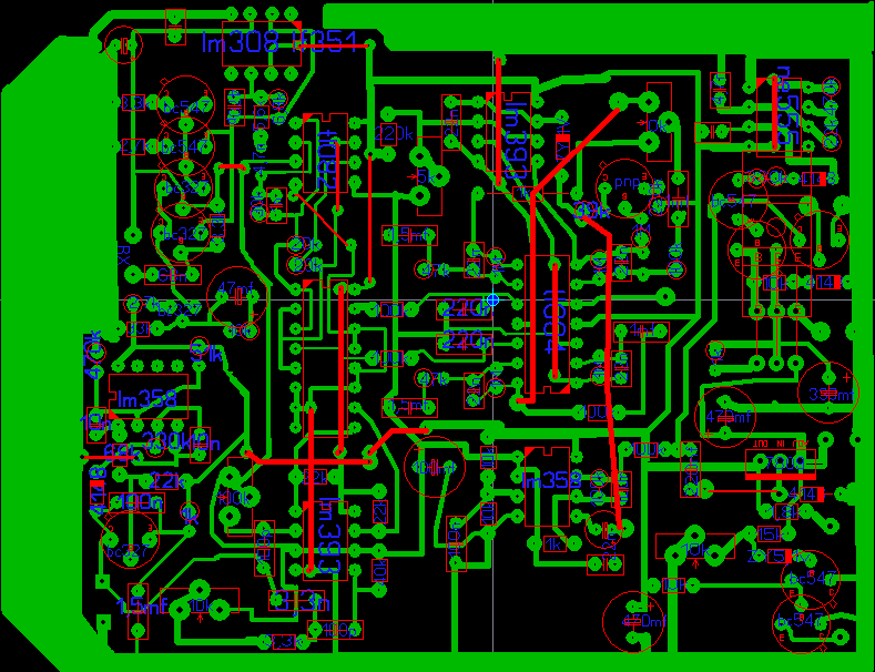

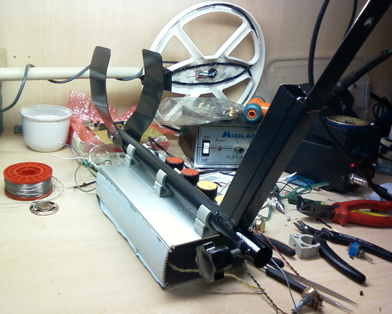

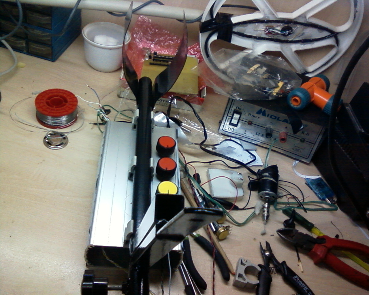

      • Congratulation Gurdal. Very handy design. Are you doing some tests?
          Pozdrav svima napravite jedan jednostavan test . Postavite ispod jedne pune cigle debljine 6cm novcic 18mm a pre toga nastelujte detektor da ne svira na samu ciglu sa potenciometra za graund balans a diskriminator podesite tako da ne vidi gvozdene predmete . Videcete sledece skoro svaki detektor koji ima dd sondu probija ciglu i vidi taj novcic , a svi detektori koji imaju koncentricni ili koplanar sondu taj isti novcic nece videti e toje objasnjenje za to sto je nas prijatelj probao cesara i soveringena pa je soveringen bio bolji kod cesara stavite iskljucivo dd sondu koju je ivonik opisao i videcete da je to prava stvar i manite se blue maks itd mislim na koncentricne sonde . Molio bih prijatelje koji znaju engleski da ovo prevedu realno.
          Google translation:
          Hello everyone, do a simple test. Set up under a full brick thickness 6cm D18mm and before that you do set the detector to detects under a full brick (and potentiometers for GB and diskriminator set so as not to see the iron objects). You will see the following: almost any detector that has a DD coil penetrates a brick and see the coin, and all the detectors with a concentric or coplanar coil will noe se the same coin. To the explanation for the case which is our friend and tried cesar ML Souvereign so Souvereign was better than cesar. Connect the DD probe only described by ivconic and you will see, it's the right thing. Leave the blue max, etc. and other concentric probe away.

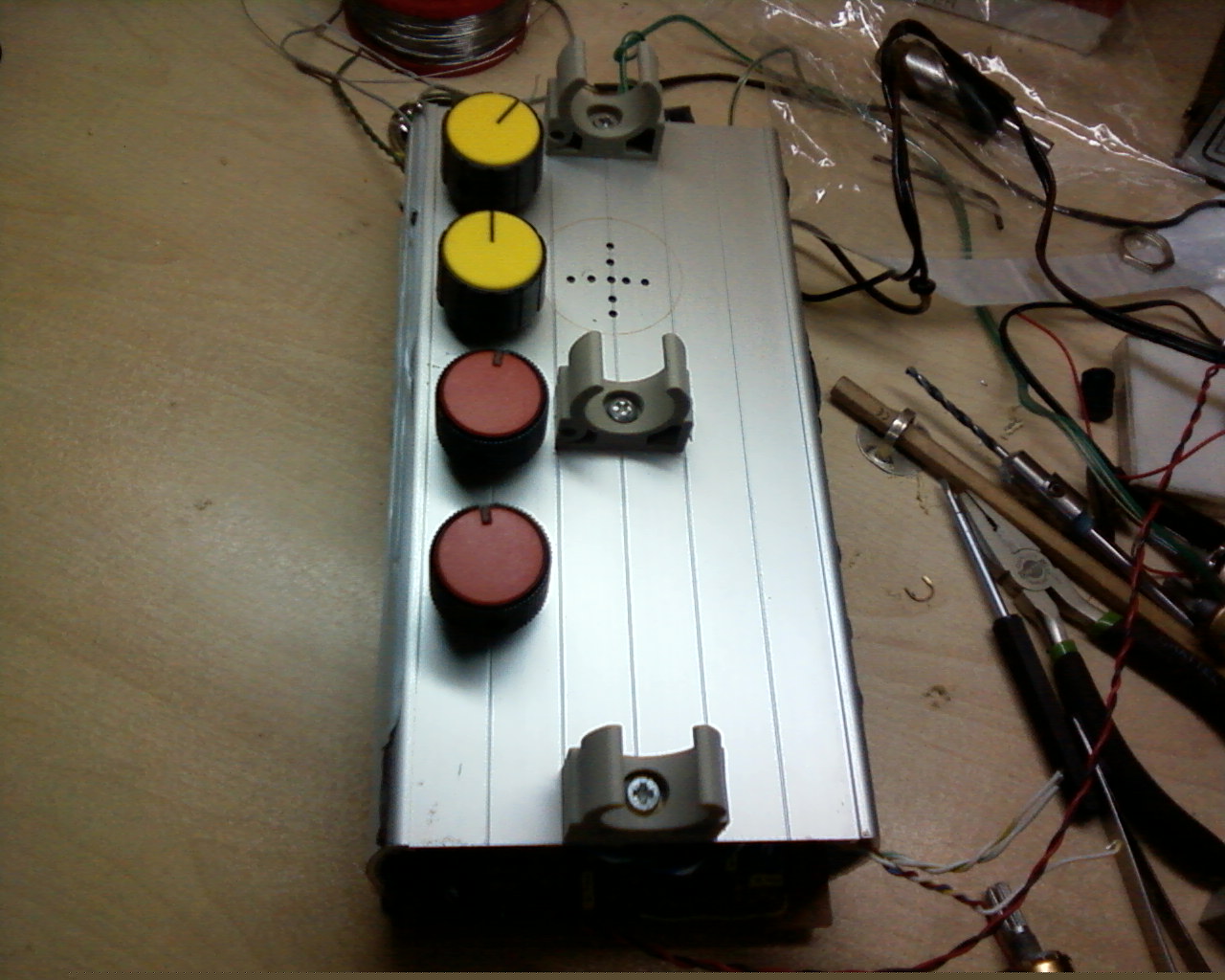

            5x5 aluminum box in the air will be detected from a distance of 1 meter.
            discrimination and was not able to test yet, but underground
