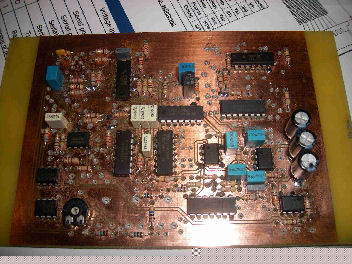

        I'm here... my RH clonation stalled a bit... I have also other stuff to do ATM. The troubles are still on disc... I'm also a bit annoyed of it cause everything else seems work but iron is still detected from far in disc mode... and if not corrected this behaviour is a real crap.
        Till now no more mistakes found there... nothing just it simply refuse to reject iron at deep!

            I see... but if so you must conclude as I do that there's something wrong: now we use different coils and get similar results...at least seems Coinseeker behave this way on soil... where my stuff even on the bench... so I think there must be something wrong in schematics or , at least, in components.
            I don't belive original RH has such kind of problems... impossible to me.
            What do you think about ?

                That's the real question... cause I've tested about everything about disc and cannot stop that dang iron response from far away! Is the circuit designed for this ?
                From simulations and real measures I get same stuff... so I cannot explain why, even if coil is wrong, I get iron ignoring from very near and detection from far away ?????????????????????????????????????????????????? ??????
                That's unbelivable stuff... that one needs to put near and near the iron to get it ignored. Is the opposite of other detectors!

                  Hi Max,
                  The problem about far detection for iron really makes me think of coil arrangement,(nulling) where at greater distance you would have (for example)a decrease in amplitude, but at closer distance it would rise again,(after passing by a minimum) and then be ignored.
                  I should be able to find almost all components for my PCB, but i have been working on other project (flight per view w/GPS and OSD to build an UAV ) and repairing my boat engine that failed

                      Max,
                      What does the output from the Discriminator gate (U2 pin 7) look like? In simulations, I see that it is unbalanced for some settings of GB/DISC. Seems to come from DC offset at U6 pin 7. The gate shout be equal in on off times. If it is not, that play tremendouse havoc with discrimination.
                      Still researching!
                      J. L. King
