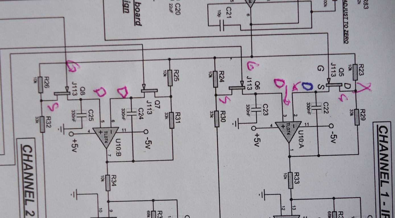

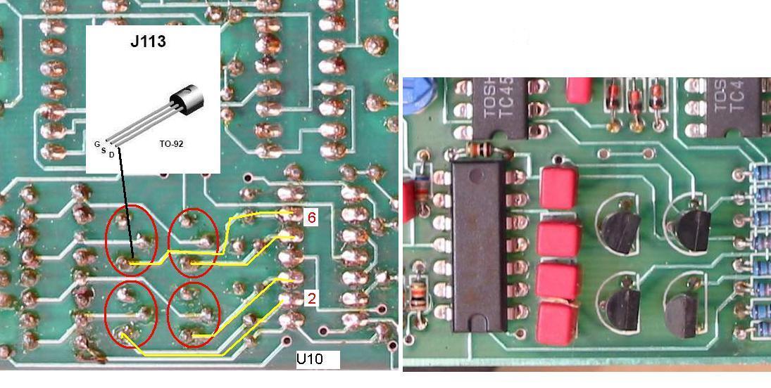

    Terminal "D" of J113, is connected in pin: 2; 3; 5; 6 of U10, respectively.
    So I have it in my GS4, which is working.

      hello jose ... I think I got confused with the answer there I took a picture so you can see how I understood the last answer ... according to your last answer q5, q6, q7, q8 must be modified pin D ... ERROR IN THE SCHEME DE alex? ... Greetings
      • Yes, it is exactly what you published.
        The image below taken from the original, can clarify the doubts.Click image for larger version

        • thank you very much jose for your clarifications .. in the case of q10 and q9 the pin D If it goes to earth? since by the mentioned thing now I think in q10 and q9 are not correct in the scheme?

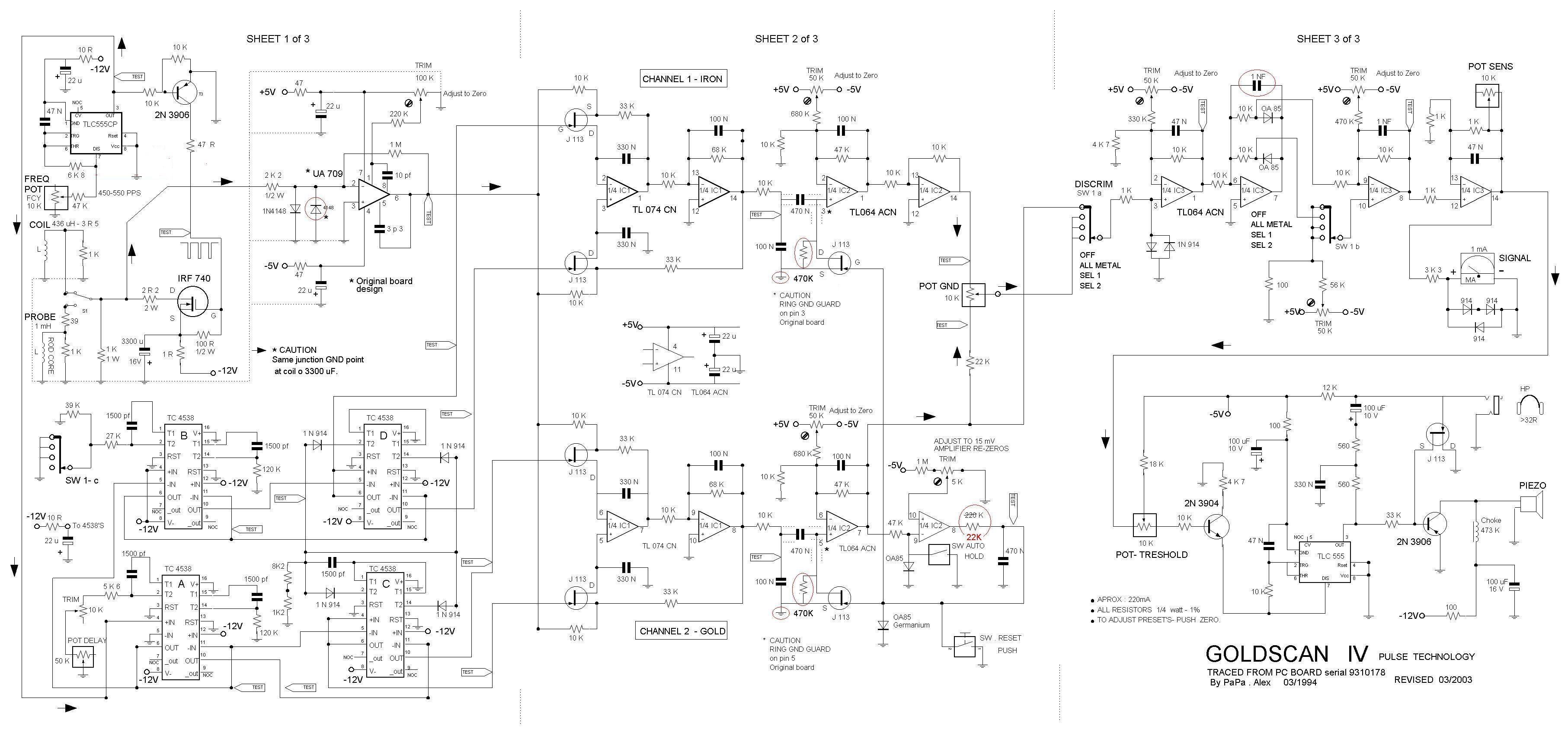

          • For the case of Q9 and Q10, the "S" terminal is connected to ground or GND. The attached diagram is correct, although there could be some error.Click image for larger version

                          • Goldscan is very very tricky to get properly working.
                            I would strongly suggest looking into easier project like Minipulse and Barracuda which do have complete "final schematic​"
