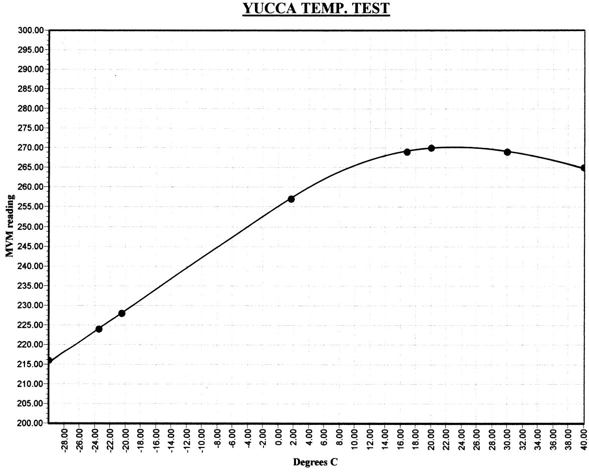

              .... One thing I have to be careful of is ambient temperature as this affects the viscosity reading. Theory predicts this as borderline SPM grains become progressively blocked as temperature is lowered. This is why the ground in Australia becomes quieter at nightime when the ground cools down.
              Eric.

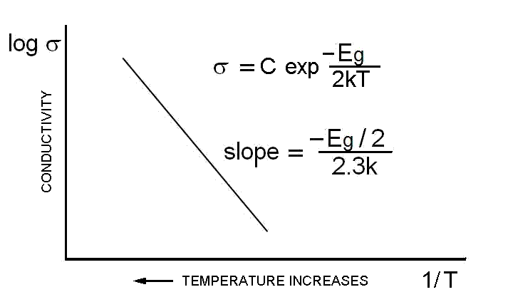

              There is another explanation for temperature dependence of soil properties:
              Some OZ dirts contain semiconducting ore minerals.
              The electrical conductivity of a semiconductor increases exponentially with an increase in absolute temperature T.
              The graph of equation for conductivity (sigma) vs temperature T is given below as log vs. 1/T axes to get a linear plot.

                Changes in magnetic viscosity amplitude plus small changes in t^-x exponent are the favoured explanation. In the small volumes of soil that a metal detector energises, dispersed mineral conductivity, or semiconductivity, does not play a part. At least not with the detectors I have tested. I have proved by practical tests that base susceptibility and frequency dependent susceptibility change with temperatures that would be experienced in the Australian goldfields. On a hot sunny day ground surface temperatures are heterogeneous for lighter and darker materials and whether shaded or not. This results in a spread of exponents of which some fall on the edges of the GB notch. I can hold a piece of ground balanced ironstone in my hand and due to that small rise in temperature the GB point is slightly altered. During the night, the ground temperature differences will even out and the spread of exponents reduced considerably, with the result that the detector runs quieter.
                Below is a plot for powdered Yucca Mountain Tuff, which is an accepted standard for a natural magnetic material, showing how the viscosity changes with temperature. The changes are more dramatic for Oz ironstone because of the very much greater susceptibilities. I haven't yet plotted these but I have seen the effect by putting a 10gm piece in the freezer, then in the oven.
                Yucca Mountain Tuff peaks at around room temperature as it has a very narrow range of SPM particle sizes. Other soils and rocks, with a larger particle size range, will peak at somewhat different temperatures no doubt.
                Eric.

                • Hi Eric,
                  I have performed similar test of the temperature dependance of the viscous signal. In my case it was not the result of independent thinking but rather knowledge of the practice of "thermal cleaning" in the study of paleomagnetism.
                  Knowledge of this phenomenon helped me absolve the detector from suspicion of thermal drift, but I couldn't find any other practical use of this knowledge.

                    Hi Allan,
                    I must admit that I find the subject of soil and rock magnetism very interesting in itself but there is a practical side to it as well. Unusual phenomena are sometimes reported by detectorists and sometimes the popular explanation is an incorrect guess. This is certainly so with signals from rocks and so called mineralised ground. This is a very big subject in the demining field, as you know, and the more information we can find out about the origin and nature of the ground response, the better designs will be to minimise it. I am working on this too. I have found today that a temperature rise of just 10degC will change the amplitude of the viscosity signal of Red Hill soil by about 5%.
                    Eric.

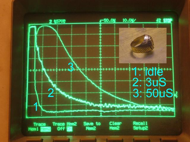

                            • Interesting test
                              This below is very interesting target response (of relatively large ring) to different pulse widths, 3 and 50 uS in this case, generated with same peak current, so magnetic field straight and stored energy is identical. Top is 50uS, middle is 3uS, lower is idle setup response for reference, 10 uS\div.
                              Response varies not only in magnitude, as expected, but also in shape of decay curve (anticipated, but now i captured it). Response is interesting, increasing pulse width, it rises up to one point when it remains fairly constant for any further increase. Perhaps the easiest way to determine target TC. Note this is only response waveform, integrated measurement produce even more dramatic change. This is relatively short TC, with longer TC objects change is even greater. Unlike this, ferrite response remain almost unchanged, i suppose soil will be somewhere between, also salt water may be interesting to see. This is bit problematic to measure with normal MD setup, only varying pulse width will also change peak current, and stored energy, so initial conditions are different. In my version TX time is variable continuously over 50 to 1 range keeping other conditions almost unchanged.
                              Basic idea behind this is to utilize difference in response of soil and metal to two different pulse widths, one very short, below target TC and one longer, above TC to establish GB. If it fails in ground, idea may be seaworthy, enabling very fast sampling detector to operate underwater without being affected. All this is just at theory, but even if it fails completely, i will at least gather enough data to know exactly why. Sometimes this make more fun than actual detecting...

                                Hi Tepco,
                                Language differences do make for problems sometimes when trying to convey thoughts and ideas. I saw no criticism in what you said, and I welcome viewpoints that are different from mine. It is good to see someone testing, doing experiments, and learning what works and what doesn't. I am still a learner after 47 years in metal detection as new technologies and measuring systems bring new facts which have to be assimilated.
                                Is your transmitter of the TEM type as advocated by Tinkerer? I have not tried that yet, but different shape TX waveforms will give different results.
                                Keep up the good work, and keep us all posted.
