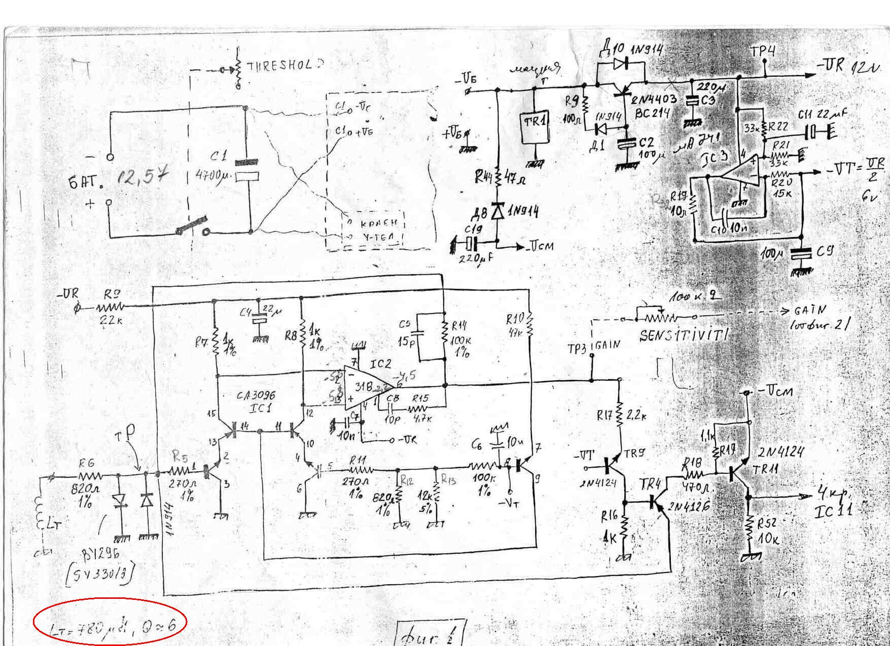

            Oryginal coil Pimdec .Superdec .. is 780uh .
                That makes things a LOT more stable and predictable!

                    One more update on my drawings: SUPERDEC 1.02.pdf

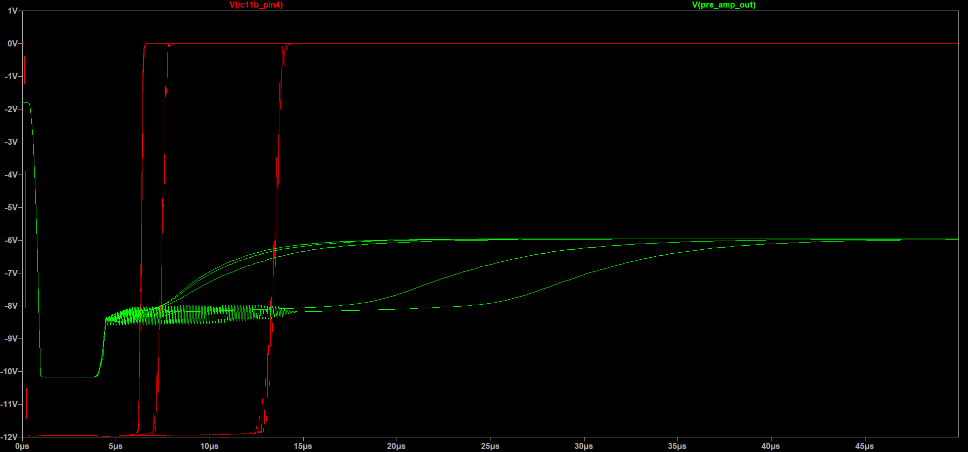

                        ... The transistors Q6, Q7, Q8 (TR9, TR4, TR11 of Eric's superdec schematic) form a triggering circuit for the sample timing circuit (IC11b, IC12a. IC12b). This is quite novel as it ensures the start of target sample delay is after the preamp is out of saturation regardless of target strength. In other words the actual sample delay will shift (increase) as target strength increases...
                        I did a sim run to demonstrate the above described behavior. The run modeled a 5 usec tc target. The run uses a step command specifying the target to coil coupling of 0.001, 0.005, 0.01, 0.05, and 0.01 to simulate increasing target strength.
                        The green traces show the pre-amp output and the red traces show the signal fed to IC11b pin 4. The trailing edge (positive going) of the red trace triggers the start of the target and subsequent delays.

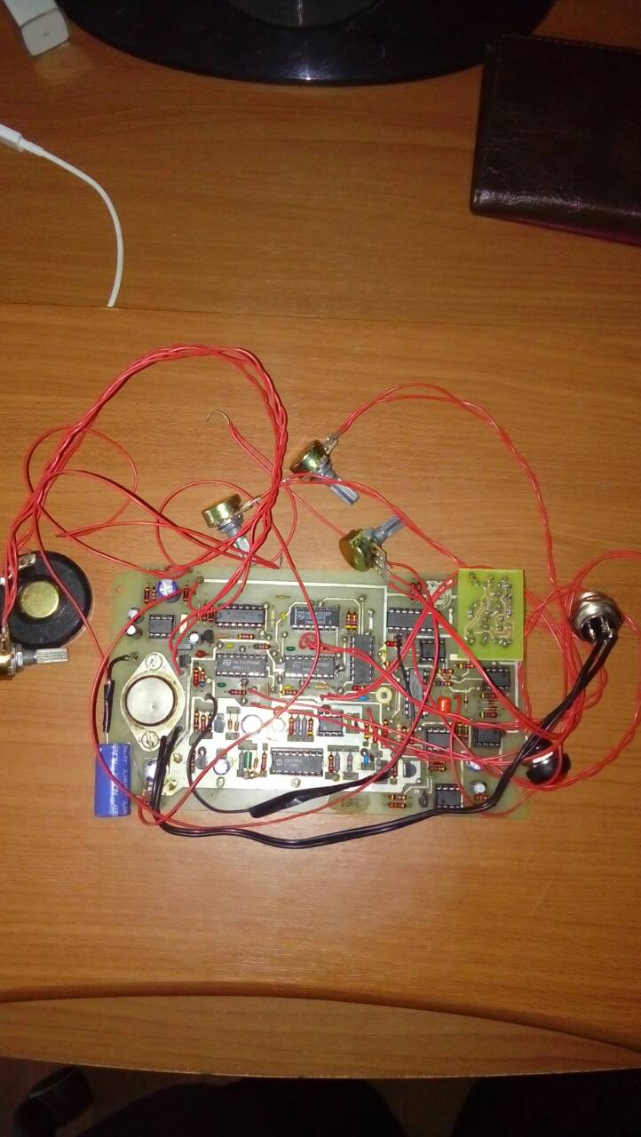

                          Finally revived after 27years .Click image for larger version

                              Finally revived after 27years .[ATTACH]42191[/ATTACH]
                              Well done! Is it working, such that you can post waveforms? Can you measure your coil resistance and post the value?
                              Eric
                              • #90
                                Eric
                                Hi Eric ! I do not have an original coil I tried it with a coil Goldscan 4 but I have data in hdd on the old scheme ( 780uh Q 0.60mm ) when I have time I can measure it and post waveforms !Click image for larger version
                                Otherwise works solidly and stable !
