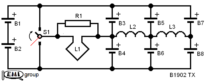

        I have proposed to save transmitter and TX antenna, according patents of Vaino Ronka. Let us examine whether is received signal by some powerful VLF radio station.

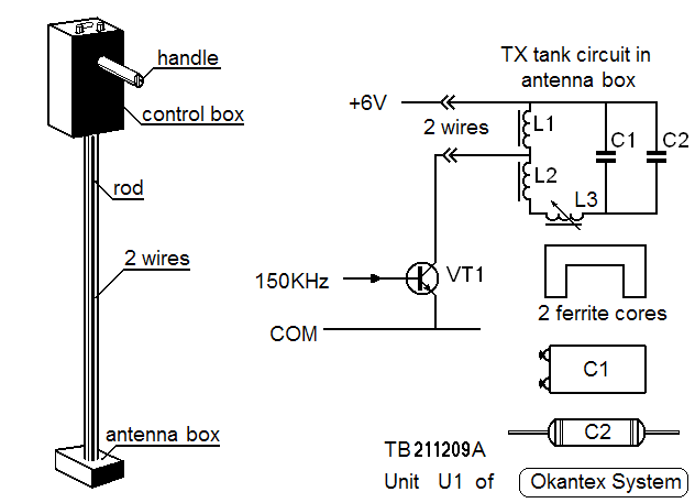

        Before we begin to design the advanced Okantex System 2, let's review the information for antenna of unit U1, which provide far Okan, and think whether it is reliable.
        In the attached figure is shown the most likely circuitry in antenna box. The transistor is connected to tap from tank inductance for antenna matching. Winding L3 is used for fine tuning of the resonant frequency.
        Under the circuit are sketched Russian parts that might have been used. Note that the capacitors have metal housings. A capacitor much like the 9V battery, and the other a metal pipe. How should be oriented ferrite cores to emit a magnetic field down to earth?

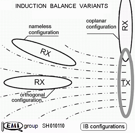

            • The term "2boxxxx"?
              What means the term TWO BOX or “2box”?
              This kind of metal detector whether or loop configuration in EMI sensor?
              The REMI group is training for amateur MD designers, so it has undertaken to rediscover, reinvent, revise and redesign EMI sensor and devices connected to it.
              REMI group was founded by amateur radio designers, not familiar with strange English terminology in the field of metal detectors. The group required to define terms and concepts used so far in this area so the designers to understand each other. Note that the term "EMI sensor" is the revised variant of terms: "search coil", "loop", "antenna", etc.
              A REMI group member can be considered anyone who rediscover, reinvent, revise and redesign something in EMI sphere what other members don’t know. This can be a term, for example “TWO BOX” or 2boxxxx. Then the reviser should send a description of his work for discussion by the members before it is published.

              Now to put in my place and try to answer the question of a member: „What means TWO BOX metal detector?” He was frisked WEB and Wikipedia and was found that
              “Two Box - A metal detector that has the transmit and receive coils mounted in separate housings. By enlarging and separating the transmit ...” www.beginnermetaldetecting.com/metal-detecting-glossary/
              Then I read the manual for metal detector GEMINI-3. It is indeed a two box MD.
              My next step was to explain the definition:

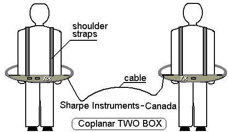

              The TWO BOX metal detector is a system of two boxes TX and RX used by two operators. Each box contains its battery and antenna.
              As an illustration of my definition, attached is a sketch made by an radio amateur at the Plovdiv Fair somewhere in 70-ies.
              The sketch represents a TWO BOX system produced in 70-ties by a Canadian company “Sharpe Instruments”. The system is used for prospecting with sine induction at 1600Hz.
              Both boxes seem more as large hoops and operators seem as coil cores. Both units are connected by a long cable trailed on the ground.
              Note that when the system is in action, the mutual inductance between loops varies random.
              • REMI redesign

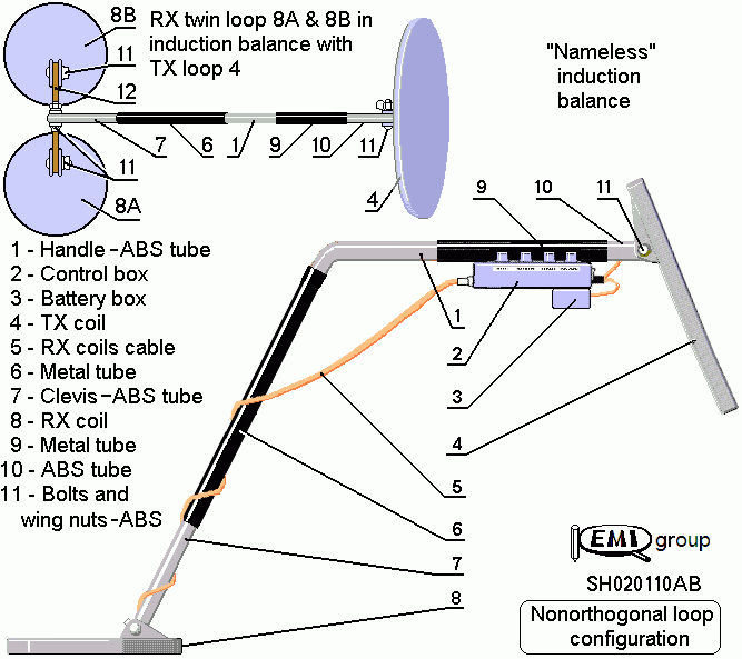

                The REMI group decided that the design of Sharpe Instruments has two major disadvantages: coplanar nonbalanced coil configuration and long cable between units trailed on the ground. The group eliminated the shortcomings making orthogonal loop configuration to reduce AIR signal in RX and synchronous demodulation without cable connection with TX. The REMI redesign looks like this:

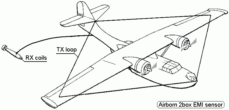

                • Airborn 2box
                  Experiment shows that the improved design has one flaw inherent in all TWO BOX systems: unstable mutual inductance (variable AIR signal).
                  CONCLUSION: "2box" or
                  TWO BOX is an EMI sensing system in which the mutual inductance between RX coil and TX coil changes random when RX and / or TX box moves.
                  This means that the two loops are not fixed, so RX coil receives changing AIR signal.

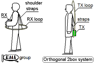

                  However the term TWO BOX is used by merchants of metal detectors and Charles Garrett to denote Orthogonal Coil Configuration. Perhaps this is because the boxes of Gemini can be mounted in a rod as orthogonal coil configuration with induction balance. But the GEMINI system can act as TWO BOX used by two operators. However this is not possible for other “2box” machines as TM808 and TF900, because they are not TWO BOX detectors.
                  The definition of the REMI group is illustrated in the attached figure. The sketch shows an airborn prospecting system. It is TWO BOX system, because the mutual inductance between RX coil and TX loop changes random during the operation.
                  • Nonorthogonal or unnamed loop configuration
                    Carl Moreland uses the correct term “orthogonal” induction balance for “2box” machines as TM808 and TF900. However an EMI sensor type “Depth Multiplier” can be set in induction balance with not orthogonal loops configurations. This is illustrated in the attached figure. Note that the “unnamed” loop configuration is more suitable for “2box” machines because RX loop is moved close and parallel with ground. This is a reinvention because an ancient “Audio Spectrum” metal detector uses the scetched EMI sensor. Unlike the fixed coil configuration in TM808, TF900 and Depth Multiplier of Garrett, the loops can be adjusted to induction balance with fine rotation.
                    • Modernized variant of an ancient "Audio Spectrum" machine. The TX loop can be adjusted to induction balance in a nonorthogonal "nameless" configuration. Note that the RX loop or twin RX loops are close and parallel with ground unlike a conventional orthogonal configuration.

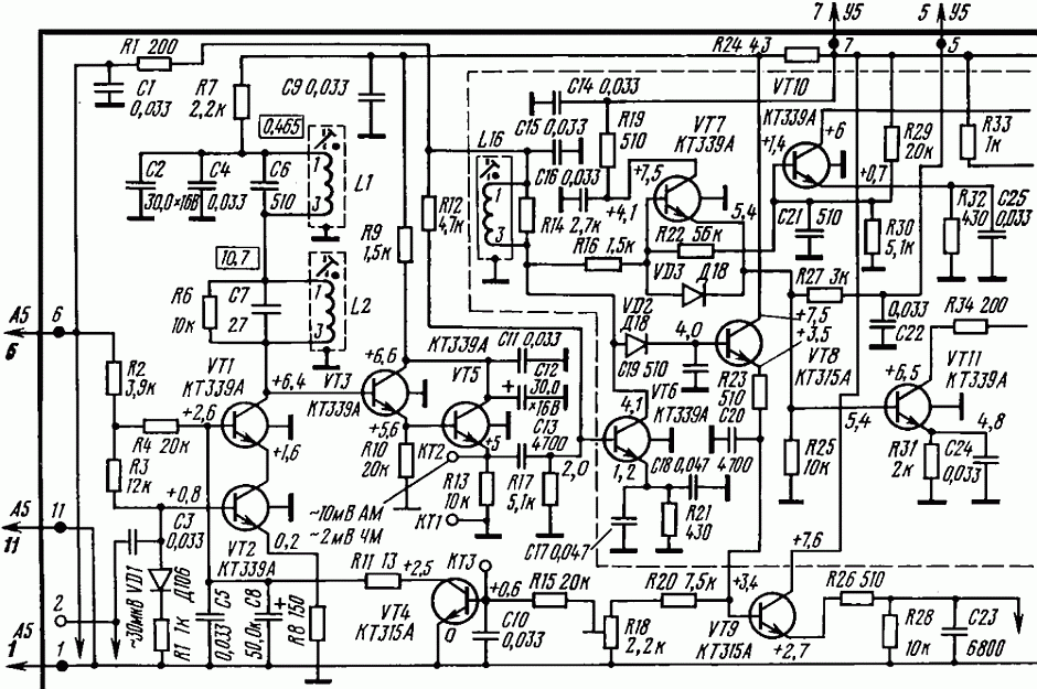

                        • AGC and AFC systems in receiver L006
                          AGC system operates as follows:
                          Without signal in input of IF AM amplifier, through diode VD2 flows base current of transistor VT8, which determines operating point of transistors VT8 and VT9. Trimmer R18 is selected voltage delay, at which the AGC amplifier transistor VT5 is closed.
                          When there is carrier frequency signal in the input of IF AM amplifier, in the output of amplitude detector (on the diode VD2) is formed DC component of voltage. Due to detector current, increases the base current of the transistor VT8, and hence the emitter current of the transistor. The voltage on resistor R18 increases, and transistor VT4 opens. The collector current of transistor flowing through resistors R4, R2, reduces the voltage on the basis transistor VT1, which, in turn, causes an increase in current through transistors VT3 and VT5. Collector circuit of these transistors are fed through a resistor R7, on which increases the voltage drop.
                          If collector-emitter voltage of transistor VT3 achieves 0,1-0,15 V, then its input resistance decreases sharply and it shunts tank circuits connected in the collector of transistor VT1. This leads not only to reduce the gain, but also to expansion of the bandwidth of the amplifier due to changes in labor quality factor of tank circuits L2, C7, R6, and L1, C6. Capacitors C5, C8 and C10 filter AF and IF components. Voltage of AF signal from the output load R28 emitter follower VT9 through RC filter (R26, C23) and the switch S1 is fed to the input of AF amplifier.
                          The IF AM signal voltage from collector of transistor VT6 is fed to the input of the discriminator tract AM through resistor R16 and filter R22, C21 . Discriminator is build of transistor VT10 and diodes VD4, VD5. From the output is removed control voltage for the AFC-AM (automatic frequency control for amplitude modulation) and for differential amplifier of indicator P1. The load for transistor VT10 is two tank phase shifting transformer L3, C28 and L4, C32 with inductive-capacitive coupling. (See circuit diagram in posting #519 ).
                          Control voltage for AFC-AM is supplied to variable-capacitance diode VD1 is located in block SW-MW-LW (A5) through the resistor R45, the switch S1 (contacts 2-3), contact 4 of block A4 and filter R25, C16 of block A5 . Control voltage to the differential amplifier is supplied with indicator midpoint divider R40, R41. Differential amplifier for indicator P1 is build of transistors VT13 and VT15. It provides the arrow indicator P1, which is connected through contacts 12 and 13 of block A4. The differential amplifier operates as follows.
                          When no input signal to the radio, the transistor VT13 is closed and the transistor VT15 is open and through the turnout indicator P1 proceeds collector current of the transistor. The bias voltage at the base of the transistor VT15 is fed directly from the battery through divider R54-R56. Therefore, the initial deflection of the indicator P1 is set with trimmer resistor R56 so that it corresponded to the nominal voltage of the battery, while at least battery discharge indicator reading decreases.
                          When there is input signal to the radio, increasing positive voltage at the base of the transistor VT13 and increases its emitter current. The voltage drop on resistor R51 reduces the collector current of transistor VT15, flowing through the meter P1. When the voltage on the base of the transistor VT13 is greatest, which corresponds to fine-tuning the received signal, the current through the meter P1 turnout will be minimal and thus deflection of the indicator will also be minimal.
