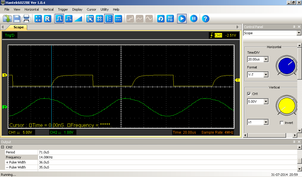

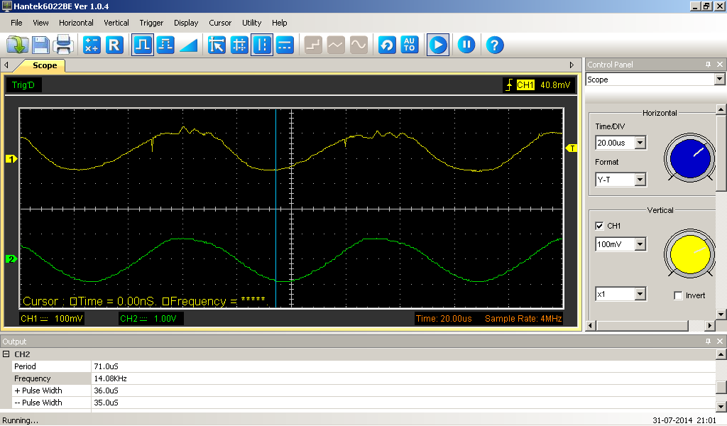

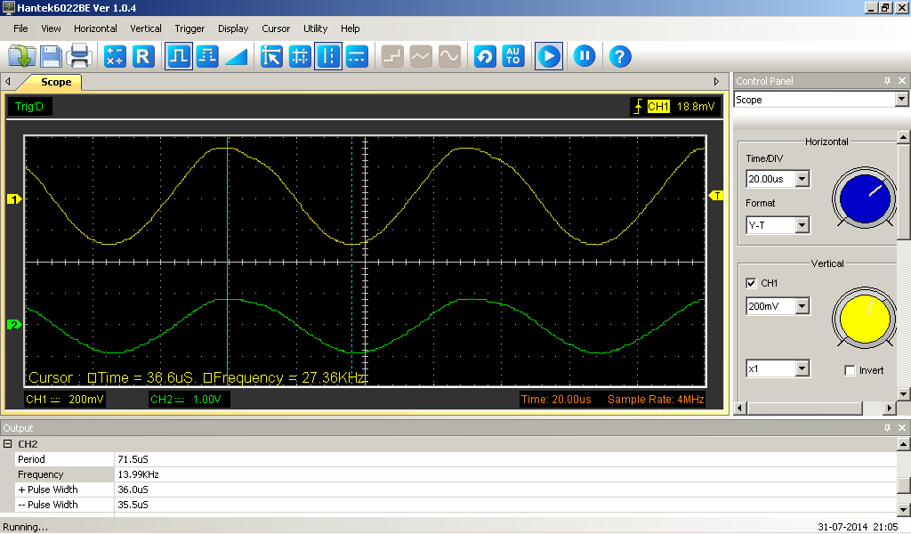

    • Screencaps
Name:	tx and rx.PNG
Name:	tx and pin7 u101 LF353.PNG
Name:	tx and gate of tr5.PNG

            Can you comment my oscilloscope screens ?
            I have tried basic nulling with voltmeter and then I half hot glued coils.
            Did not use oscilloscope for phase ...

                >Sometimes it can help if a small piece of iron or copper is attached to the coil near the cross over watch the scope trace on the RX and go for best null
                I would like to see that screens before and after
                I don't understand it, my traces are few post before this - too technical for me
                I am doing only 0,04mV AC part

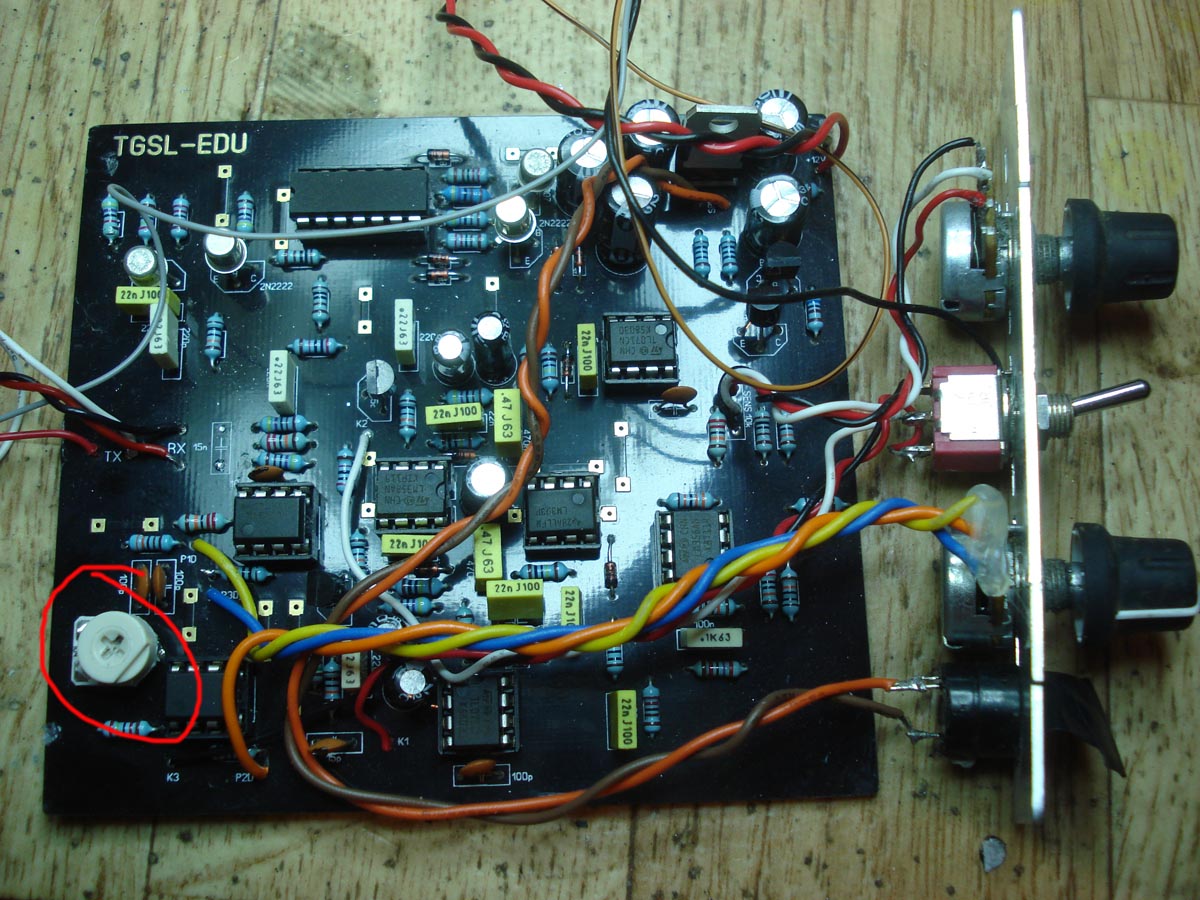

                  • BTW my GB trimmer is used every time to change - reject ferrite and to accept silver coin
                    at this moment it is over half to right
                    • you buy kit from silver dog or you just buy board from silverdog

                        • Originally posted by paku View Post
                          full kit both times
                          about same results
                          three coils - first one was bad ... used some wierd glue and it shrunk after few days

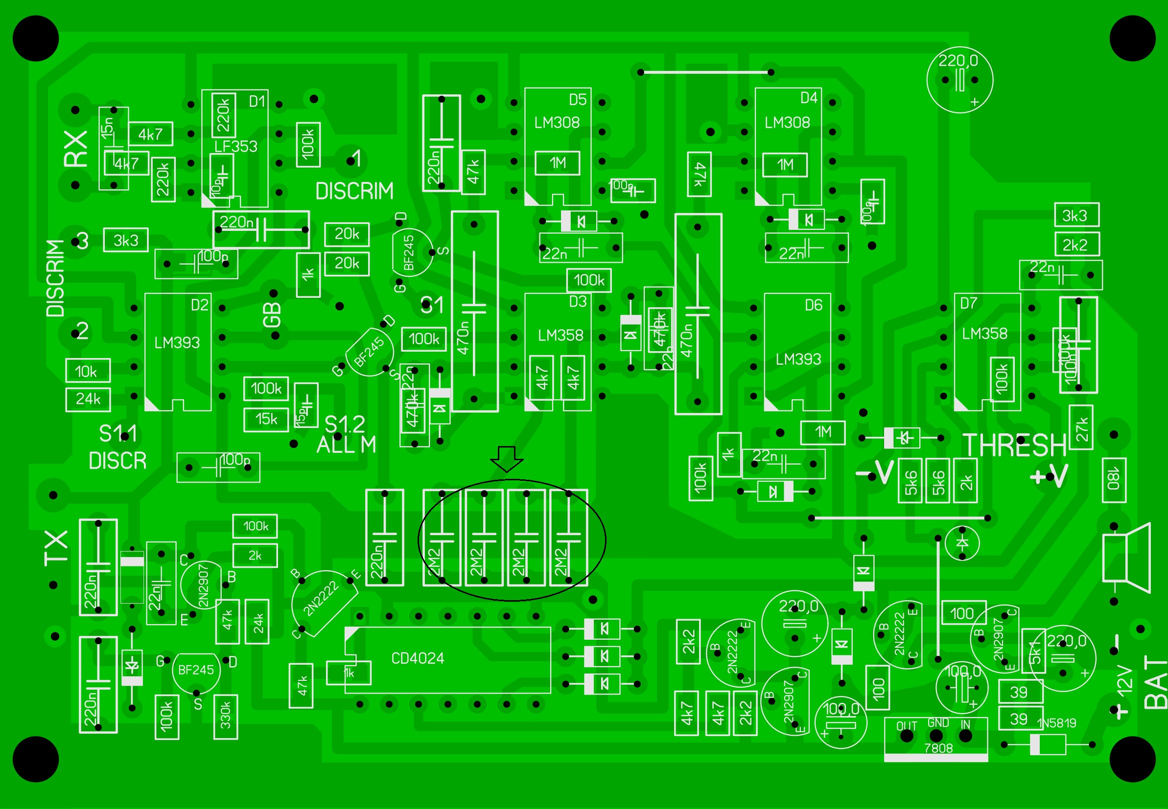

                              can somebody explain what is that caps or resistor
                              • Looks like 2.2 uf caps. By using 2 in parallel you get roughly 4.7 uf nonpolarised.
