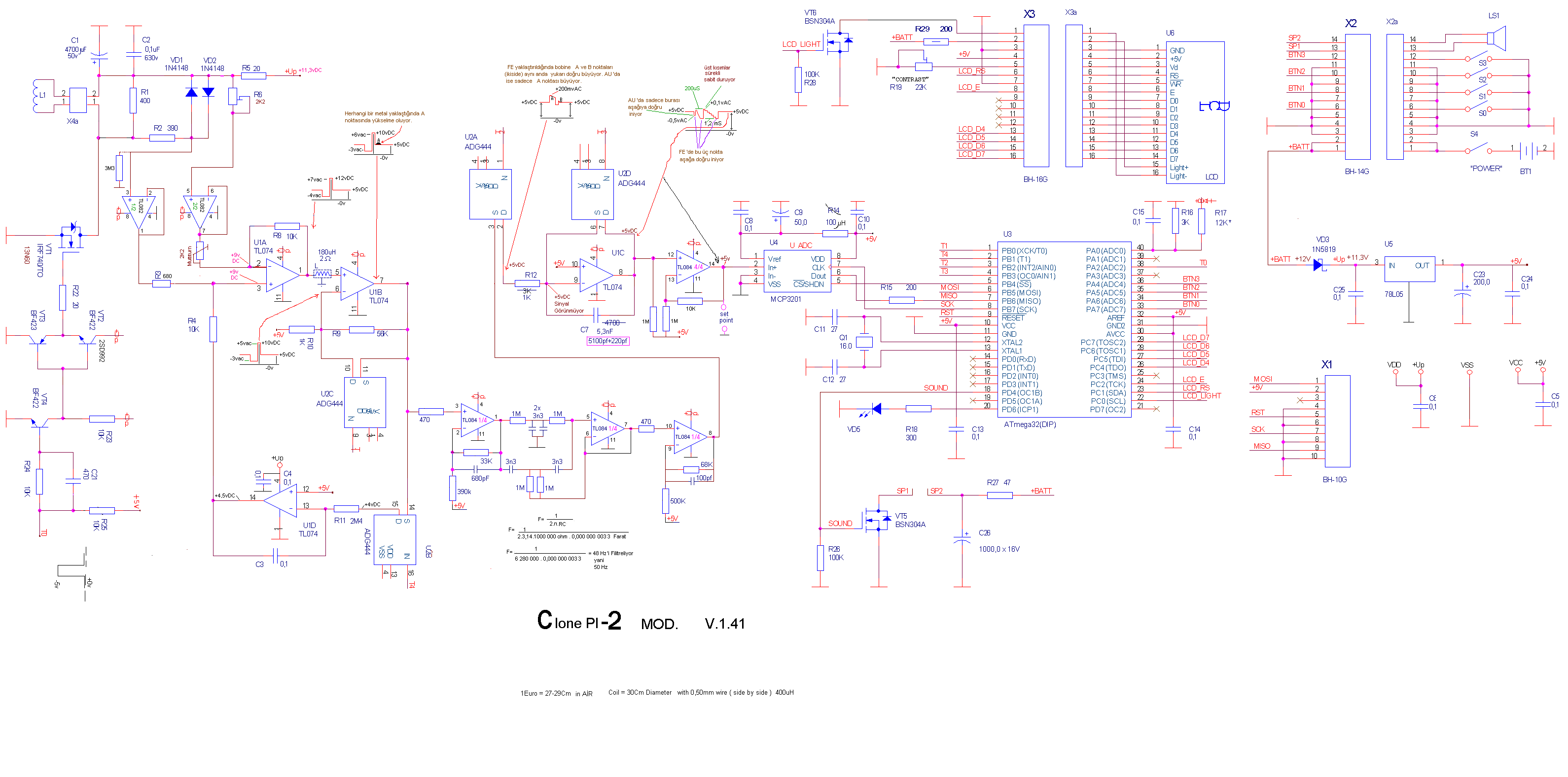

                          • #43
                            Clone Mod.
                            Clone Mod. with Good Discrimination.

                              • #45
                                Hello Humhum,
                                very good job,
                                could you please traslate in english the comment on the schematic that aren't ?
                                ... and could you please explain how you build the coil?
                                Thanks you.
