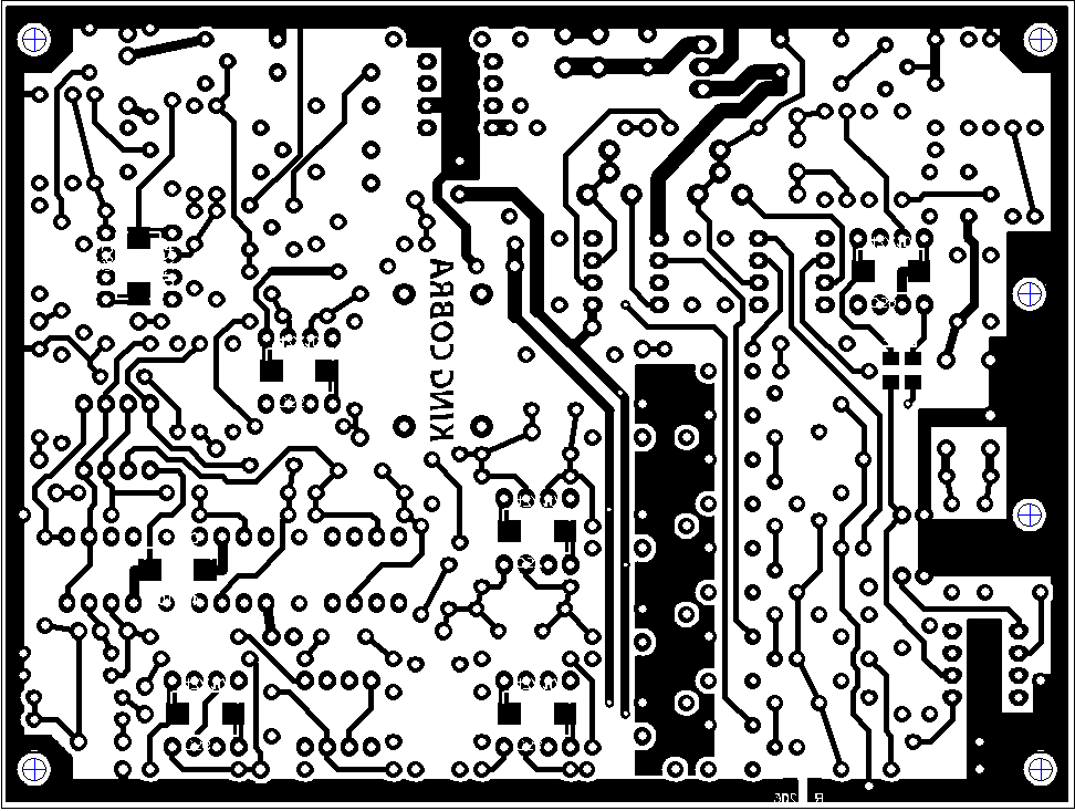

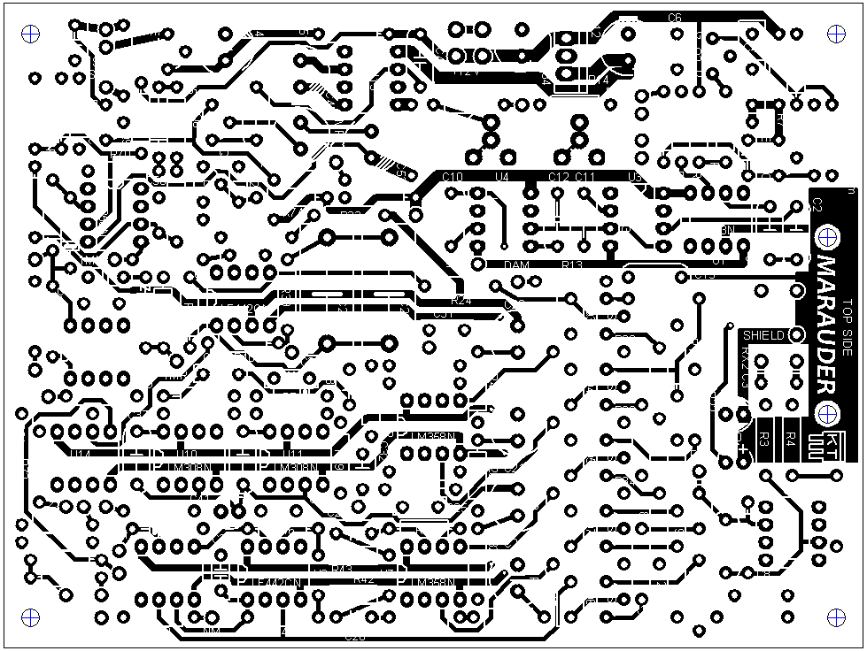

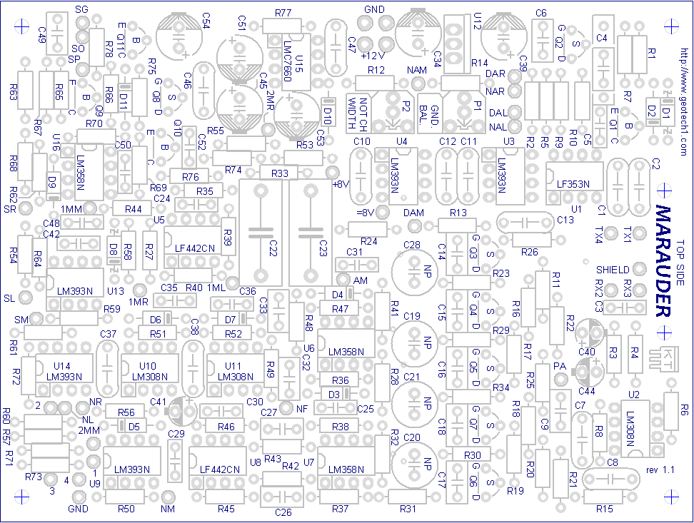

                      • top silk layer. may be used for printing etc.
                        • top copper side.
                          • bottom copper side.

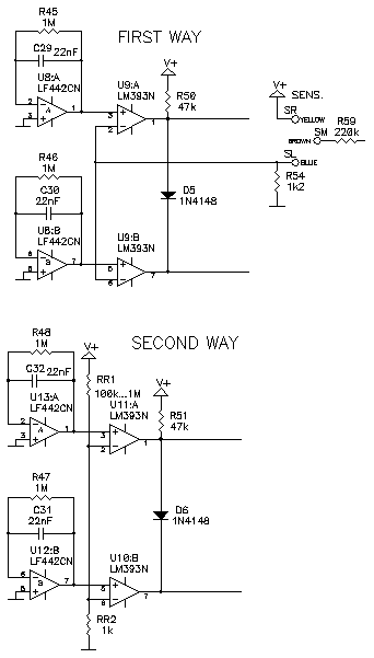

                              • I noticed Cobra (original) is sensitive to AC electric lines in my room, it gives 50 Hz hum on comparators' outputs of Notch part. the sound in Disc Mode is may be not so clear as you would like to see. temporary you can make this changing in schematic I drew, in two way, and get the clear tone.
                                best regards
