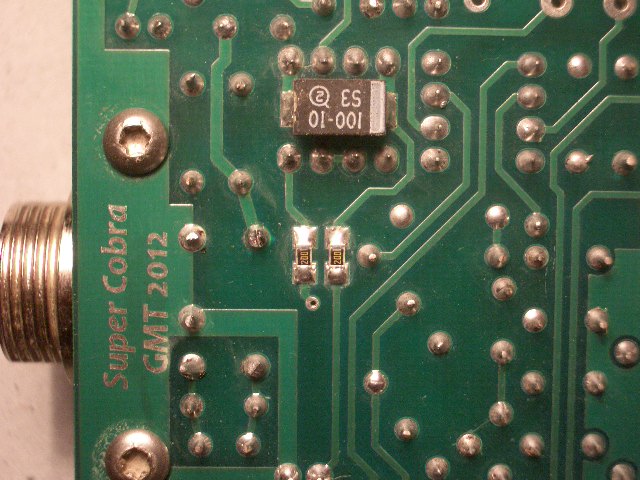

  • Jurgen, beautiful work, but I see a mistake. you have to turn the resistors R79 R80.
    good luckClick image for larger version

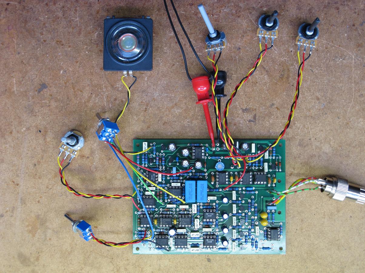

    • Anatolij, thank you for the hint. I have replaced the resistors.
      I have make first tests, the discrimination mode works with some inteferences, but the all metall mode works not. No metall is detected.
      I checked values of all parts and solder pads. Perhaps an OPAmp is fault.

        When you build a project like the King Cobra, it is always advisable to build and test the design in sections. Not simply solder everything onto the board, switch on, and hope it works. Nine times out of ten (Murphy's Law) you will be unlucky.
        You should start with the power supply, and work forward from there.

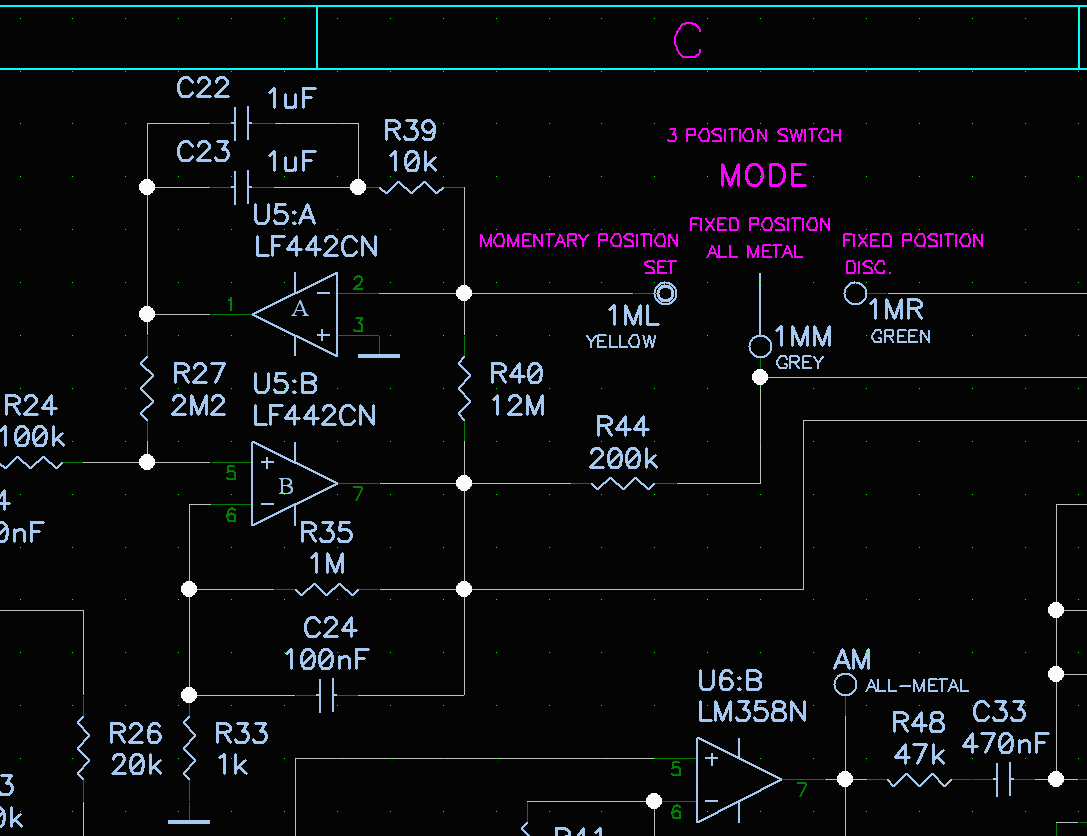

                  • The switch must have 3 positions. Medium position is to METALL ALL.
                    Yes, both switches are 3 positions of. This is seems from the photos I did put.
                    NOTCH - ACCEPT/OFF/ REJECT
                    MODE - DISC/ALL METALL/SET ALL METALL.This right position is NOT fixed, not fixedable, is only clickable. Althought you can take and use ordinary 3-P switch, but you have to remember to set the switch in middle position anytime (or fixed left one). SET - I mean you set the S.A.T. circuit to some zero, althought there is nothing new - you have to see this part in TGSL too and may be reading about.

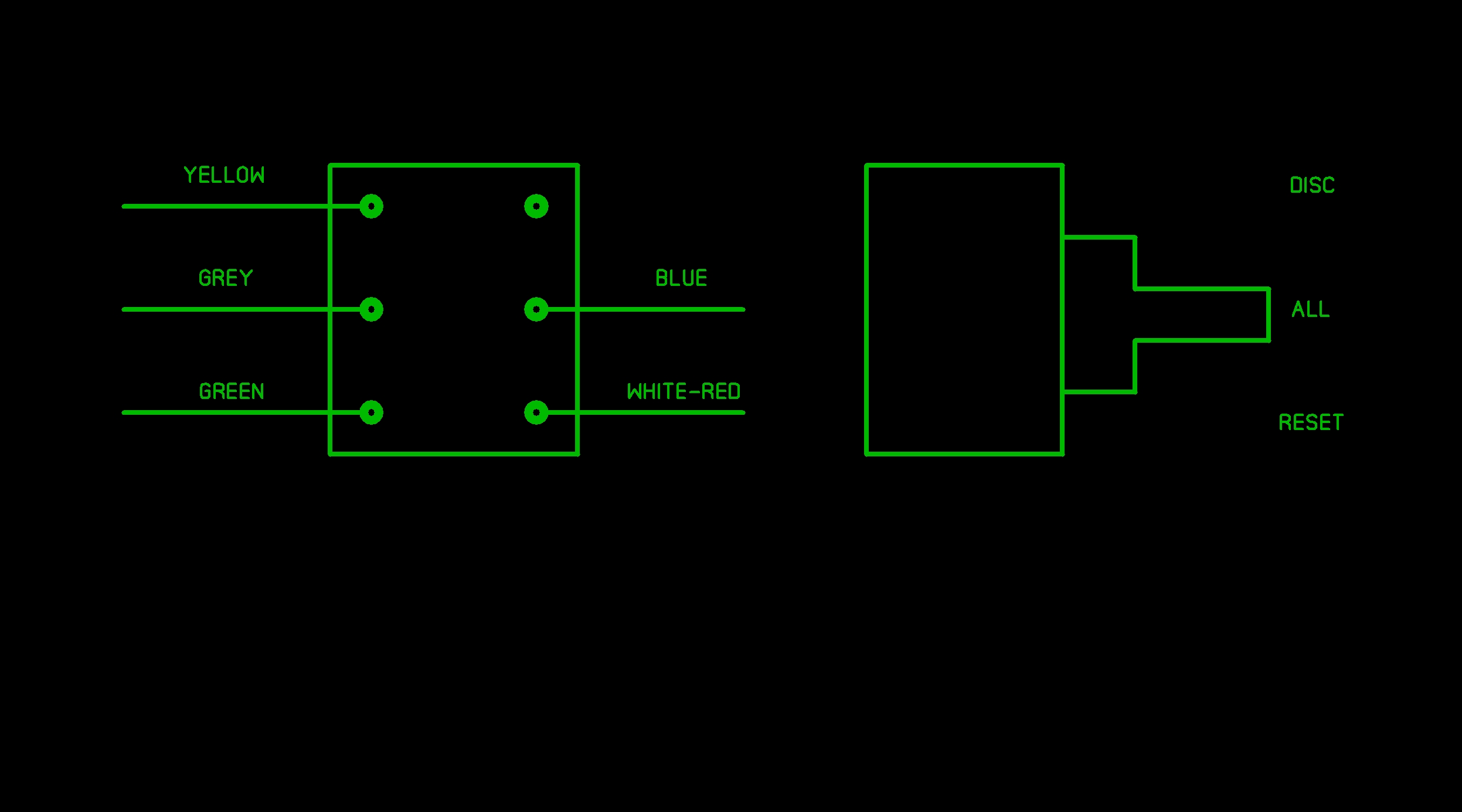

                    • SW
                      I've drawn the switch connections and added the colors of the wires in accordance with the scheme. I hope I can help with anything.
                      • Hello all,
                        My wires on sitch Mode was in a good order. I unsoldered all wire of the Mode switch and after I put in contact 1ML and 1MM together ( like All Metal mode ). Nothing no sound?
                        • Hello,
                          with a three position switch, the all metal mode works now. Many thanks. The all metall mode is a little strange without a tone for iron. Next tests outddors.
                          Jürgen
                          • Originally posted by Legaucho View Post
                            Hello all,
                            1ML with 1MM together is momentary switch position, not effecting all time, the push-and-release position. it resets the SAMPLE-AND-HOLD circuit in some zero state because All Metal is static mode. after you momentary touched 1ML with 1MM, you have to put the switch in middle position on all time, 'neutral position'. then that will be ALL METALL mode.

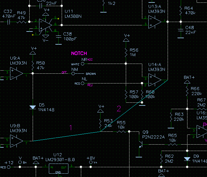

                              you can try to experiment like you see at diagramm - either 1 or 2, connecting by wire. I yet do not try this way, only expecting that it may be working in ALL METAL mode with the disc.Click image for larger version
                              • for better insight.Click image for larger version
