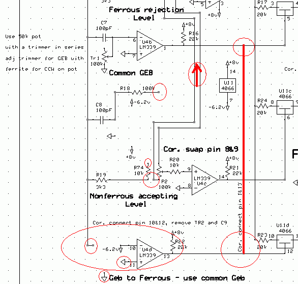

  • ?Davor thanks your suggestions later will I pelajarin scema from you can be sensitive to a brass coin got 30 cm but only beep sound tik tik are not strong and coin along with red brick test coin above the bricks sound similar to the sound of coin could not distinguish
    • ?Davor please show the deleted scema potentiometer after removed should be headed where the coaster and please show a jumper at scema let me know to where it should be deleted please be jumper thanks davor
      • The jumper is a short piece of wire soldered directly between these pins on solder side of a PCB, as they are pins of the same IC. Potentiometer is as described in the above drawing. You can use 100k potentiometer.
        • ?R74 connected where P2 heading over to where it connected to the bottom where R13 connected cor swap pins 8 and 9 must be connected to the lm33c U4c which makes me confused must be connected wherever you and your sorry troublesome R18 towards where must be connected

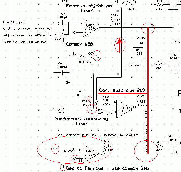

            • cast swap 8 and 9 pin ic lm 339 U4c connected whether you mean it

              • This diagram is a part of a larger schematic with many more mods than this common GB mod, and I indicated only U4b and U4d for this particular mod. Changes around U4c are for a different mod that eliminates U12, but you don't have to worry about that. Just make corrections as indicated for U4b and U4d, and you'll have a common GB control on your front panel.
                • I already follow your advice but still sensitive to red brick and stone River, seems to be defunct and GB in action against swing my hands near the coil what else do I need to do
