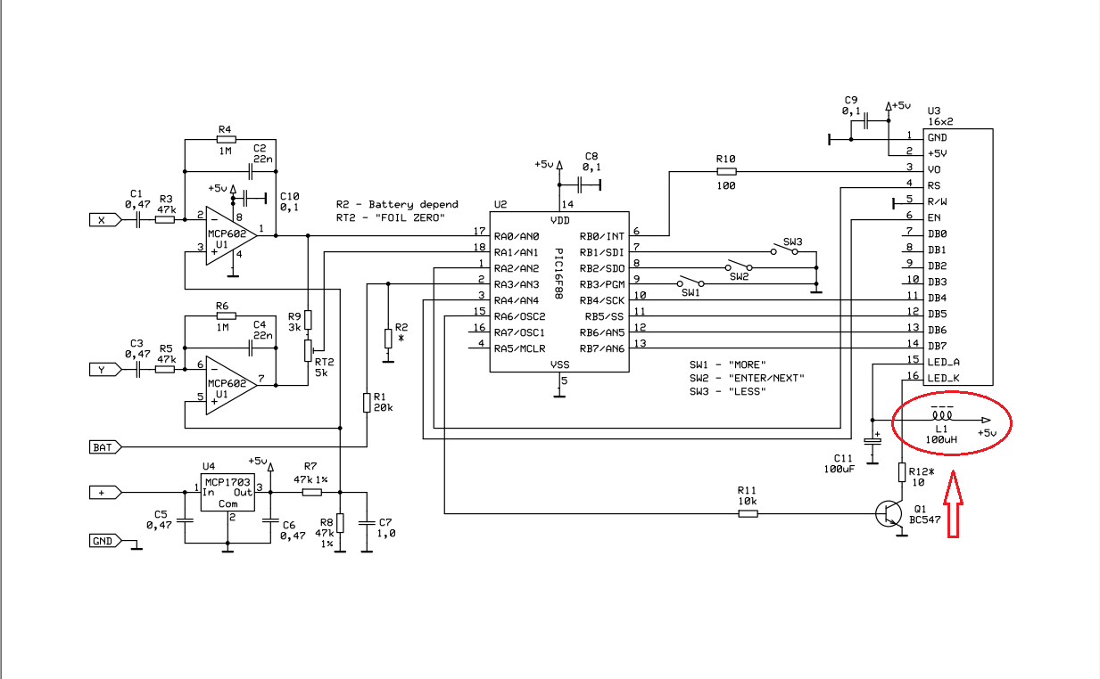

                  • my attempt to make a PCB, still unfinished. sorry for the English http://dropmefiles.com/yJTw8

                      • in schematic have 100uh is that inductor ?

                          • Originally posted by paku View Post
                            Yes, it is inductor and the value is not critical at all. May be 50uH up to 150uH.

                              • Originally posted by Koala View Post
                                Post a picture of what you are looking at. Which schematics are you using. The only inductors on the main board are the TX and RX coils
