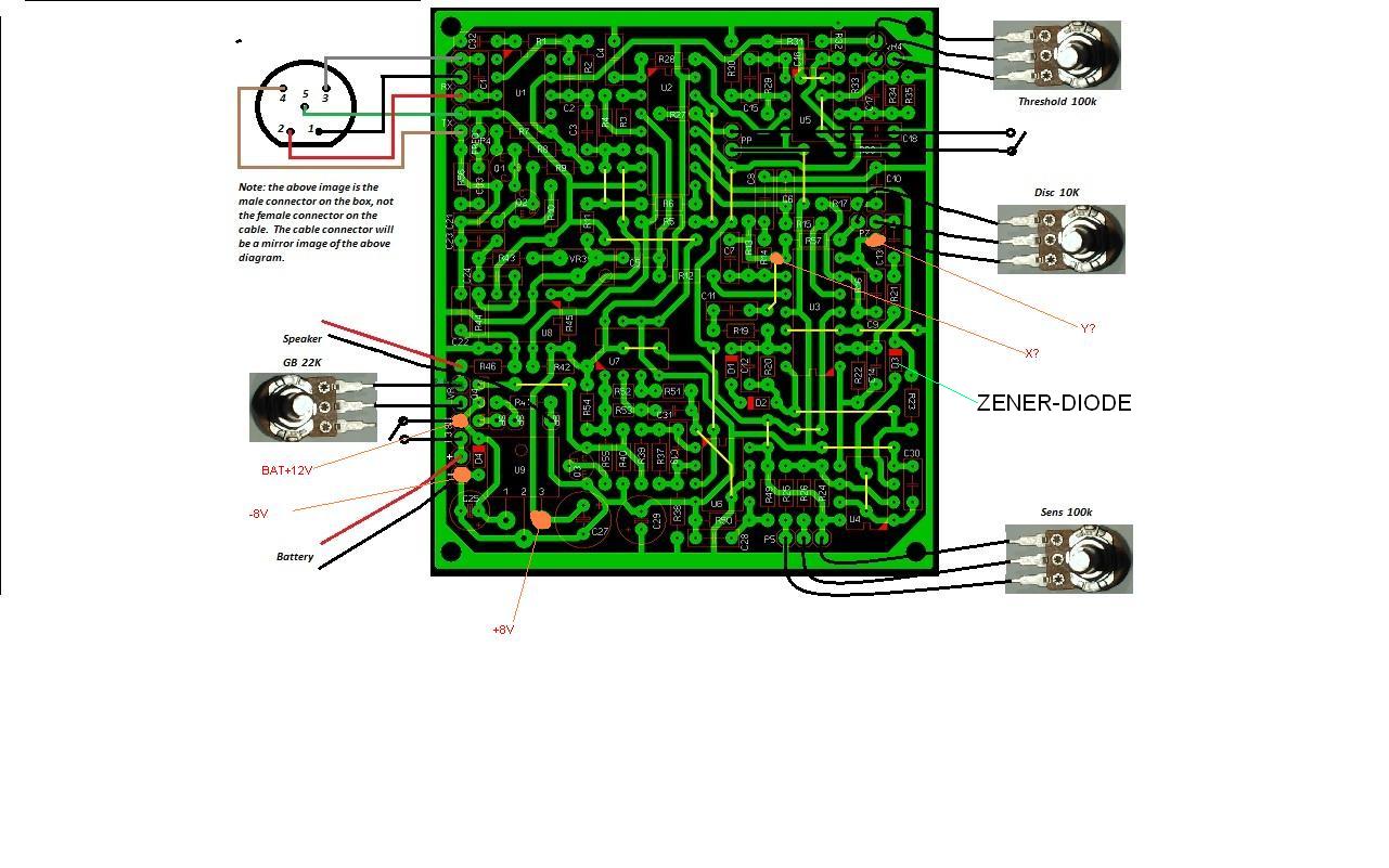

          Since silverdog said maybe no more IDX-PRO stock i have finished my pcb now i want buy components
          but there no BOM available?i made my own but have doubt about some components because missing
          in the schematic or no standard values ..this the questions:
          R57=5.1k and R47-R48=13k no standard values ..what to use?
          R18 missing in the schematic? what value?
          P1-P4-P5-P7 Pot. values?
          C1 missing value?
          C26 missing in the schematic? what value?
          attchmente BOM file if someone want update .thanks

          • Here is a BOM I have used. Maybe it helps you.
            • Originally posted by joop View Post
              Yes ,thanks Joop it help a lot
              • P5 (sens) what value is, 100к / 10к !
                • Originally posted by kalinvd1 View Post
                  look at the msg #1175 Joop pdf BOM list i think is the correct one.
                  • IN PDF sens 10k a , in shem 100k ! In my sens 100k. what is right?

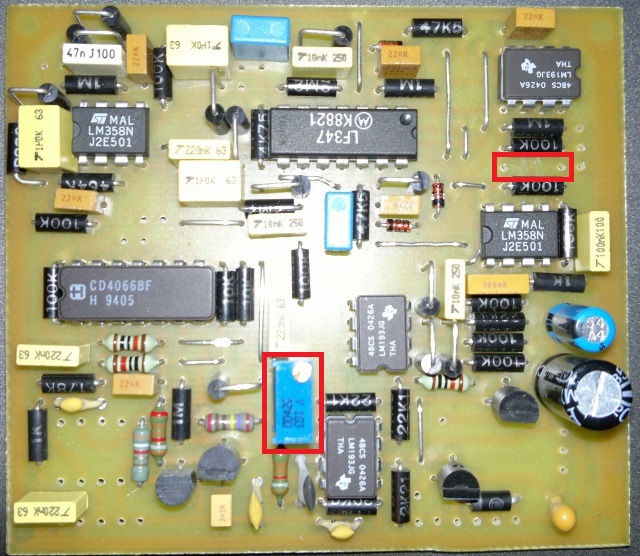

                          • hello, is there a French who made this entire detector and working properly. I would not of my questions. I already made the map and welded components. I crafted a dual head D 27 cm. Now some things I do not really understand.
                            there is a resistor in series with the sensitivity potar rated 100 ohm to 1 kohm what value should I put it?
                            The VR3 potar then I do not know what it is, what value should I set?
                            thank you
                            • Request for clarification
ID:	335287 I would like to know what is the potar box on the photo and what do I put as resistance in series with the potar sensitivity. thank you
                              • Originally posted by ashefr10 View Post
                                See post #178
                                I have used 2k2. If you think gain is to low and your potar is at the end of scale then make it smaller. You will have to experiment
