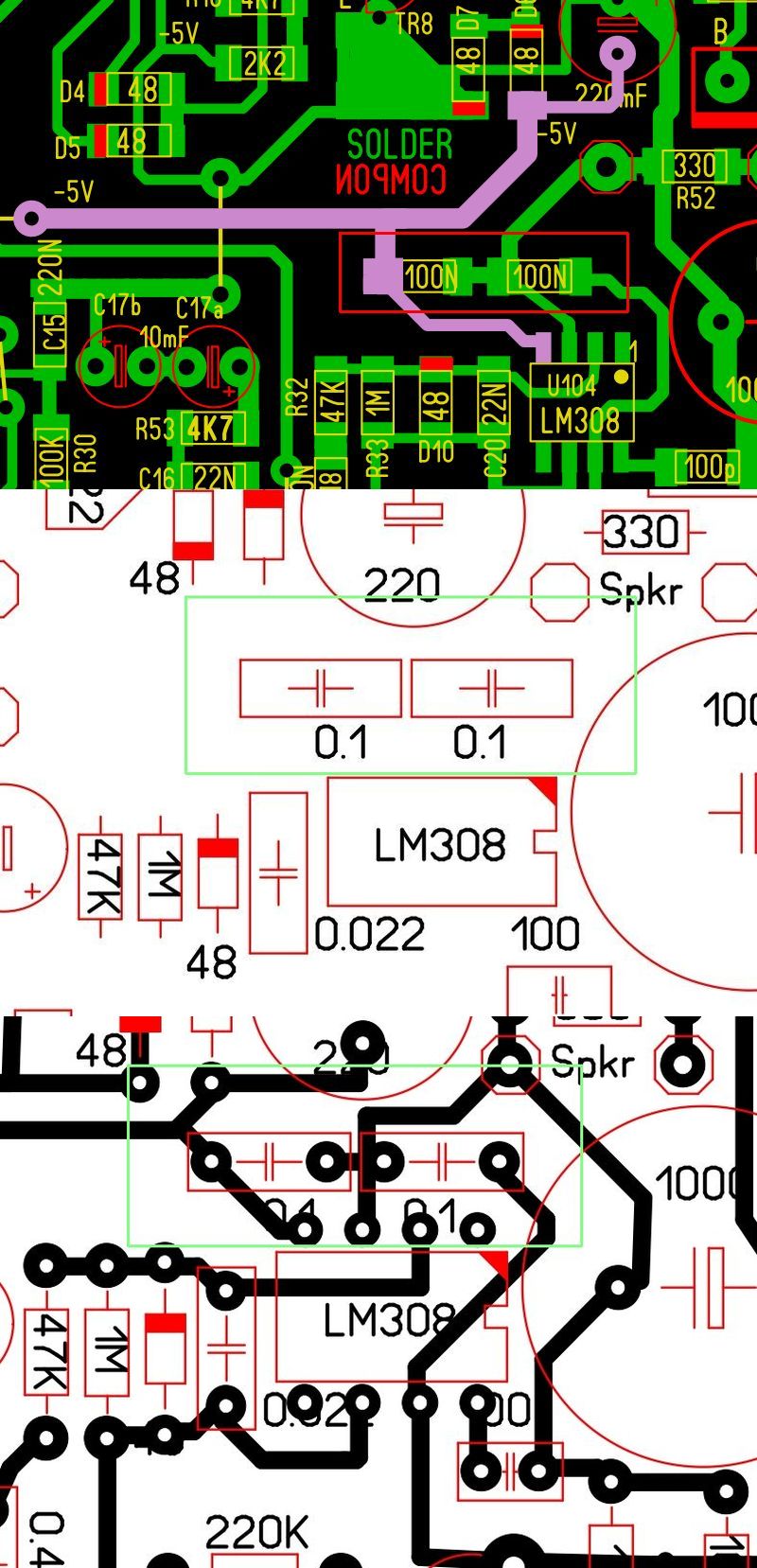

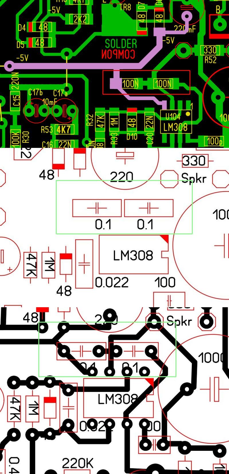

  • I am 98% sure the instant TGSL board is a success after i removed a nano sized short circuit in audio circuit. The heating resistor has also cooled down. I will be 100% sure after i test it with specific coil
    Just worried about those capacitors as to whether they are 100pf or 100nf.....
    • Good job i would er on the side of 100nf if in doubt as it can only improve the smoothing (less noise as the ceramics are inherently so).
      • del, duplicate response
          These are not errors. The component values in the schematic will provide a cutoff frequency for the filter of 15.4Hz. Other combinations of values can be used to give the same result. Please see page 93 of ITMD.
          he must do a detector then he can find up the gold and on the money will buy ITMD. now he does not have the money on ITMD.
          • Originally posted by chuubaba View Post

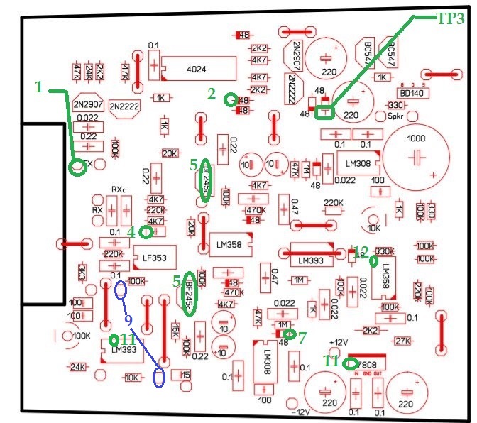

                          • For convenience of novice here i try to highlight few test points according to 101 document
                              [ATTACH]43934[/ATTACH]
                              TP 11, what measures?
                              • It should measure 8V.
