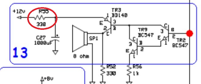

  • kt315 i connected both tx and rx coils with it but i have -6 volts instead of -5 volts. Also my tgsl was making very faint sound but then i tried to resolve the problem of sound and discovered that C1000uf was taking very long to recharge so i disturbed a 330 resistor attached with it and now it is completely silent. i can't discover what is wrong and how to fix it.

    • the 330 resistor in audio driver circuit is very hot and there is no audio at all.
      • Originally posted by chuubaba View Post
        [ATTACH]43689[/ATTACH]
        Fried BD140?

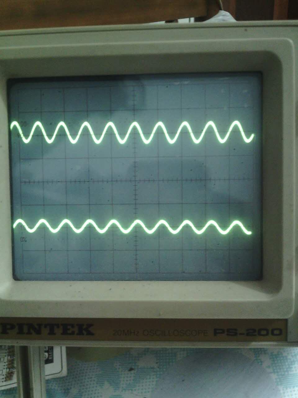

                      • this is how 101.a (pin 7 of lm393 ) translates on scope.
                        Time/ div set at 20uS and Tx 5volts/ div and Rx .1volts/div.
