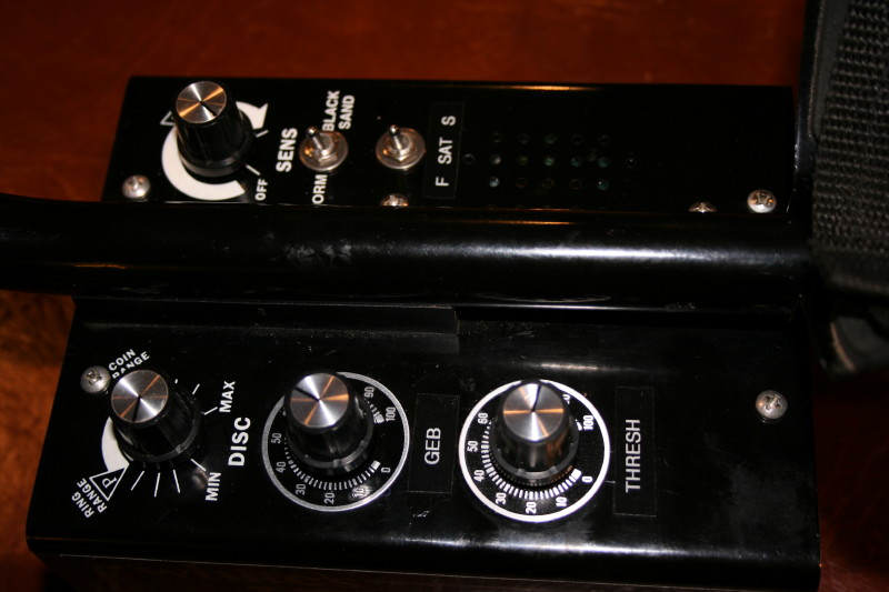

                    IDX Pro Mod
                    The finished control box of my IDX Pro. with "Mr. Bill's" modifications.
                    • TH'r nice work. HH Ron
                      • With the Classic ID,can a pot be installed for a frequency shift.Thanks Ron
                        • Ron, assuming White's used the same basic board as the PRO, just with some goodies left off, it should be easy. Look back at the schematic on post #84. You would need to add R56 and C33 then connect the 1k linear pot to P4. If not, this should still give you an idea of how to do it

                              • i just did the mods to an old square box classic III. the pc board is alot smaller than the newer models but still easy to do. i am really impressed with the improvement, it now has more depth than than my 4900 dl max. on the ground balance i used a double stack 50k and 10k pot for course and fine tune, very easy to ground balance. went with the toggle switch for dual sat. the threashold pot is really worth doing, used a 100k pot with screw slot like on the old garretts. cannot be bumped out of adjustment like a regular knob. set it and forget it. will be adding volume, tone control and dual disc control next. glad i found this forum, lots of great information.
