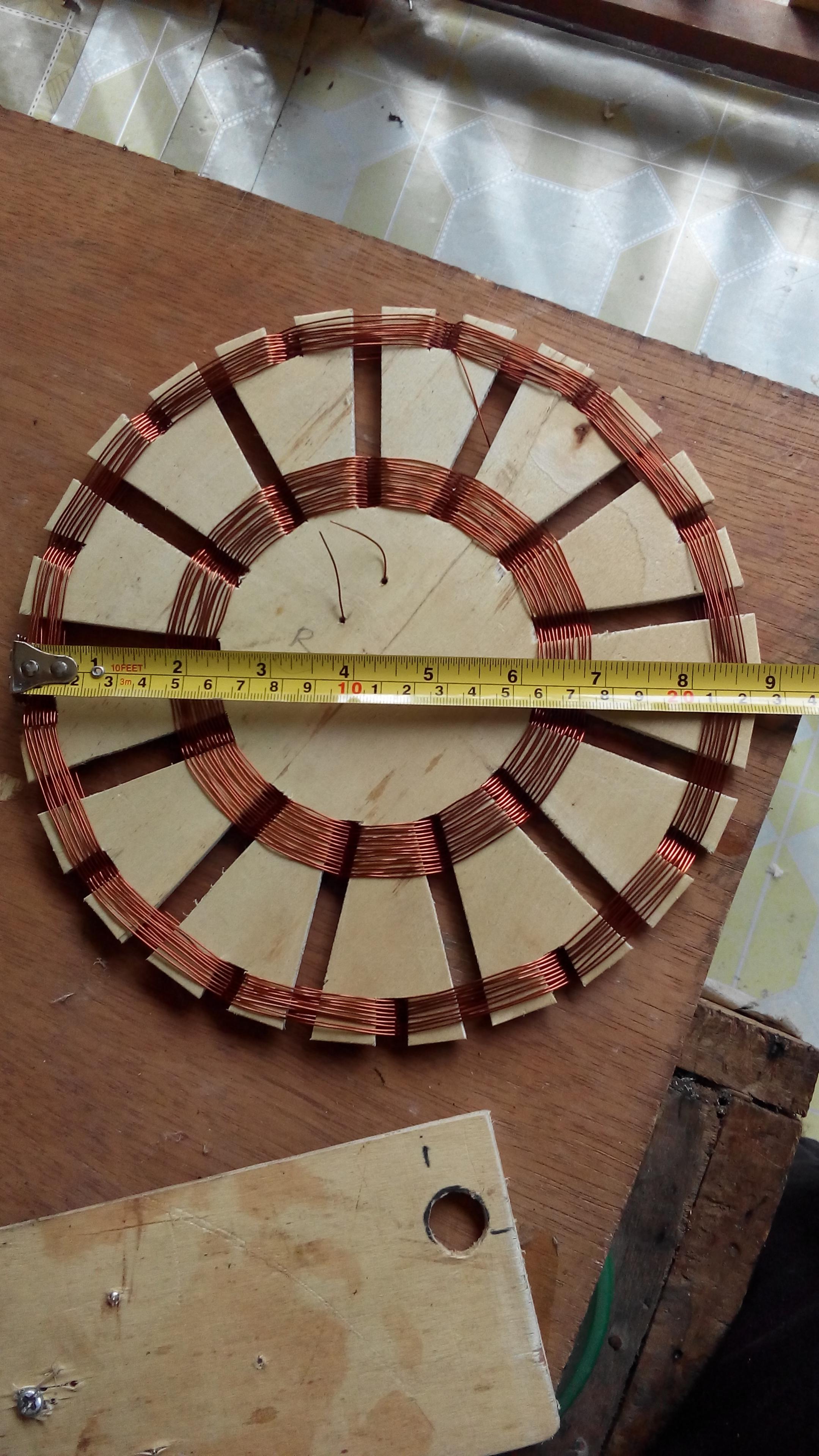

              • I just want to give a tip for anyone having trouble with this machine..if you are using the specified opamp but still you dont get closer to this numbers 300-700-800, and also you cannot have proper discrimination, and poor detection all that problem is 80% because your of your coil.. I had made about 8 kinds of coil of different specs and im lucky atlast at the last one.. I can now properly discriminate, i can now have an excllent detection 6" for a scrap 1n4148 scrap diode with 28cm coil, and i can now hunt to mniralized ground. All of my past coil work best detection in air but failed in real ground but for now i succed. Thanks koohyar for this great machine.
                • Dear jladre
                  Could you please share with us the parameters (wire type; wire diameter; insulation type; number of turns; resistance in ohms; impedance in microHenries; shielded or not shielded, etc.) for the last coil you built that you say was good for discrimination and good on mineralized ground?
                  Also please give us the detection distance (in air) for a 1 Euro coin. Note that a 1 Euro coin is generally used as a reference for comparison in most of the Metal Detecting forums.
                  For example, my Delta pulse 2+ detector that I built more than 3 years ago was able to detect 1 Euro coin (in air) at a distance of 35 cm. This seems to be a 'standard' distance obtained by the 'best' home-made pulse induction detectors such as the Delta Pulse 2+ and some experimenters have reported this same detection distance with the PIM-2 at some other metal detecting forums such as Lugatek, TeknolojiEkibi etc.
                  Good luck...
                  Ciao
                  Speedy_G

                      Hi Speedy_G! My coil is similar for chance pi coil. It is made of copper wire 20awg, 28cm diameter, .7 ohm, 248uH.,can detect 1 euro at 35-38 cm, and scrap 1n4148 diode at 12-15 cm.. Before with my other 7 coil i have diffuculty in miniraluze soil ciz i need to down the sensitivity to 8 or even to 2 but mow i can hunt with 15 and i have also good discrimination. Photo below is not the exact coil but just a similar.

                              • Photo below is not the exact coil but just a similar.
                                jladre In what way is the picture different from your new coil ?
