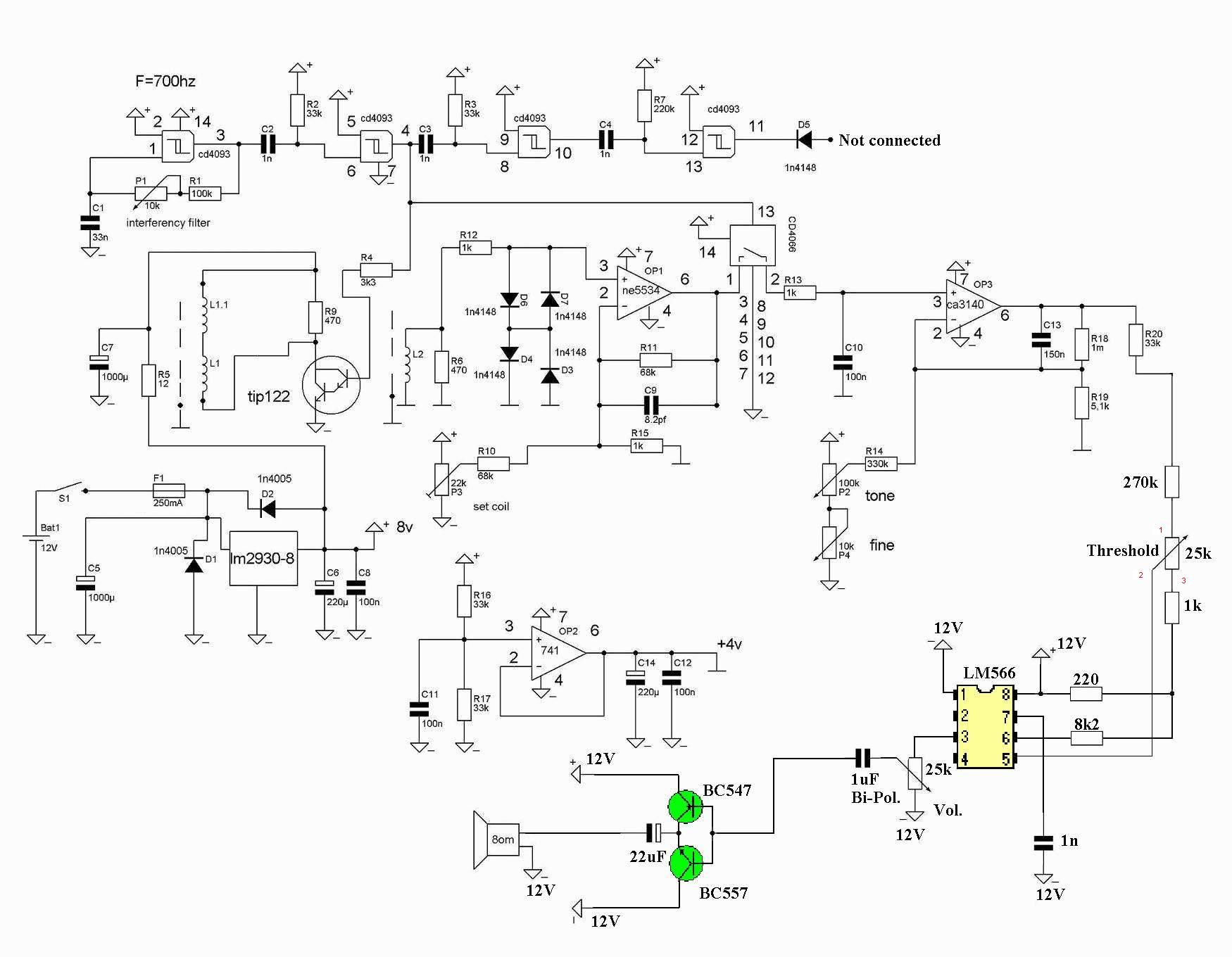

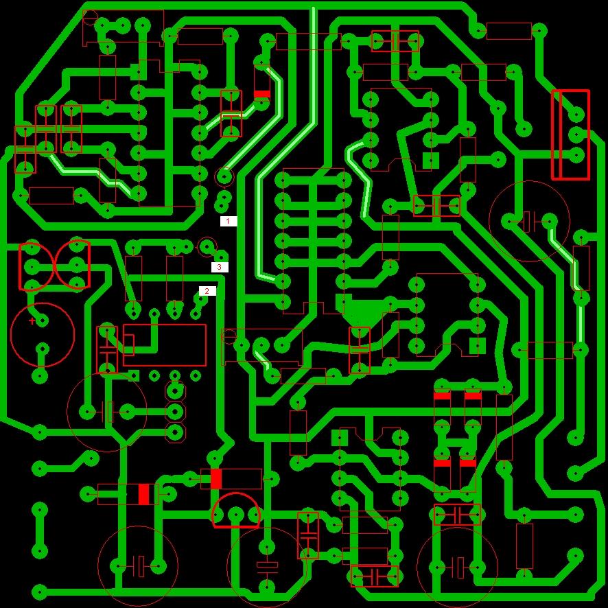

Pulse IB discriminator (by Sasho - Varna)
  • pcb
    Modified for last schematick,audio mod with LM 566...
    • pcb
      p=25 k threshold
      • pcb
        in schematick....
        • Сашо, можно ли вместо CD4066 использовать полевой транзистор
          • Возможно если у полевого транзистора имеется малое напряжения запирания.Нужна другая схема управления затвора
            транзистора u/2=открит и -u закрит.

                    • Hi guys!
                      If someone has tested that device on the field, would share some test results – depth, discrimination and stability? Is this real pulse induction detector with discrimination, or only the name is IB Pulse?
                      … Ivconic, I will be grateful for your opinion also.
                      Regards!
                      • Guys ... is there some test reults?
                        • Interesting solution. Congratulation to sasho Varna. I am afraid of multiple coil solution and still waiting for one coil solution of this schematic.
                          • how mach depth detect pulse ib for a coin in ground and large target??
                            • lm566 Has not found. Than it is possible to substitute? What complete name OP2 741? Thanks for answers.
                              • It is possible to use uA741CN?
