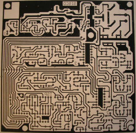

      • I could't find AD797 and OPA37 so change may PCB layout for use NE5534P
        (OR AD844) .I think can use NE5534P (OR AD844) for preamp and first amp
        (before sampler).for after sampler must test between TL0X1 series .
        this is my PCB for test my idea . first I want make this with four CHANNEL ,
        but after try do this saw must use large PCB with near 22 ICs , so for first
        step design this PCB with two CHANNEL for test.
        forget told , for power part use GOLDSCAN 4 power unit . I think better than
        ICL7660 , because must supply for near 11 ICs.(9 OP-AMP + 2 4051)
        this power unit enough or not ?

          depends which op. amps. but if you look at GS4 schematic there are TL074 etc powered that way, so I think it could be ok for 9 single op. amp. and 2 cmos.
          NE5534 need more current than others TL0x1 but is just one, so it's ok.

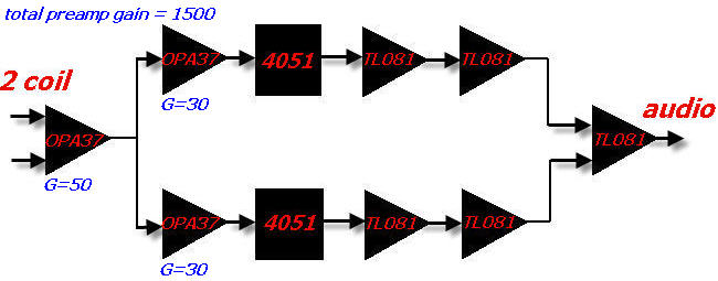

                  • tomorrow I will be start build my new PI with this parameters .
                    about preamp GAIN , as yet not decide .
                    i think for total gain , 1500 is good , but how must Apportion between two part
                    of preamp , i don't know. (50 - 30 or 60 - 25 or 30 - 50 .....?)
                    • Originally posted by sisco View Post
                      in your circuit change few ! Cause you use always OPA37 there.
                      Same noise level, same offset etc...
                      In older designs the preamp. must give a small amplification cause of noise and offset higher than you have with OPA37.
                      But is always a good idea for me. I'll use 30-50 -> 1500.
                      Using small 1st preamp. amplification is good, always, cause that way you minimize impact of e.g. offset due to gain before further amplification.
                      Best regards,
                      Max

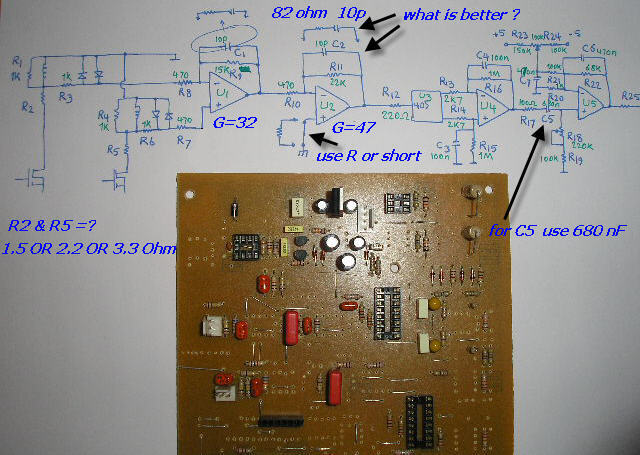

                      • Hi Max
                        my PCB is ready but parts is not complete Assembly.
                        see schematic and tell , my part value is good or must change ?
                        please see OPA37 datasheet and tell me C1 value is good or must use 5pf
                        capacitor or not or better replace with capacitor + resistor(serial) ?

                            • about C1 how ? this is determinable with frequency operation (i do't think)
                              or OP-AMP parameters ?
                              about total gain , OK I reduce amp1 and amp2 gain to 10,000.
                              but how must Apportion between amp1 and amp2 ? you told 100 x 100
                              can like preamp1 and preamp2 for amp1 gain more than amp2 for example
                              50 x 200 or 200 x 50 or really not difference ?
                              amp2 after couple C (C5) so must use gain more than amp1 or not?
                                C1 is needed to eliminate the pole due to Rf and Cin... feedback resistor and input capacitance.
                                This Rf+C1 effect cause your preamp will act like 1st order low pass filter with frequency -3db depending on C1 and Rf values.
                                A small vaue is needed to prevent the pole action give you self-oscillations and to not introduce a cutting-edge at few Khz from filter effect.
                                I've not done all calculations but can suggest you use 22pF with your setup.
