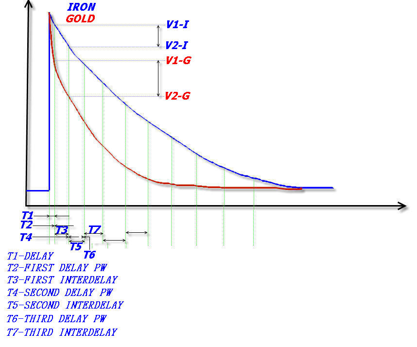

      after test many timing , I find these good timing for detect :
      1-IRON (not gold...)
      2-ALL METAL (GOLD+SILVER+IRON+...)
      3-ONLY GOLD
      if use IRON.HEX you can detect all metal without gold.
      if use ALLMETAL.HEX can detect all metal.
      if use GOLD.HEX you can detect ONLY GOLD.
      I try write a program can use selector key for choice IRON,ALL,GOLD.
      and other program automatic change delays and DISC your object.
      DON'T HURRY , STEP BY STEP

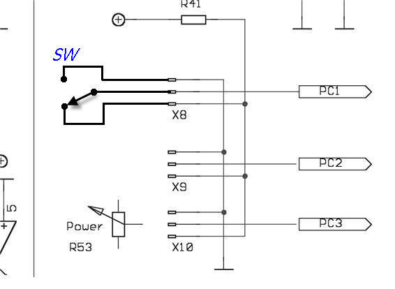

        • #79
          Only replace R52 with key and programming your minipuls-3 ATMEGA8 with
          this HEX file and select between 16 difference choice for best detection .
          but must know with this software only can use small coil and with large coil
          don't answer.
          be successful

                  • #84
                    Geo , I test your suggest.
                    use 50Hz with 1000us PW and :
                    with large coil : work better about distance for big object near 25%
                    with small coil : work better about distance for small object near 10%
                    THIS PROJECT FOR TEST TIMING IS BEST PROJECT
                    BECAUSE YOU CAN TEST YOUR IDEA ONLY IN 2 MINUTE WITHOUT CHANGE
                    ANYTHING IN CIRCUIT.ONLY MUST CHANGE SIX NUMBER AND REPROGRAMM
                    YOUR MICROCONTROLLER.
                    (1-ON PW,2-DELAY,3-FIRST PW DELAY,4-INTERDELAY,5-SECOND PW DELAY,6-OFF PW)

                          • #88
                            Max , you think this idea is true or not ?
                            I think maybe can use test point more than 2 location for example 8 location
                            and test amplifier output voltage and with compare between this difference
                            voltage understand this object is what metal .
                            I try do this but can't , because internal micro A/D burn 65us-250us for
                            every convertion and this time is very high so must use external A/D
                            converter with high speed.
                            can do other way for understand about disc?
                            THIS CHART ONLY FOR EXAMPLE.
