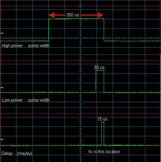

        I dont know where must test delay pulse .
        for delay I test in pin13 Atmega8 .
        I adjust all potentiometer but this signall fix in this location and
        don't moved.
        Is this delay signall?
        (This metaldetector work fix 500Hz)

          Hi Sisco,
          don't understand your diagram.
          First delay start from main pulse (tx) switch-off ahead. I read that this detector (on pulsdetektor website) have 150uS first delay ... so you have to see a 150uS pulse (positive or negative) that start just at tx switch-off.
          Then after 1st delay pulse you have to see "first sample window", another pulse that goes to sampling gates (usually from 15uS to 50uS of duty).

            maybe first delay adjust into atmega8 by software.
            if you read minipule detail (on pulsdetektor website) can tell me RANGE
            potentiometer for what ?

              Hi Sisco,
              I've not read all but just the spec. sheet on their website. I think that timing for first delay is set in atmega8 software.
              Have you just .HEX file ? Not the assembly code ?
              Cause if you have assembly code you could change it in software... then reprogramming the ATMEGA8.
              Another solution (but ugly) could be disconnecting that pin and using a monostable (4538, 74121, 74123, 74HC121... ) to get right pulse duty (smaller than 150uS)... triggering the monostable with TX main pulse at gate of mosfet, like in detectors without MCU (atmega).

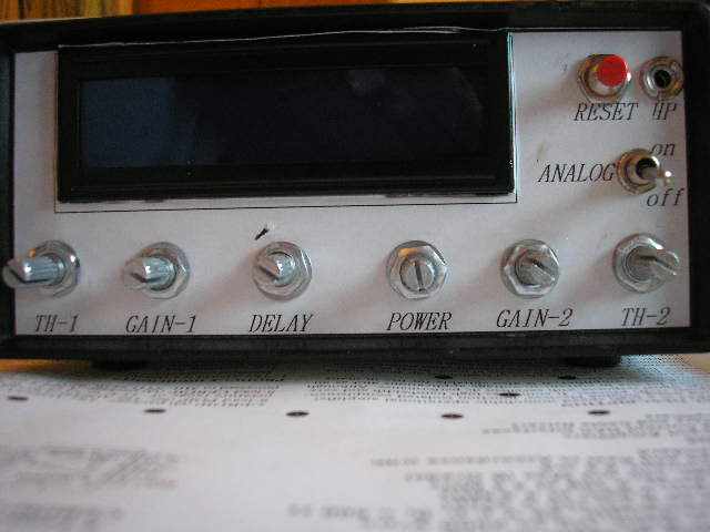

                              this is my new project (finally ready after 5 days), digital metal detector with
                              DELAY adjustment , I want test this tomorrow (must buy
                              microcontroller), if work good (I hope) send schematic for friends .
                              can I know anybody make minipuls or not ?
