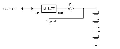

          Hi Sisco,
          20hours means that you have to apply a slow charging strategy to avoid battery damages, not 220mA for 20hours: that way you will damage the battery.
          (well depends... sometimes hours indicate the suggested maximum discharge rate:
          2.2/20 = 110ma maximum... but don't belive it... I have some similar and dicharge happens also at 400mA and with no damages)
          If is a common gel lead-acid battery like you can find e.g. in UPS of computers...etc you can charge in 12 hours safely.
          You need a current limiter like the one in the picture and a 13.8 v power supply (1ampere or more max current).
          Battery must be discharged first for at least 80%... so you have to read e.g. 11.8 or less volts.
          Ok, current limit 2.2A/12 = 185mA (about)
          Now say that you'll lost 3% due to internal leakage (often is 5%)
          add it 185 *0.03 = 5.5 mA
          Ok you need 190mA limit
          Your R would be 1.25/0.19 = 6.58 ohm
          You can use 4 resistors of 27ohm in parallel to get (about) the right value or others to suit better.
          You need 1W for it so use e.g. 4 * 1/4W resistances.
          LM317 need a small heatsink... cause initial charge is heavy and have to dissipate some heat.
          So put the 13.8 volt supply on ,connect the battery and leave on charge overnight (12H).
          That's all.
          Best regards,
          Max

            Hi Max,
            What's 1.25?
            My battery is 12V 1.3A lead acid... What number must I use to calculate the R?
            I calculated by 1.25... R should be about 11ohms...
            Thanks in advance,
            1843

              Why more than 10 hours?
              The reason NiCad batteries are charged an extra 20% is for two reasons: First you cannot expect to achieve 100% charging efficiency so you must provide more than the exact calculated amount of charge to take care of losses. The charging efficiency will depend on the condition of the battery and how many times it has been cycled, as well as the temperature of the battery.
              The second reason why NiCads are charged more than 100% is because there is an easy method to electronically detect when the cells have reached full charge. There will be a battery voltage peak that occurs approximately at 120% of the rated charge. When this peak voltage is reached, then continued charging will result in a slight drop in voltage. Some automatic battery chargers take advantage of sensing this voltage peak in order to switch the charger from charge mode to trickle mode.

                  So, my first calculate is true , must charge 1/10 battery current for 12H .
                  (Rx=1230/(1/10 battery current) for 12H)
                  1843 , this is mean you must use Rx = 1230 / 130 = 9.5 ohm for your battery.

                        • #57
                          Hi Max,
                          What's 1.25?
                          Thanks in advance,
                          1843
                          1.25 is the internal reference voltage of LM317.
                          The limit is set at about 1/12 of capacity to preserve battery integrity.
                          With gel type you could use also e.g. 0.5 ampere as max limit for 1.3AH... but then you could damage your battery.
                          H2 gas bubbles pressure can break easy the container... though there is always a valve there... then break the plastic (battery explode).
                          Best regards,
                          Max

                              Hi JP,
                              NiCd and NiMh are another topic. We were talking about gel-type lead-acid batteries.... the kind used in UPS.
                              The formation of H2 during charge is the big problem there... there is a valve that opens automatically when pressure rise over a fixed limit. The valve is hidden under the contact plastic cover. Sometimes the rapid release of bubbles and the wrong behaviour of the valve cause that batteries explode.
                              This happens frequently when charge current rise over 1/4 of nominal capacity, due to the huge gas bubble formation in the time unit.
                              Other gel-type have adsorbent medium to trap H2, like in other kind of batteries... but this normally for smaller current capacity (under 1Ah) like some digital camera batteries.
                              Manifacturers always reccomend slow charge rates or very small trickle charghing for in-line UPS and the like.
                              12h is a good timing for overnight chargers... nothing bad if you charge in 10 or 14 hours... same thing.
                              Problems arise when one use "fast charge" e.g. 1/4 capacity... then could damage battery, batteries could explode...etc.
                              Charge is almost always at fixed voltage on lead-acid batteries, but current limiter is required to avoid above problems.
                              Kind regards,
                              Max
