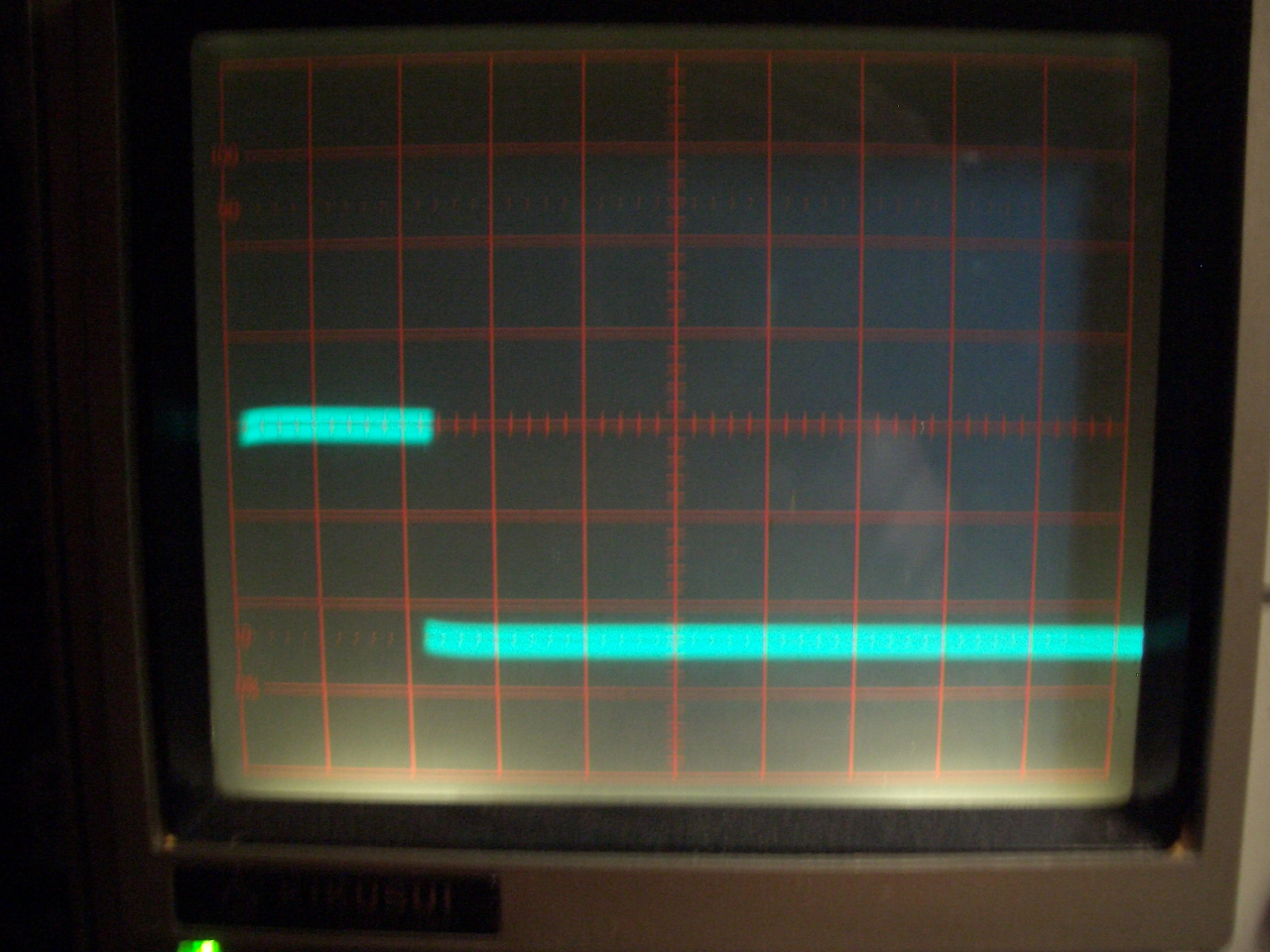

              Yes pin 2 and 4. Regards the noise with cable movement, I don't know for sure but it looks like your sampling circuit is not working correctly.We will try to troubleshoot this when we get your scope working.
              • heres the 40106 scope pic pin 2 and 4
                here Click image for larger version
Name:	40106 CH1 pin 2 CH2 pin 4.jpg
                • 40106 pin2 and pin4 is same - 45us has to be Click image for larger version
                  • kt315 yer they are the same no matter the position of the delay trim it does not change only the amplitude

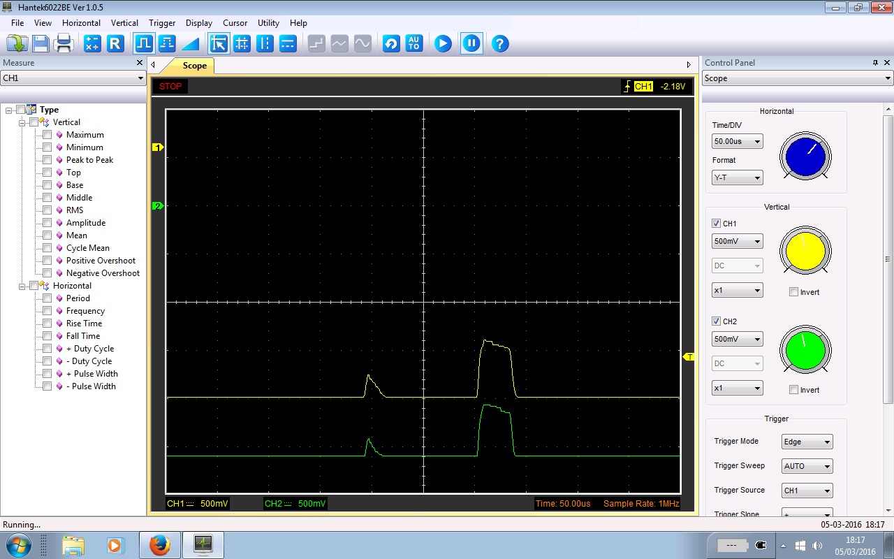

                    • Impulse see you got your PC fixed. Good job. As KT 315 says these signals appear to be the same, pin 4 should be significantly delayed relative to pin 2. The pulses should also be about 4V high and 45 uS wide. See post 205. Your signals just show the spurious response which is apparently (but not desirable) for a Barracuda. See the first two pics for what it should look like.mthe pic delay -near- minimum shows what you have which is wrong. I would do two things
                      1. Look at post 210 and very carefully compare you board to the pics Ray so kindly provide. If you do not see any differences do 2.
                      2. Cut the link across the external delay pot connections and install a 10K ohm fixed resistor.
                      The
                      There is something wrong with this sample pulse generator and unless it is working correctly the detector wil work very poorly or not at all. Until we get this fixed we can not proceed. It is my hope this is the last remaining problem. The rest is just tweaks
                      BTW I forget can you get you old board to work? Also can you send a 5534 pin 6 trace of you new board with the shorter cable?
                      • Originally posted by Impulse View Post
                        you do not have a delay making by C4 R17 (U4 12-13pins). bad you do not see that.

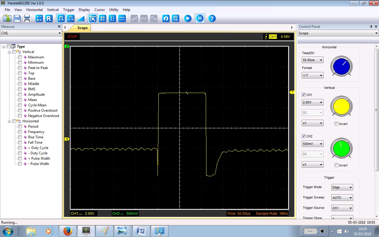

                        • 5534 pin6 Click image for larger version
                            a delay making? next to cap 4 and resistor 17? what am i not seing?
