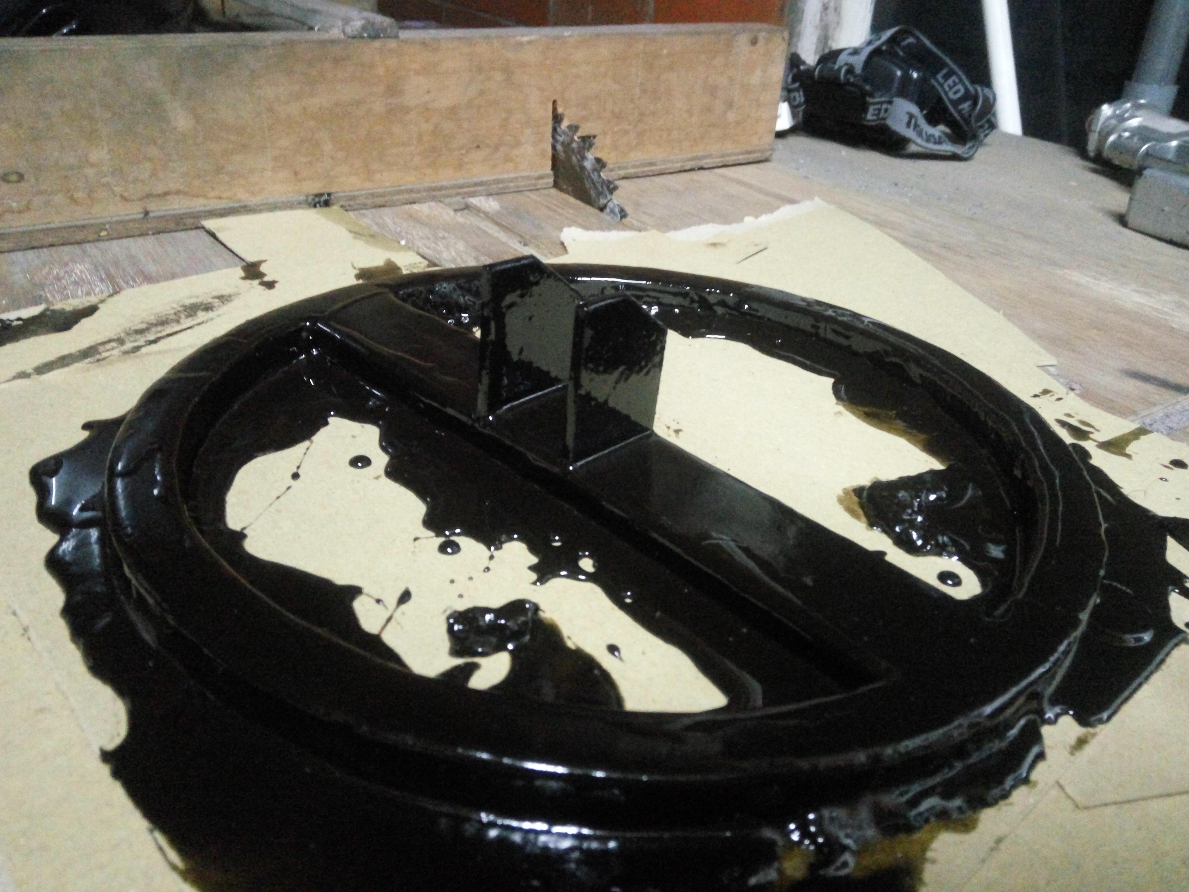

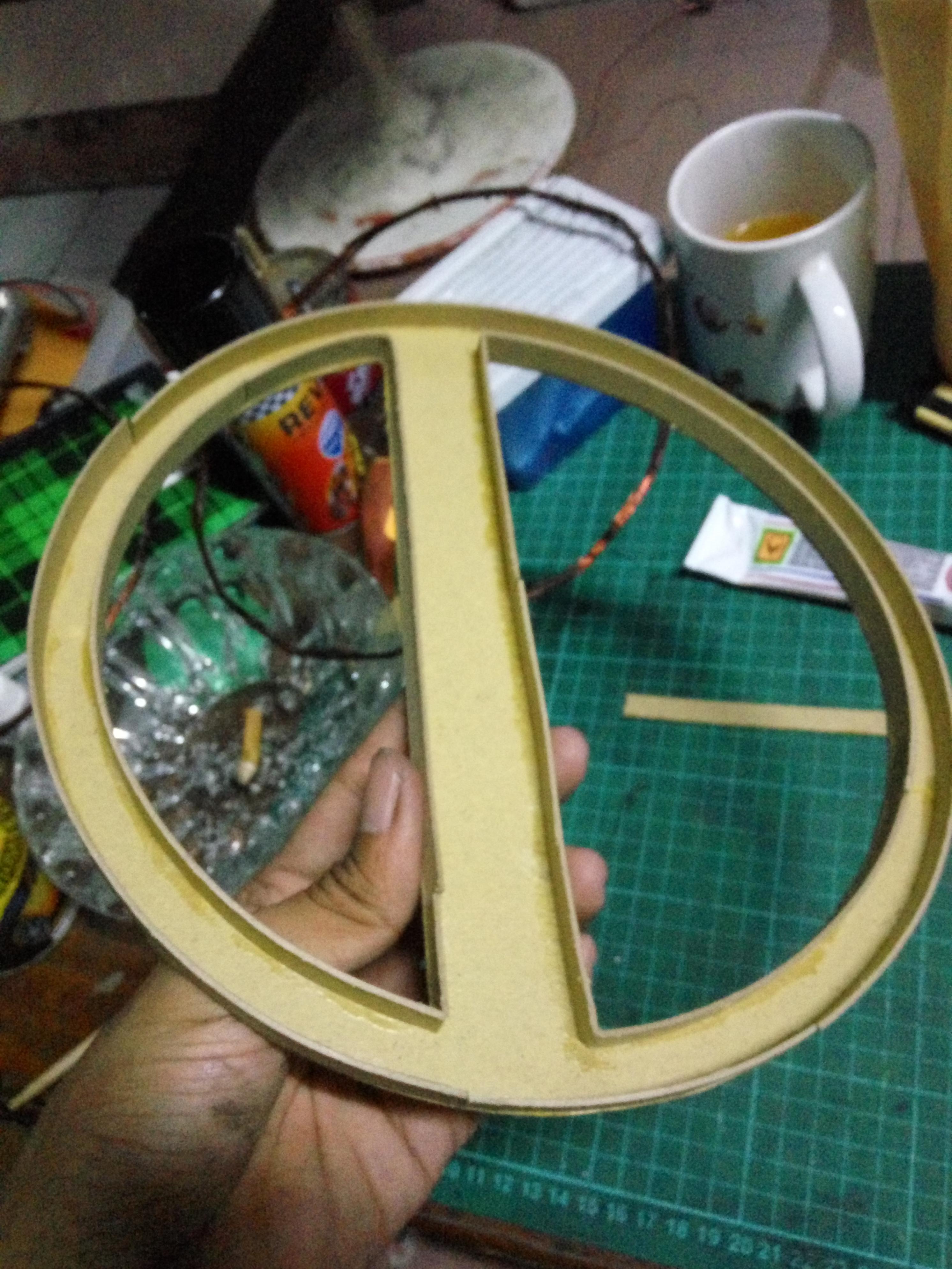

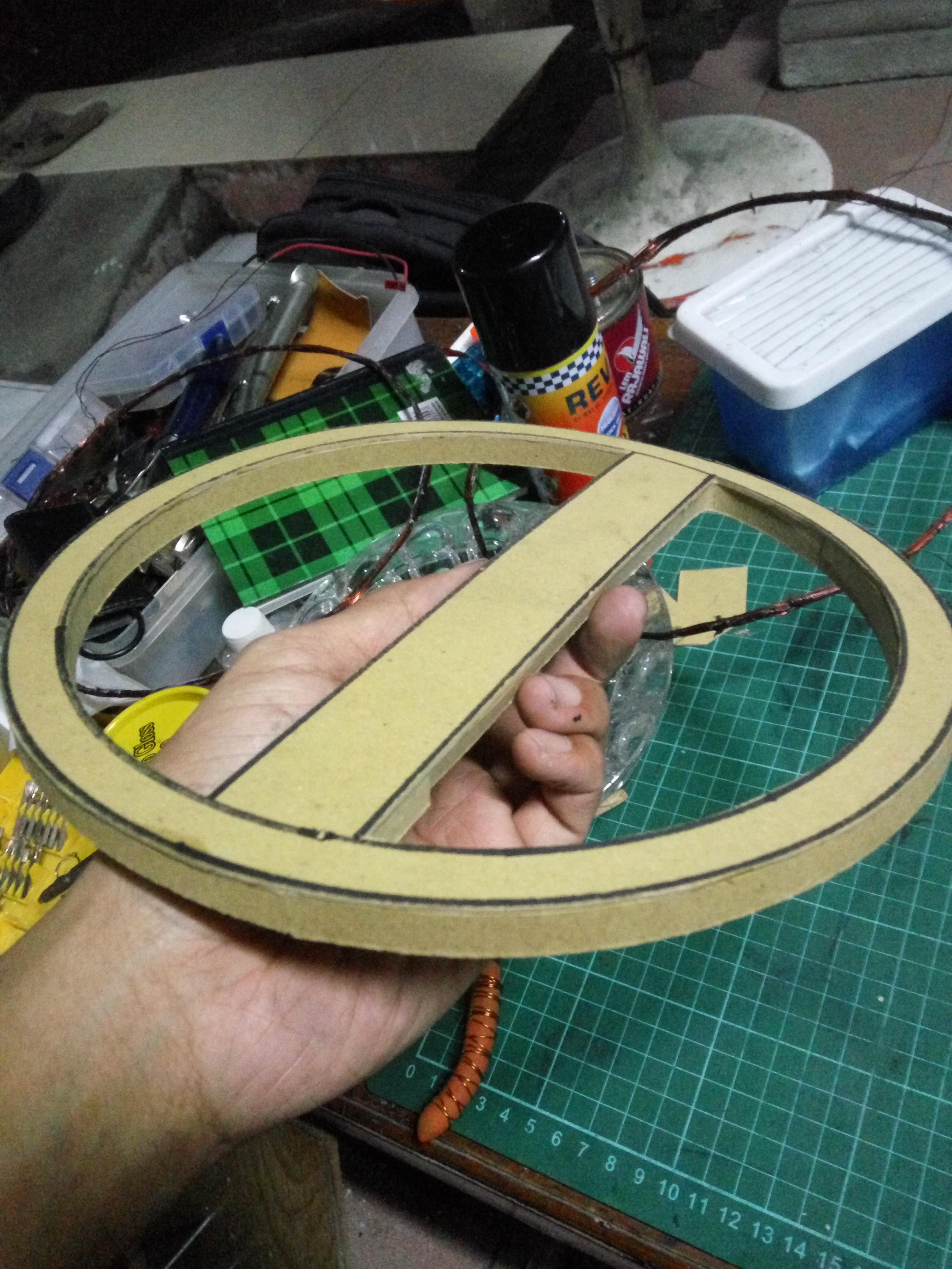

  • Its disolve.... even when coating with based water edge paint, doesnt have a jigsaw machine, only a table saw.
    Let me try with thick 3mm paper
    • Polyester resin and super glue will dissolves polystyrene foam. Epoxy resin is fine with any foam.
      The brown urethane foam is the only one I know that will work with polyester resin.
      I have seen a blog of someone using polyester resin and polystyrene foam they sealed it with PVA glue first. Not tried it myself.
      • I think this will work.

        • Mehh.... to much catalist, 10 minutes already hard

          • Looks good ripsdevala. A very professional job.
            Thanks Koala, good to know.
            My early plywood coils I set the windings with PVA glue. It worked ok, but took a while to dry, and you will make no sense of the detector while it's wet.
            My melamine plate for a Tuggle coil split in half the first time I put the hacksaw to it. Next I will try with pvc-should work.
            Also going to try a spiderweb coil former made of stiff cardboard......
            Another thought is a Tuggle style from 12mm ply, with a groove cut around, then slotted, with wire interwoven on 1 face 5.5mm(6mm less 1/2 hacksaw blade width).

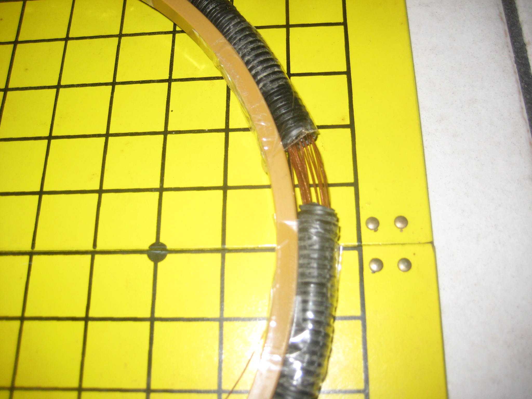

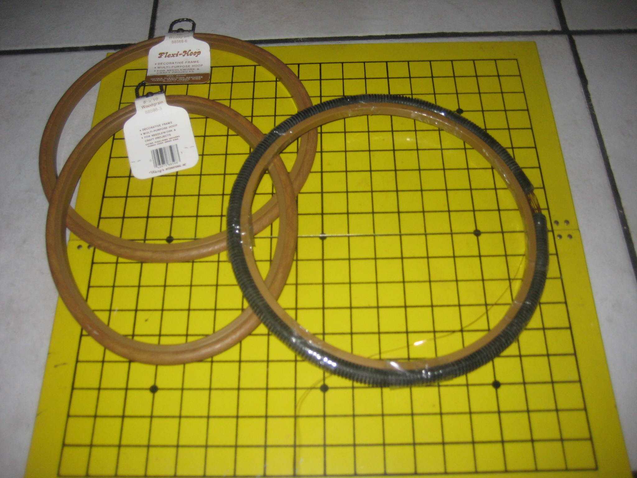

              • Ya Materials is a big issue. I used super glue to bond a coil and it melted the coating and the coil shorted out!
                It seems to take at lease 6 months for an epoxied coil to settle down to a stable state.
                I filled one coil with epoxy and it's too heavy!
                This is my latest attempt at a coil for Pickini. I'm not sure what to fill it with to keep the windings from moving
                but not make it too heavy or slow?
                I used a knitting hoop with a wire loom hose to make a small light hoop setup...

                • How about hot glue? Put some hot glue and heat it with hot gun, that what i will do next.
