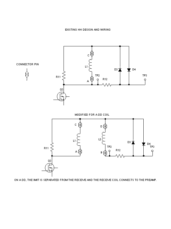

                  But you can convert any PI to take a DD coil easily. Apparently there is no advantage to this, but my Surfpro board came as a DD, so I set it up that way, and the 10x5ML commander on it far exceeds any other coil. Perhaps it would also be interesting to make/test a concentric in this fashion too?

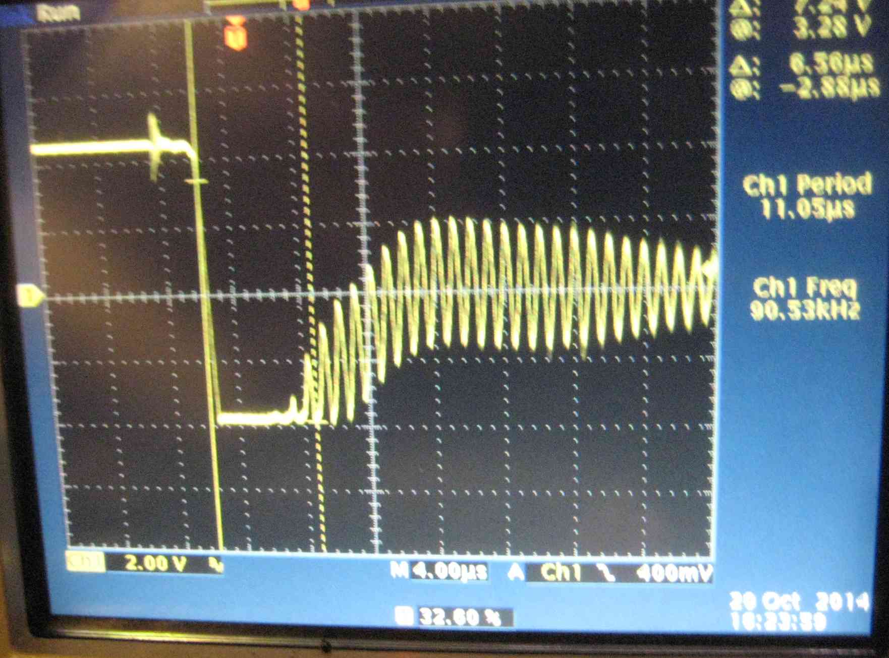

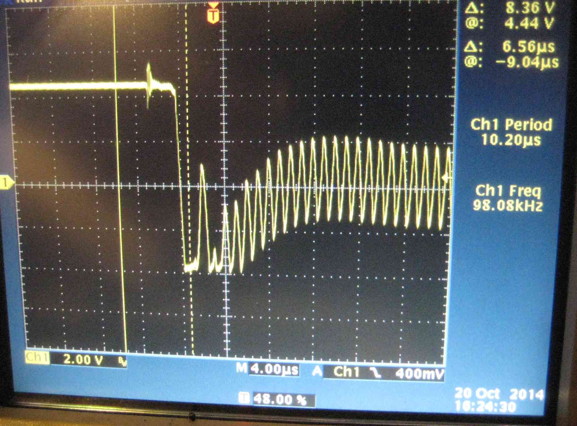

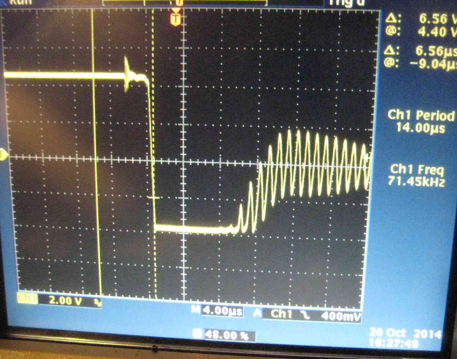

                  • I built a DD but could not get the damping right. It see's the other coil or something;

                        I used 450uH which is the same as the original. Anywhere around that inductance and there is no need to tweak the damping resistor.

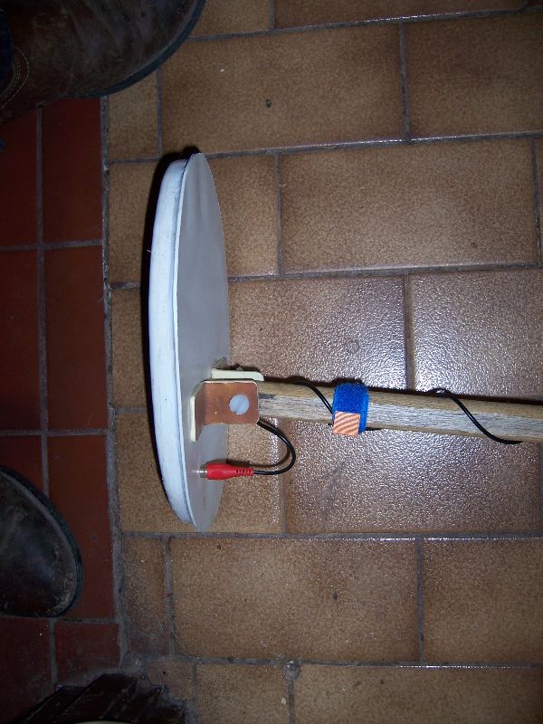

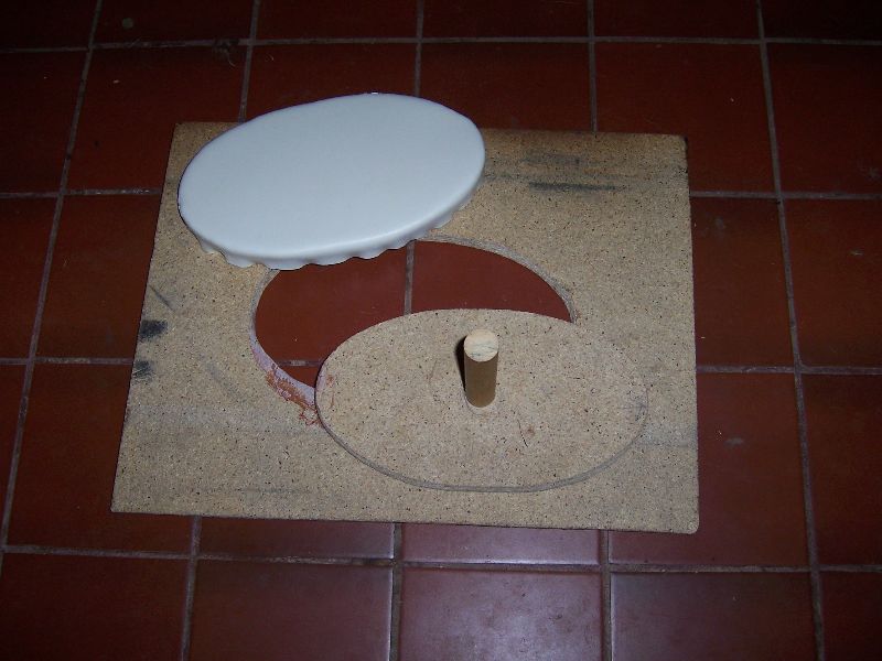

                              I use 100mm pvc stormwater pipe. Cut to length, cut down middle. Heat in oven at 180C, press flat, cut to 3/4 inch larger than mold, then press into mold. Trim edges with tin snips. Expanded packaging foam sheets for filler, and then glue/clamp top on with white silicone. Easiest to trim top to size after silicone has set for 2-7 days. Ears are epoxy glued.
