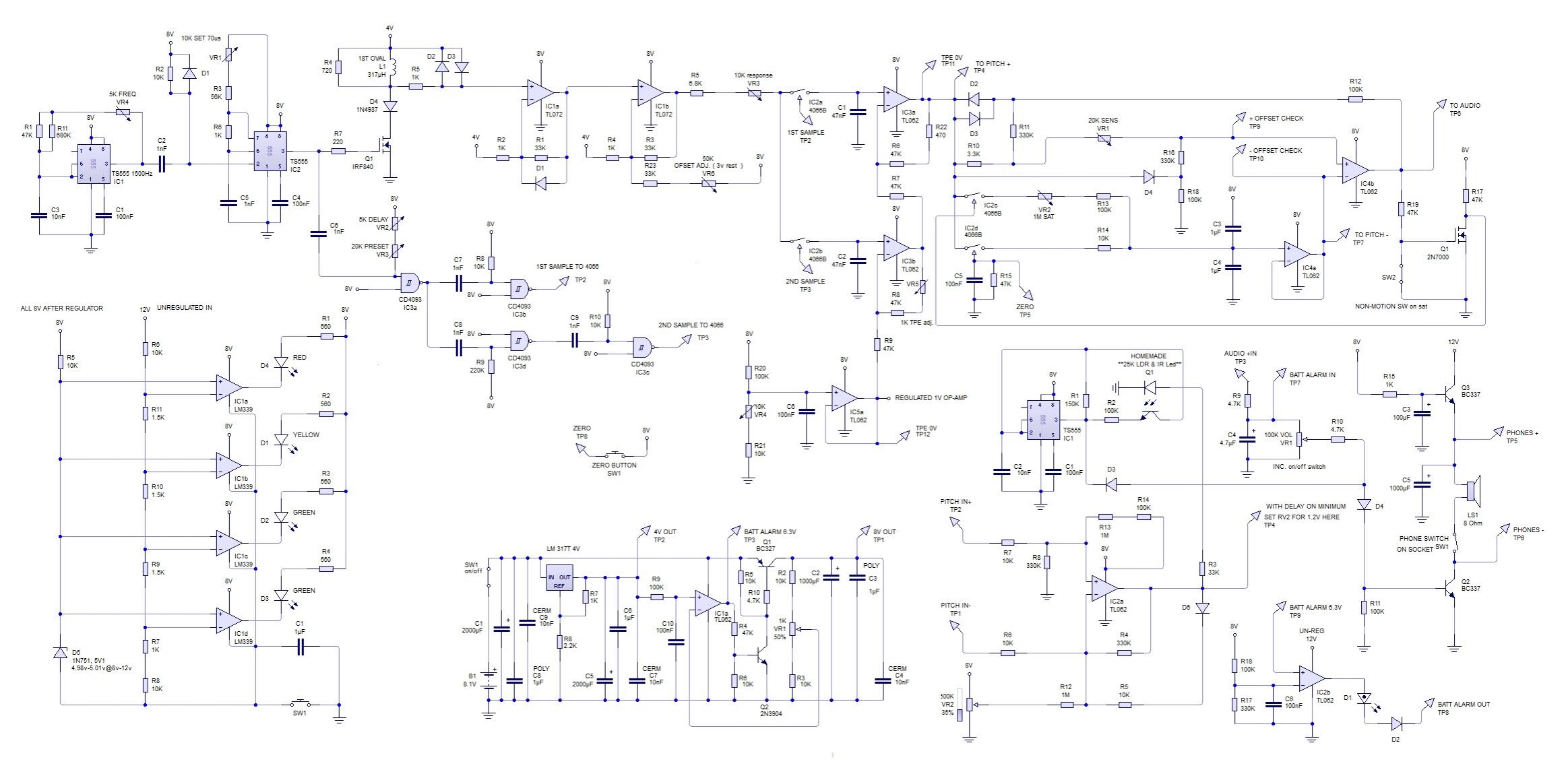

      Like this? Click image for larger version

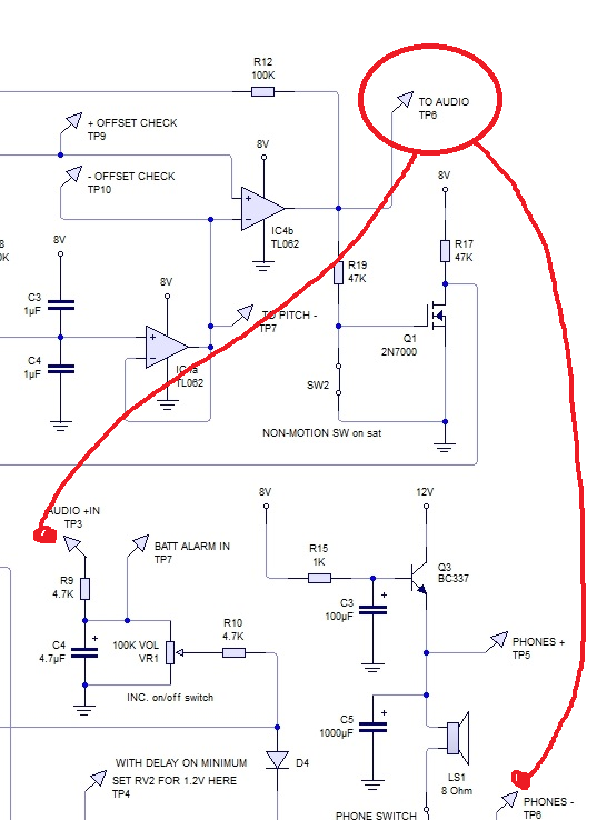

      I have a question, Click image for larger version
      • #48
        hello eclipse,
        regarding R1 and R3,
        gain on the pre-amps is 33 x 33 = x 1089 which is comparable to the "usual" 1k / 1M (x1000)
        well,
        actually non-inv amp is 33(+1) x 33(+1) = x1156,
        or there abouts.........
        anyways,
        think the pre-amps are doing the usual x,
        but I know what you mean,
        the whole detector hasn't very much gain, compared to the likes of HH and surf.
        and is quite reliant on the "last" opamp being used as a comparator for detection sensitivity.
        looking at it,
        poss the best place to put another amp would to cut between the 470 ohm and
        and TP4 and add an amp in there...........
        THOMAS !!!
        absolute genius !!!
        aww,
        thankyou very much !!!
        I messed around for ages trying to do that.
        got all sections on the same sheet in the program I was using,
        but then couldn't lift it off in one piece to a JPG.
        ah,
        I see the bits you've circled and can guess your question........
        "phones -" TP6 ONLY goes to your headphones minus,
        "phones +" TP5 goes to headphones plus.
        but yes,
        audio+in TP3 connects to "to audio" TP6 ONLY.

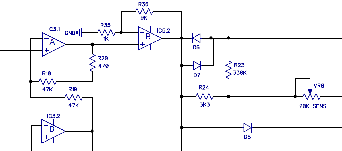

          HI DOOLEY, you mean something like this?
          This should amplify the signal x10 further more, not sure
          if this is conservative number and will it work but reading your upper post you mention other schematics use x200... x470 amplification there
          • #50
            thanks Dooley, you read my mind. The TP6 had me wondering.

              hello eclipse,
              yes,
              just like that would work,
              an extra amp in there would increase the overall gain,
              and would poss make it more sensitive,
              not sure weather or not it would make it better though,
              as the final stage is an opamp comparator stage.............
              may make it a bit chattery,
              not sure.
              could always try,
              may make targets on the fringe of detection more definite.

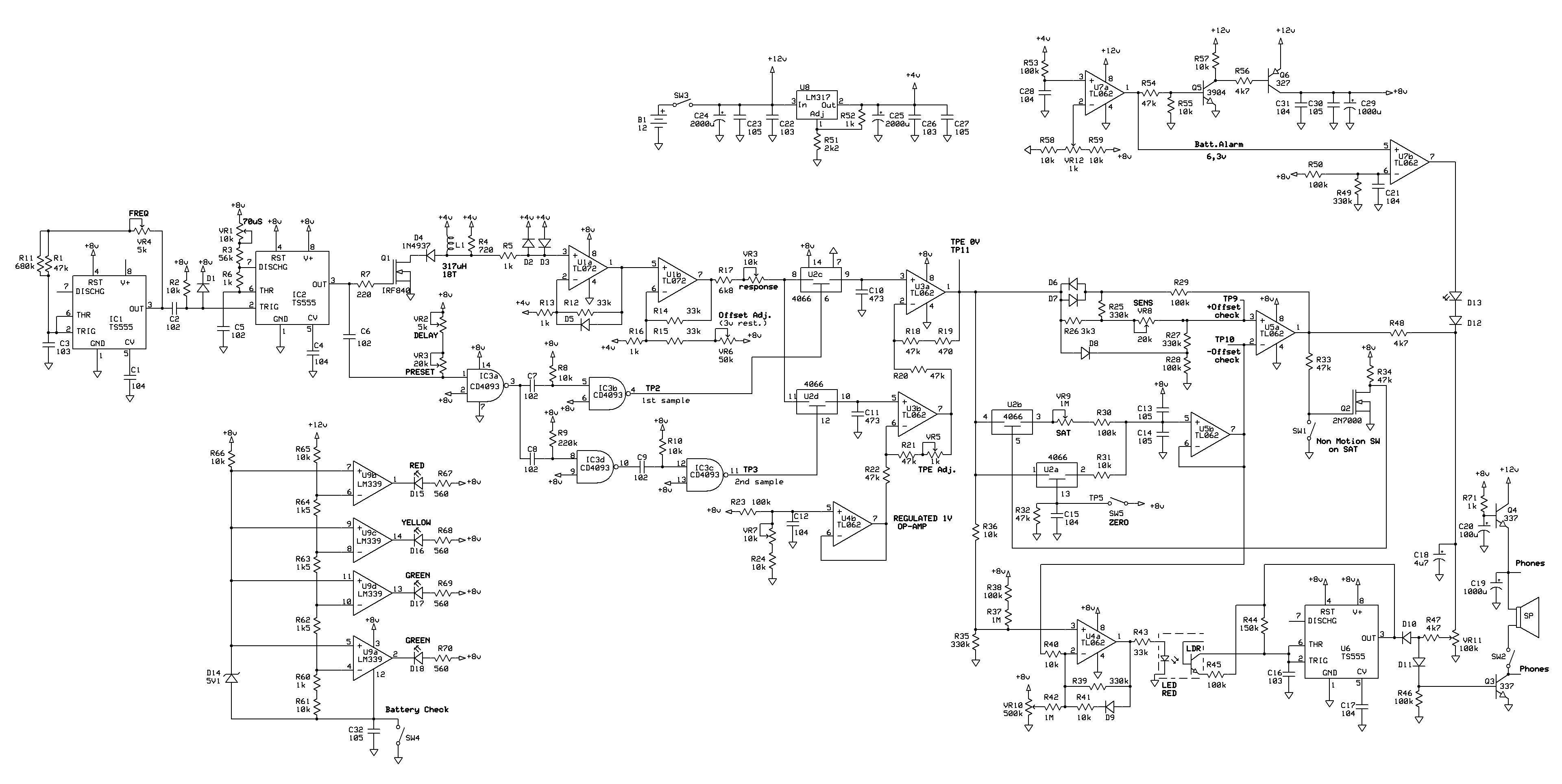

                      I also tried to put all the pieces together.
                      But i find some comments bit confusing, like "..audio+in TP3 connects to "to audio" TP6 ONLY..." ?
                      Here is what i did, i would like this to be checked from mistakes.
                      Most probable mistakes can be at points where schematic pieces should be connected.
                      I would like to try to make this detector, since i also like what i saw on video.
                      Yet, until i got 100% properly connected schematic in one piece; i will not want to waste my time on drawing completely wrong pcb.
                      Dooley if you can catch some spare time; please do check this:
                      • #56
                        Pin 8 of IC1 should be connected to V+, this is all I've noticed missing. Also in order to simplify I swapped Hammerhead oscillator cos it has less parts and does the same.
                        • #57

                          • #58
                            Correct!
                            What a shame!
                            I founded similar mistake at Dolley's original schematic and reported to him... now i done the same!

                              hello ivconic.
                              ah yes,
                              I issued a corrected schematic further down the thread regarding the missing link between pin 4 & 8 on the 1st 555.
                              was a silly mistake by the program I was using when I moved the component for more space ..........
                              but,
                              schematics checked many times and that was the only error.
                              I used 2 x 555's for the TX pulse to enable the frequency to be altered WITHOUT affecting the TX pulse width,
                              simplifying the pulse generator down to only 1 x 555 would be inaccurate.........
                              unless you disable / remove the frequency pot.
                              which, to be fair would be fine as I never found I had to alter it anyway.
                              ok,
                              checking your schematic against my original............
                              for YOUR D13 I used a flashing blue led, can be any colour,
                              I used flashing so that the batt alarm would be on / off / on / off bleep bleep.
                              phew !!!!!
                              right, been right round your schematic,
                              was strange seeing it in a different layout,
                              but by golly I think you've got it !!
                              one thing I will say though ,
                              many many times on here,
                              schematics are posted with mistakes, deliberate or not, who knows...............
                              but,
                              whenever I post, I post EXACTLY what is in my box,
                              100% , straight down the line,
                              so rest assured ivconic,
                              when copied it will work as mine does.
                              oh,
                              one further note :
                              the homemade LDR / IRled coupler,
                              I used a fairly fast LDR there,
                              needs to be fast responding to alter the pitch as a target passes.
                              recently I purchased some LDR's of ebay,they were a bargain !!
                              but,
                              they are as slow as hell !!!
                              and could NEVER be used for this purpose.
                              hopes this helps.
