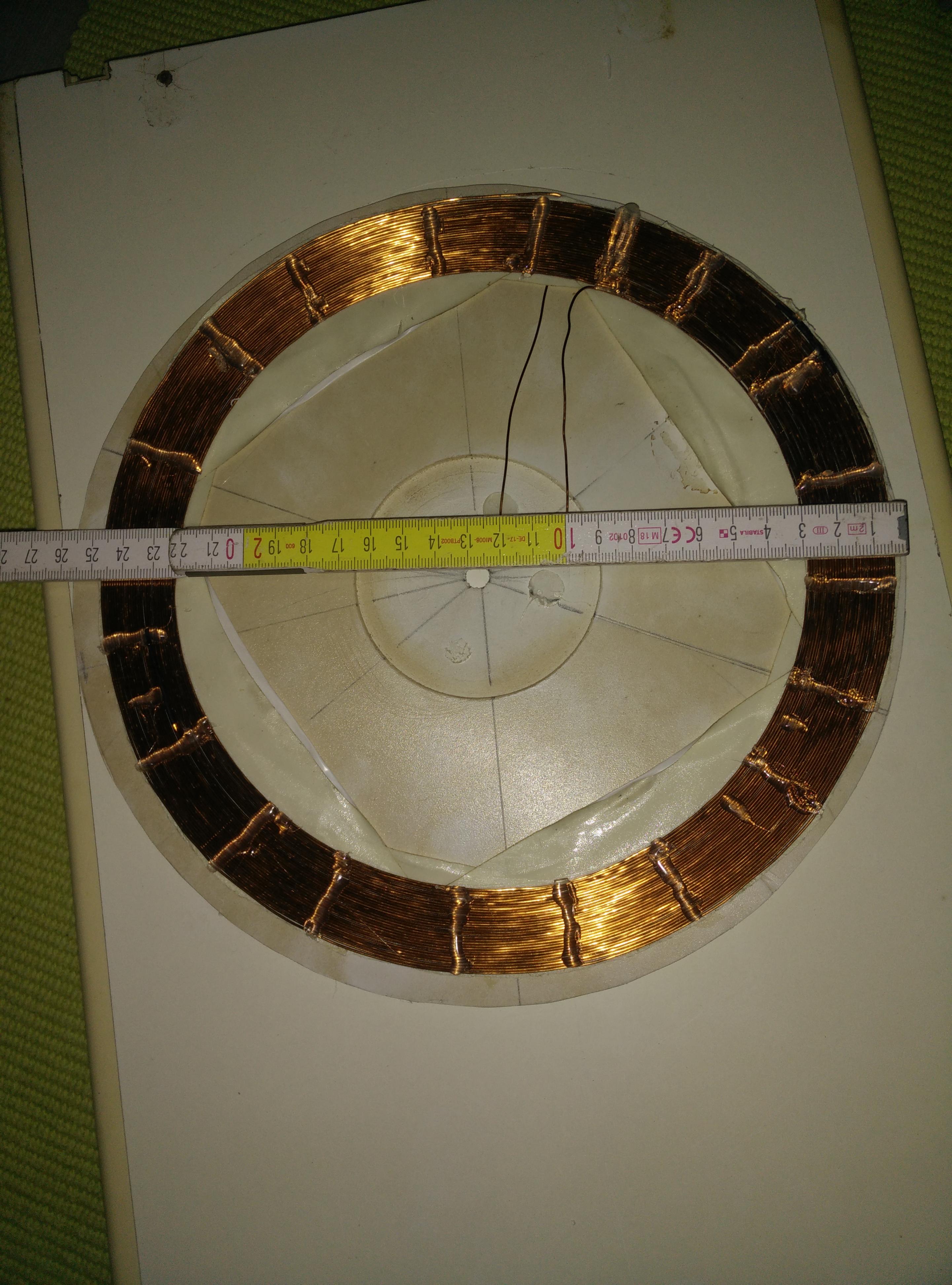

              • I built a new coil 0.9 ohm. Unfortunately I don't have an inductance meter and I built it with arduino.I am also waiting for the new pcb to arrive. From the calculations on the site coil32 should give me 350uh, but with arduino the value is between 380uh and 390uh. In your opinion is an acceptable inductance for a coil with an internal diameter of 20cm and an external diameter of 24.5cm?

                  Your coil looks excellent, and should work well. Measuring inductance is always a tricky thing. Try measuring a small inductor of known inductance(such as from an old radio set), something in the micro henries range, and see how far off the reading is. That would give you an indication of the margin of error. Better yet, you can purchase one of those component testers off of Ebay which seem to do the business pretty good. The M328 tester. It goes by other names too. It's an LCR and component tester.

                    I finished assembling the electronics, the debug values ​​are very close to 300 700 800 with this coil (296/698/796 are the best average values ​​I obtained by adjusting frequency and pulse). I have no gold to see if it detects it :P but a 1 euro coin takes it at 25cm
                    • I am very happy with the operation of the metal detector, air test playing with the parameters finds 1 euro at 34cm, 0.2 grams about small gold medal 5cm. When I get the bms for the batteries immediately field tests!

                        I am wonder how you have wound your beautiful coil; could you explain, please?

                          30 turns SWG22 enamelled copper wire internal diameter 20cm, I applied a good quality scotch over a board to hold the wire during the winding, then with a plastic circle of 20cm I started clockwise and I wrapped very patiently. finished wrapping I passed the hot glue as you see in the picture always very patiently holding the flat wire with two plates and bench clamps. in the end I wrapped the wrapping in the upper part and poured the epoxy resin just enough to cover the coil. finally I filled it all with polyurethane foam. For the base I used polystyrene, for the edges and the lid the polypropylene
