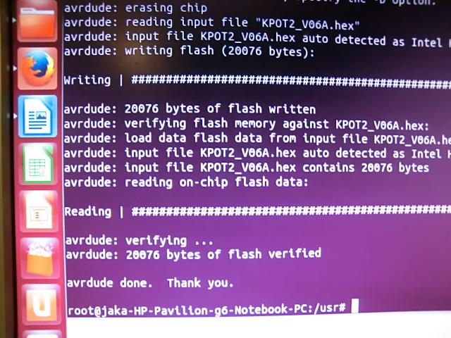

            For programming I used Zeptoprog II USB programmer:
            http://www.mattairtech.com/index.php/development-boards/zeptoprog-ii.html
            and AVRDUDE program (under Ubuntu) for programing AVR MCU inside Terminal interface.
            I used this AVRDUDE command code in Terminal for flashing XMEGA32 chip:
            avrdude -p x32a4 -F -c avrisp2 -P usb -U flash:w:KPOT_V06A.hex
            In procedure Zeptoprog II USB programmer need to be connected first to USB and set to programing mode. 5V Vtgt jumper should be disconnected to not damage 3.3V MCU.
            Then we associate "PROG" connector pins on XMEGA board with adequate pins (GND; Vtgt; PCK/RTS/RST; data) on Zeptoprog II USB programmer.
            If all is OK, issuing above command in Terminal and XMEGA programming will be carried out.
            After successful procedure Terminal display should look like this.

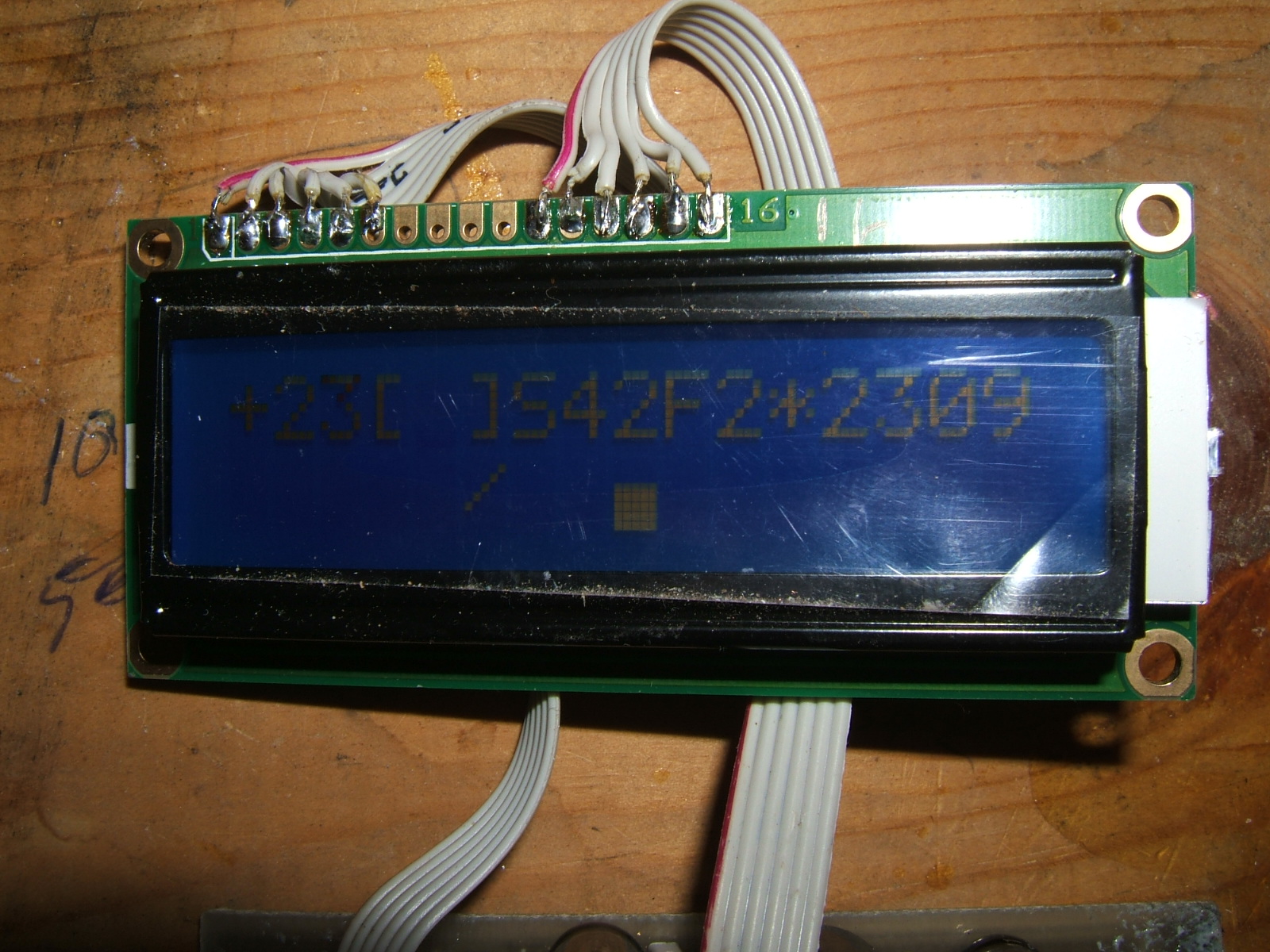

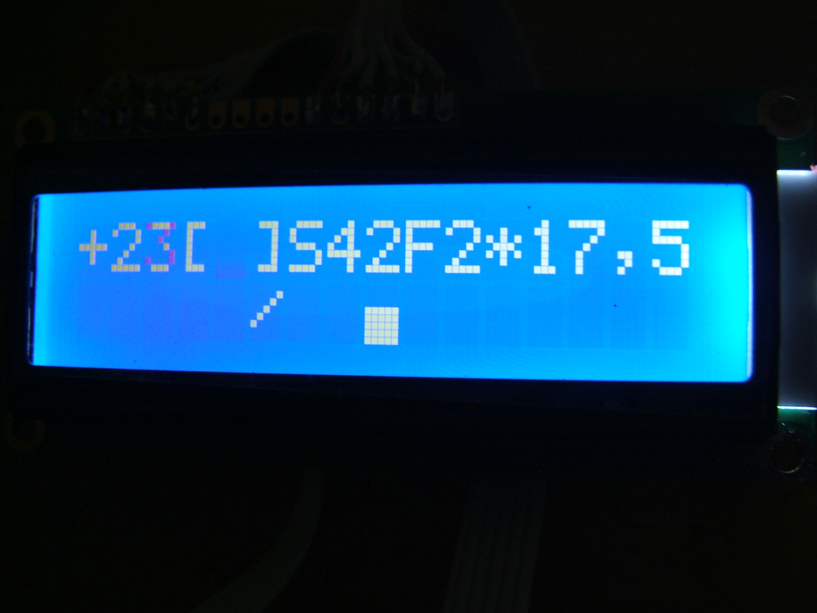

                Hi Geo
                Contrast is working if I supply VDD pin of LCD module with 5V only. Present solution with 3.3V LCD VDD pin supply do not imply to contrast by changing R19 value or barely remarkable. In no case I can get visible character on display, so I conclude that there is logic level 3.3V that is not sufficient to manage LCD module logic part. I did not check other parts in line with R19 you mentioned (PCB leads are very thin and sensitive to de-soldering parts for testing).
                Geo, if you are willing to continue play with it, I can send this board you today - please PM me your shipping address.
                • WM6, I tried several 5V displays, and they all work good so that is not your problem. As you power it up, you should hear a series of tones. yes, if your contrast is set too low , you wont see anything displayed on the screen.

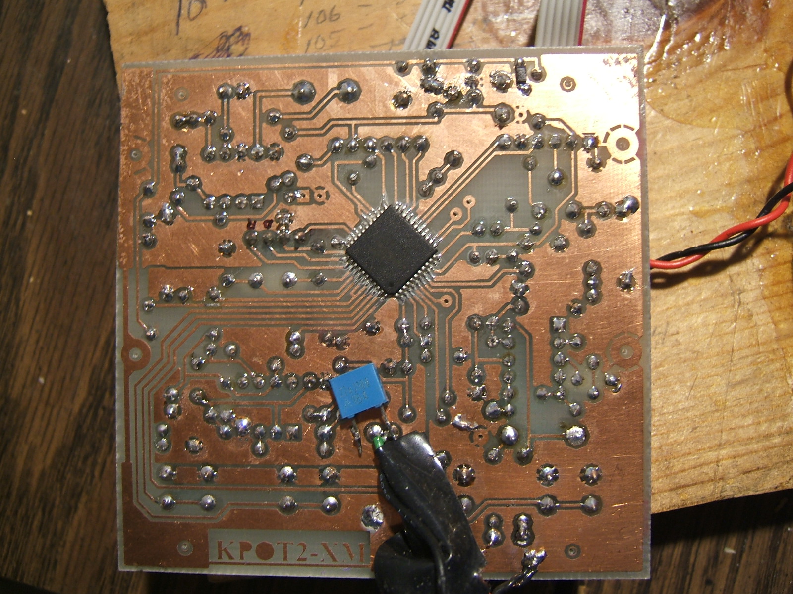

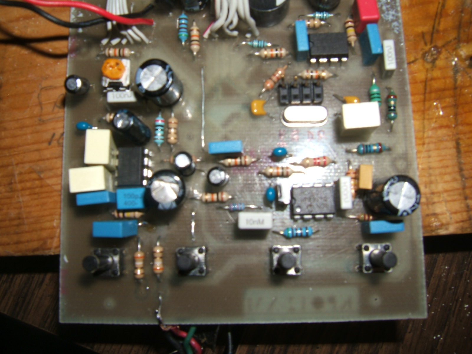

                  • Hi Tepco, I tried connecting TX coil in bridge mode. I am using Dip version of board. The connect points are TX1.1 and TX1 on the board. I added a 5 ohm resistor at TX 1.1. There is no current output to coil. have you tried this bridge mode?

                      Yes....
                      • Originally posted by Wiltran View Post
                        Series of tones at power up are the same as on author (Andrey) board, so no problem with start tones. Changing R19 do not imply to contrast (or barely visible) - except if I change VDD supply on LCD (separate) to 5V - in this case contrast works OK. But there are not info/character generated on display no matter of contrast and no matter of VDD
                        supply.
                        Maybe I need to change some (soldered) jumper on LCD module, but I didn't find technical data of this jumpers for my LCD modules type JXD1602A.
                        Can you post photo of your DIP version of KROT-2?

                          • Good work Wiltran.
                            As I can see you didn't always use exact value of components as per author suggestion (par example R1 and R2)?
                            • In the original Schematic it shows r2 and r1 as 1 ohm, but in the parts list that came with the DIP version it shows R2 with a 2ohm. Also the newest schematic show 1000 mfd electrolytic replacements. I am also going to replace my 2200pf capacitors with COG(NPO), hopefully for better stability. I am using unshielded DD coils, which are not yet nulled, so I am sure that will help.

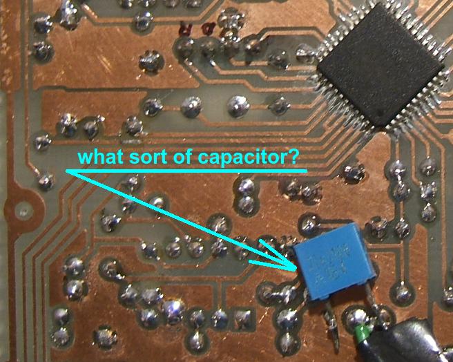

                                Hi Wiltran, where did you find newest KROT-2 schematic? I am checking http://radiodom.ucoz.ru/index/selekt...t2_m_quot/0-17 site, but there is still old known schematic?
                                Also, what sort of C did you use in TX tank circuit?
                                Author suggest metalized polystyrene film capacitors (I used available polyester) and to solder it direct to cable connector.
