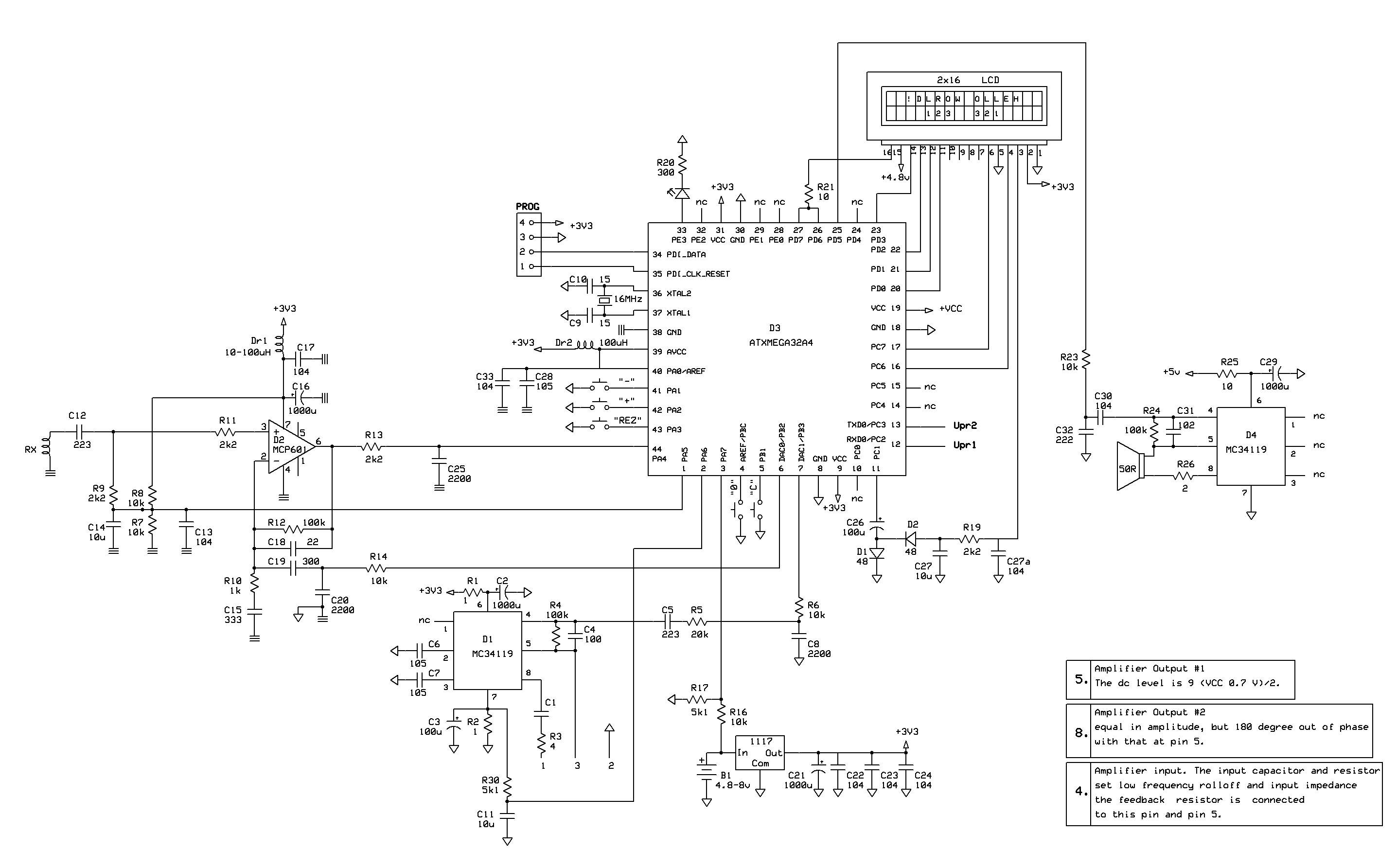

                        Yet i can't easy obtain damn MC34119 in local shops.
                        So i was thinking to try it in "phases".
                        First phase would be to transfer it to Arduino Micro and see the behavior, measure some signals etc.
                        Next phase is to omit damn MC34119 and put there something else.
                        MC34119 is actually good choice because of the 180 degree out of phase outputs which can later introduce more delicate coil, i really like that part!
                        But i was also thinking to try more simpler approach ... at least for the beginning. Until i obtain several pieces of MC...
                        It would be easy to mod it anyway i want, actually.
                        But... just skim looking on original schematic is horror to me! Nasty, sloppy, ugly and pretty stupid way of presenting such schematic.
                        Especially if you want to manipulate with it in different software than author did.
                        So... first phase would be to "transfer" that piece-of-crap-schematic to something more convenient. More easier to manipulate with.
                        Next phase would be to remove Atmega from schematic and re-wire Arduino Micro.
                        Etc... etc...
                        So far i done only first step.
                        Here is my trivial contribution to this story:

                        • I would caution you about trying to convert this from a xmega to a mega. The X mega has a lot of peripherals that the mega does not, and it has a cross bar selection mechanism to map pins to peripherals.
                          It also has, differint ADC/DAC features.
                          That being said, I've been wondering for a long time, what the heck this guy is doing with DAC0 going through R14 to the op amp. what does that accomplish?
                          Obviously, he is applying a variable voltage to that circuit, which will cause it to operate differently, but what is the functionality he is trying to achieve here?
                          • Personally, I would like to take this circuit and replace the XMEGA with a PIC24FJ256GCxx part. It has a 16 bit ADC at 60K samples, as well as a 12 bit ADC at 10 mega samples, with auto oversampling.
                            In the case of converting to a PIC or arudino, one would have to write the code from scratch, unless the author would be willing and able to port it, or release the source.
                            The XMEGA and the arduino are not binary compatible.
                            Perhaps you could walk through his circuit and try to explain what each block is doing.

                            PA4 and PA5 seem to be assigned as analog inputs, but I don't know what he would be trying to do with PA4..... or is he using PA4 to play with the input signal?
                            Without knowing how he has configured the xmega internally using the cross bar, you are pretty much guessing...

                              • Originally posted by scrungy_doolittle View Post
                                Yes those are interesting questions too.
                                But mostly i was wandering about PA6?!
                                Only thing comes to my mind is some sort of TX power sensing&regulating... through the ground pin?
                                I guess PA4 is taking analogue signal, buffered and amplified (low gain obviously) in ordodox manner.
                                While PA5 is using voltage taken raw directly from coil and used for "digital" coil balancing, displaying it as residual voltage on coil, additional RX gain control etc...
                                Really not sure, not payed much of attention on various video demonstrations, not sure what exactly is going on on LCD during initial setup.
