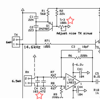

  • My Igsl tgsl behave in a strange manner...
    cannot adjust trimmer TR3 (100k)
    i get no sound at all or a continuous tone (mix of two tones) sometimes it works (with <10 cm
    detection depth) but soon the long tone or silence return
    First i try to adjust trimmer tr3 but i can't find rigth position, after i replace tr3 with multiturn
    trimmer and again i can't find right position...
    after i try to replace tuning capacitors (C4, C43) with 15nF (J tollerance) (like TGSL schematics) and then i return to
    4n7F (K tollerance) and 10nF (K tollerance) (i try different ones).
    I use the original 8" tesoro silver umax coil, (waithing to build my own coil)
    anyone have similar problems ? thanks in advance !
    • Could you please post a part of schematic you are referring to? I have troubles finding that particular trimmer on my schemes.
        schematics is the one, currently on silverdog.
        stars marks the trimmer and the capacitors.
        Thank you Davor

        • As for the trimmer, you are supposed to obtain oscillation of the Tx oscillator. Once you do, the amount of bias you are adjusting with this trimmer is supposed to be fine tuned so that the oscillation is as clean as possible, but for the time being just go with any kind of oscillation. You'll fine tune it later on.
          I'm not familiar with your coil and to determine what capacitances are needed you'll need to know the coils' inductances. In case both inductances are as per the TGSL specification at 6 and 6.5mH just leave it be. In other instances you'll have to do some corrections. Can you determine the coils' inductances?
          For the instability problem I'd be looking somewhere else. Most probably your lab has some noise source that your coil picks, say laptop PSU or something.
            unfortunately i'm not equipped with oscilloscope then i use a pc based software (visual analyzer) i can't see frequencies below 14 khz (due to pc sound card limitations), but i think the oscillation always take place.

            • No worries, inductances are close enough. Just stick with the original values.
              Try finding some electrically quiet area with some half a meter distance from metals to do your initial adjustments. Make sure you tune GEB correctly, and from there you'll find the rest.

                    I had several errors in my setup (all fix now )... ground pot for ferrous channel reversed , low power supply.

                    • Make sure your GEB is set right. Most probably it is not adjusted properly. Once you do, you may try playing with TR3 to see if it affects detection distance. Disc Sens also affects distance. A choice of opamps in gain stages as well. In case you used LM324's there, you'd lose some significant distance.

                      • To set this up with a clean sine wave (the reason Ivconic put the trimmer there in the first place), you do really need a scope, but as you are getting sounds (and the correct voltages) it must be working reasonably well, so leave it alone till you have a scope available.
                        I don't think that using a meter on AC will help much, but you might like to set the trimmer for the highest possible voltage output for example......but don't expect much change! I have never personally tried it myself....

                        • My musketeer IGSL oscillator is a bit different, but in a way does the same job, and I observed the FFT of these oscillations. Point is, as expected, that the purest oscillations are obtained near the border of spontaneous starting the oscillations. You actually do not need a scope to find this spot. First you establish oscillation, and then you lower the amplitude by TR3. When the oscillation stops just go back a little to the point it starts back again, and a little notch more - that's it.

                                My ......purest oscillations are obtained near the border of spontaneous starting the oscillations. You actually do not need a scope to find this spot. First you establish oscillation, and then you lower the amplitude by TR3. When the oscillation stops just go back a little to the point it starts back ....
                                ok I agree with this tecnique !!! this is the reason why i put a multiturn trimmer instead of classic tr3 trimmer.... cause the adjusting of tr3 with a screwdriver is so difficult !!!.
