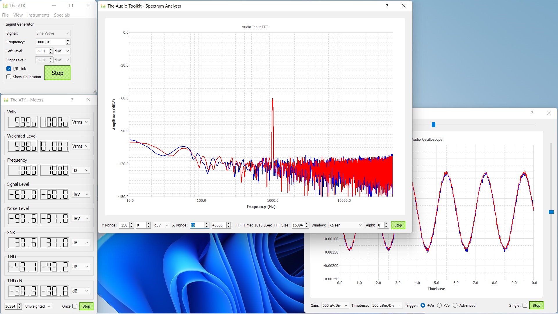

                                While waiting for the boards to arrive thought I'd resurrect an audio toolkit that I wrote a while back to run on a high quality sound card.
                                Should be perfect for measuring the noise output from the preamp.
