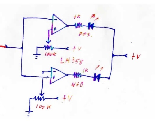

                        • I think we can discriminate between ferrous and non-ferrous.

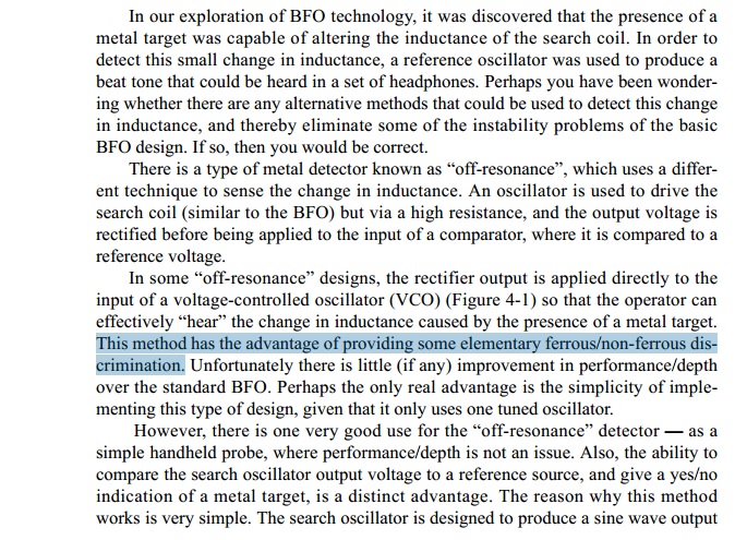

                          • No, that's not going to work. Inductance shift is very small, in a BFO it is typically a fraction of 1%. Also, it is unlikely you can combine such a circuit with a PI transmitter.

                              • Dear Carl
                                See the attached, it's part of Off-Resonance of your Book.
                                I want to add the schematic beside of my HH1 but i need your help.
                                As you see, you mentioned the advantage of the Off-Resonance is its ferrous/non-ferrous discrimination.
                                Is is possible to guide me how to change the schematic so that it discriminates between ferrous/non-ferrous via two LEDs?

                                Please consider your off-resonance schematic in p. 37,IMD book. I want to add the two LEDs (attached) in out of IC1b (pin-7). Do you think it works for showing decreasing/increasing inductance coil?
                                Actually, after detecting a target by HH1, i will turn off it and turn on my Off-Resonance (your schematic) for discriminating ferrous. My main purpose of this is for nail!.
