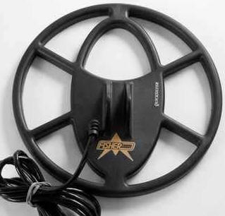

      28cm concentric "spider" coil (Quicksilver series) for Fisher CZ5 (later CZ3D) is having approx. 2M (mega ohms) on coil surface, wherever the ohmmeter probes are touching it???
      It doesn't make any difference whether the probes are touching closer or distant spots on it's surface, it always read the same value !???
      I was more than surprised when tried that!??
      A miracle? Special material?
      And even more funny is; it is measured on upper surface of coil !
      That's splendid coil with splendid performances.
      But until today i haven't figured out what "secret" is laying behind that material?
      I guess that's probably the most suitable material for coil enclosures, provides also excellent shielding.

        also it does not stick to plastic well and peels easy because there is no binder, spraying with plastic spray may work, but I dropped it.
        In this case plastic should be first treated with plastic painting primer.

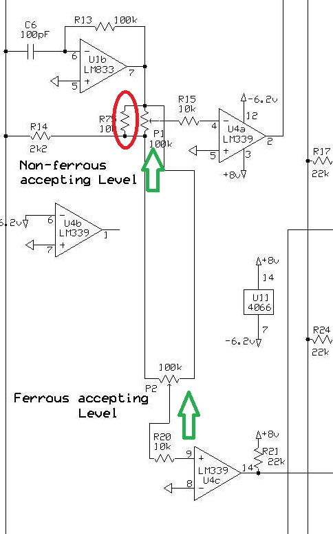

              • I'm a bit late, I just started building this board and am using Davor's mods.
                When we combine the Disc circuits we end up with 2 100K pots in parallel
                with a 10K fixed resistor. I just wondered if the 10K should be changed in
                this circuit;
                • 10k value sets phase tuning range together with 2k2 resistor. In my mods I tried to apply functionalities in a way that I kept most of the existing components intact. 100k potentiometers are easier to source, but a good motive to keep a relatively small parallel resistance is typically ridiculous variability of potentiometers' total resistance.
                  For this mod it is safe to replace 100k potentiometers with 20k, and throw away the 10k resistor. Argument in favour of this solution would be easier wiring, because lower impedance is less prone to pick up stray signal.
                  Frankly, I can't remember why I chosen one solution over the other.

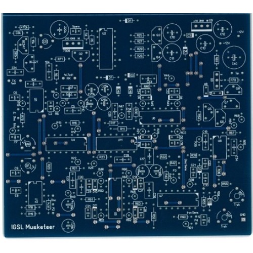

                          • Hey silverdog. Just bought IGSL and Bara. Freaking awsome.
ID:	347654I just bought igsl musketeer board from silverdog. Can someone give me the exact schematic and part list for this pcb? Thanks
