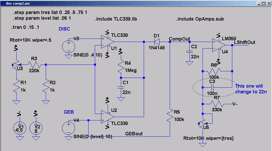

            ...That R58 2k2 resistor looks more like it may be part of a Schmitt trigger circuit to me
            Actually it has the very same function as a 100k in TGSL/IGSL. Everything else you said is very true.

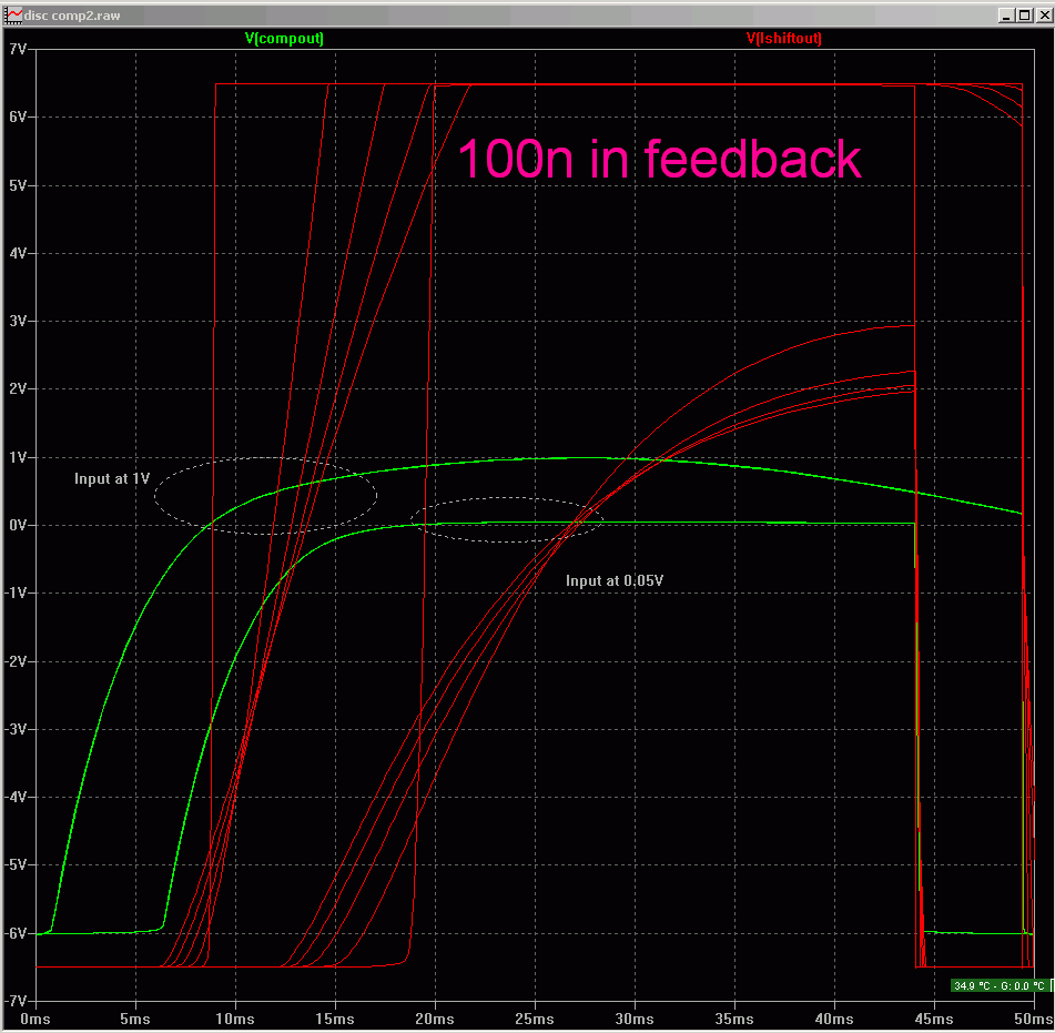

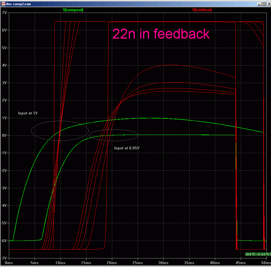

            Delay in current IGSL is dominated by a capacitor in LM358 feedback for all threshold trimmer values except for 0ohm (binary response), while 1M - 22n near comparators does not do much - at any signal level. Considering you really wish to employ a chatter filter, and you are happy with current delays, a feedback capacitor (100n) may require some tinkering. Lower values give more consistent behaviour.
            Let me show you (comparator switches at the sudden rise of a green curve)...

                              Hi Davor:
                              Would you post the LTSpice file for this latest sim?
                              -SB
                              It is very same as the first untouched one, with only difference of stepped GEB channel signal (to show the difference). Here you are...
                              Once you are playing with it try increasing the threshold pot Rtot.
                                Yes, I agree with your conclusion that the feedback RC dominates, and looks like we could dump those other caps and 1 meg resistor, which is a useful find, thanks! I'm not experienced enough to know if those parts were intended to help with some real-world glitch of some kind...
