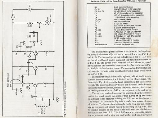

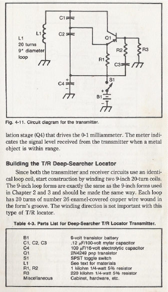

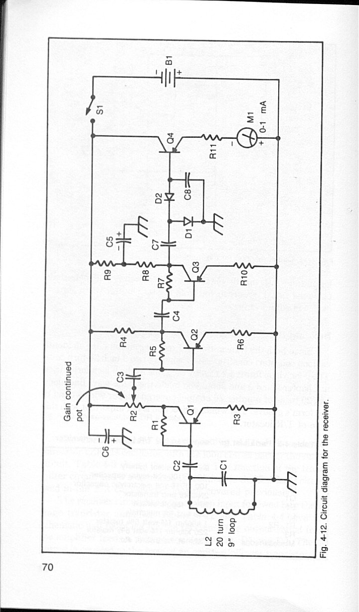

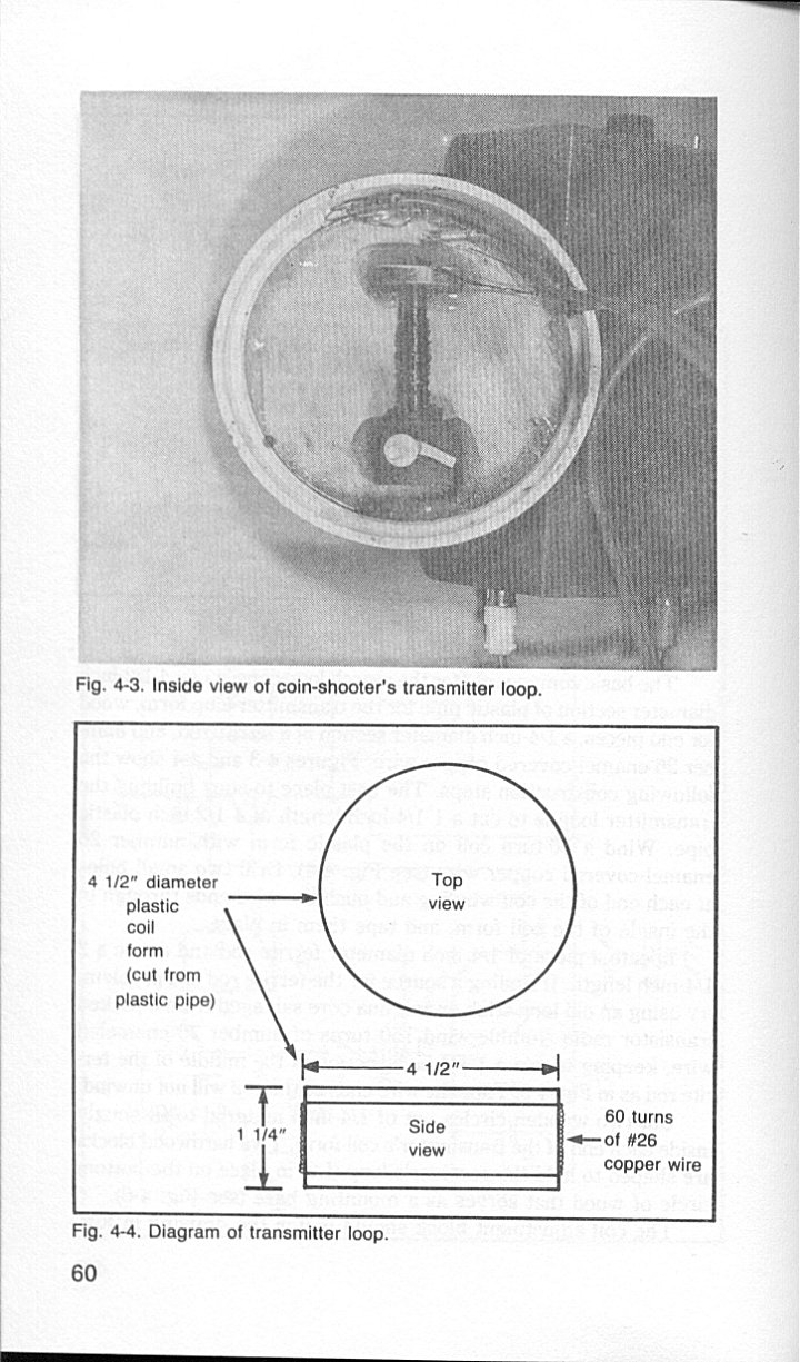

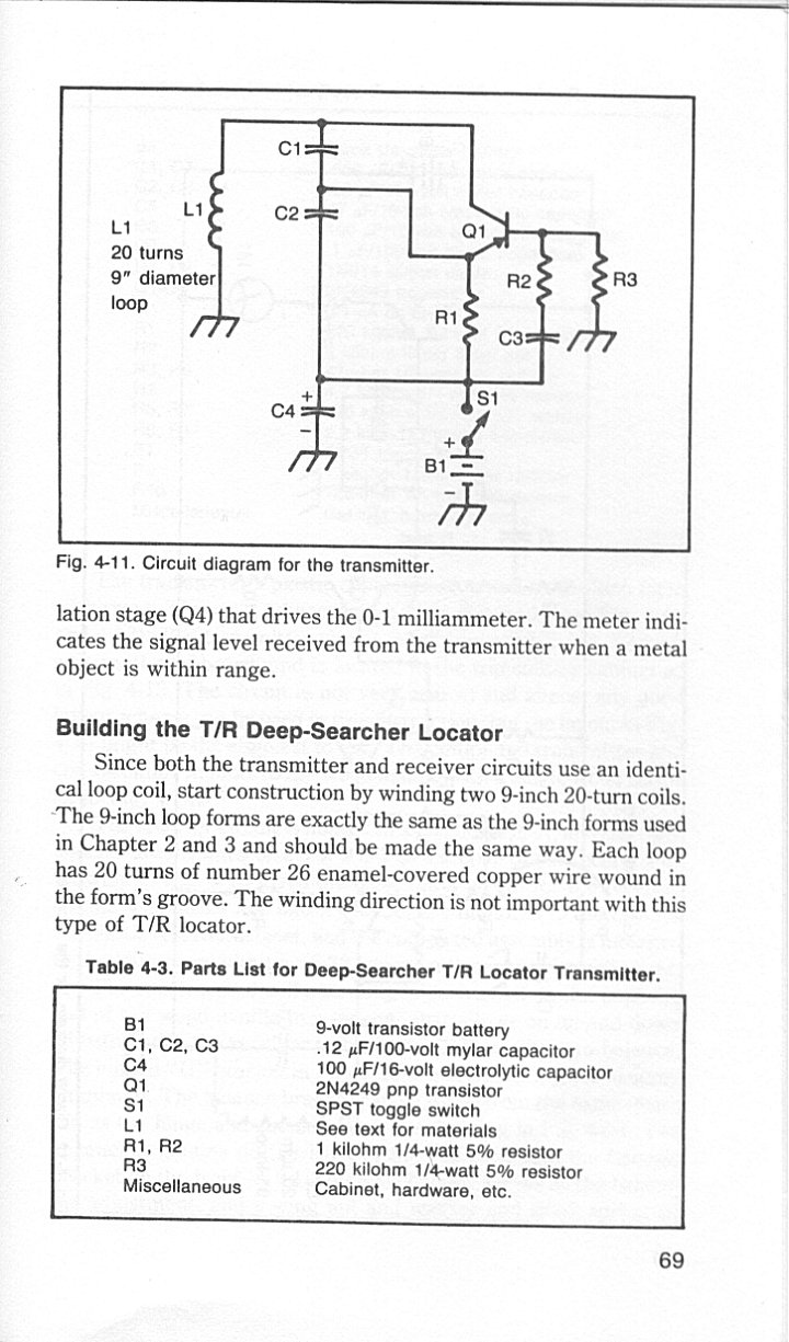

          • Easy two box
            Hi Gary. Here i m sending two pictures of a two box metal detector that a friend send me. By now i lost his email, so i can´t talk to him again, but if he is reading this post i ll be very happy to see a note of him.
            He send this images from an old book about metal detecting, so if anyone can review this circuit and tell us if he think that may work, please let us know.
            The circuit doesn´t have audio, just the meter. I also have details of the mounting part and the coils if anyone wants to know more.
            Nelson
            I'm Not sure I Understand.
            But if I discontinued a project, it was probably because it gave Poor results.
              Nelson
              This circuit is from "Building Metal Locators, A Treasure Hunter's Project Book" by Charles D. Rakes. It was published by TAB Books Inc.
              I have a hardback first edition copy dated 1968. ISBN 0-8306-0606-1
              The paperback version is ISBN 0-8306-2706-5
              It is claimed that this detector can seek out average to large metal objects that are buried as deep as 3 or more feet. If you have any pages missing I can scan them in and post here.

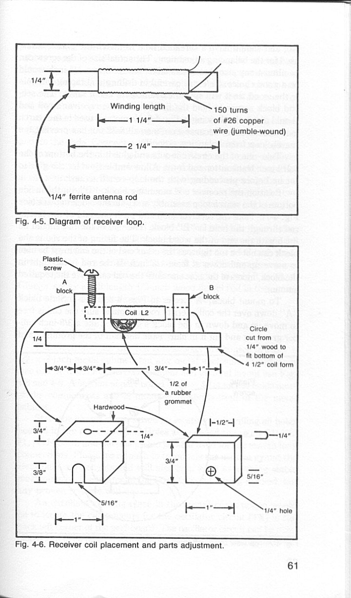

              • Two box metal detector

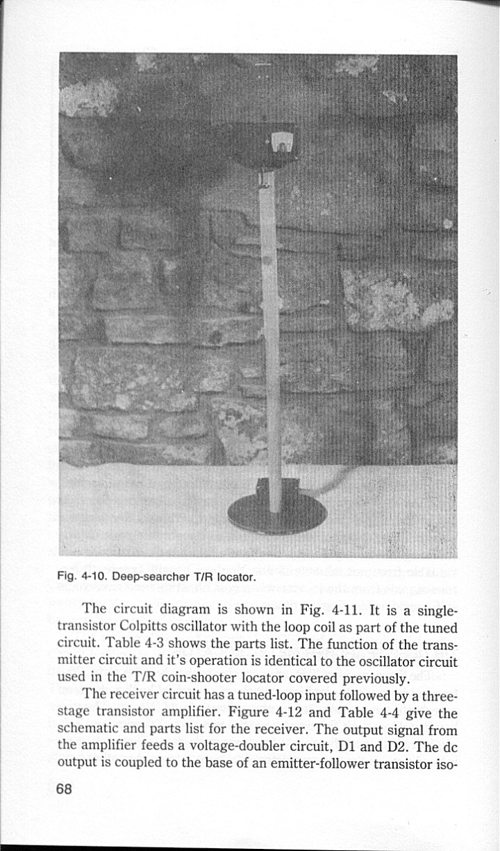

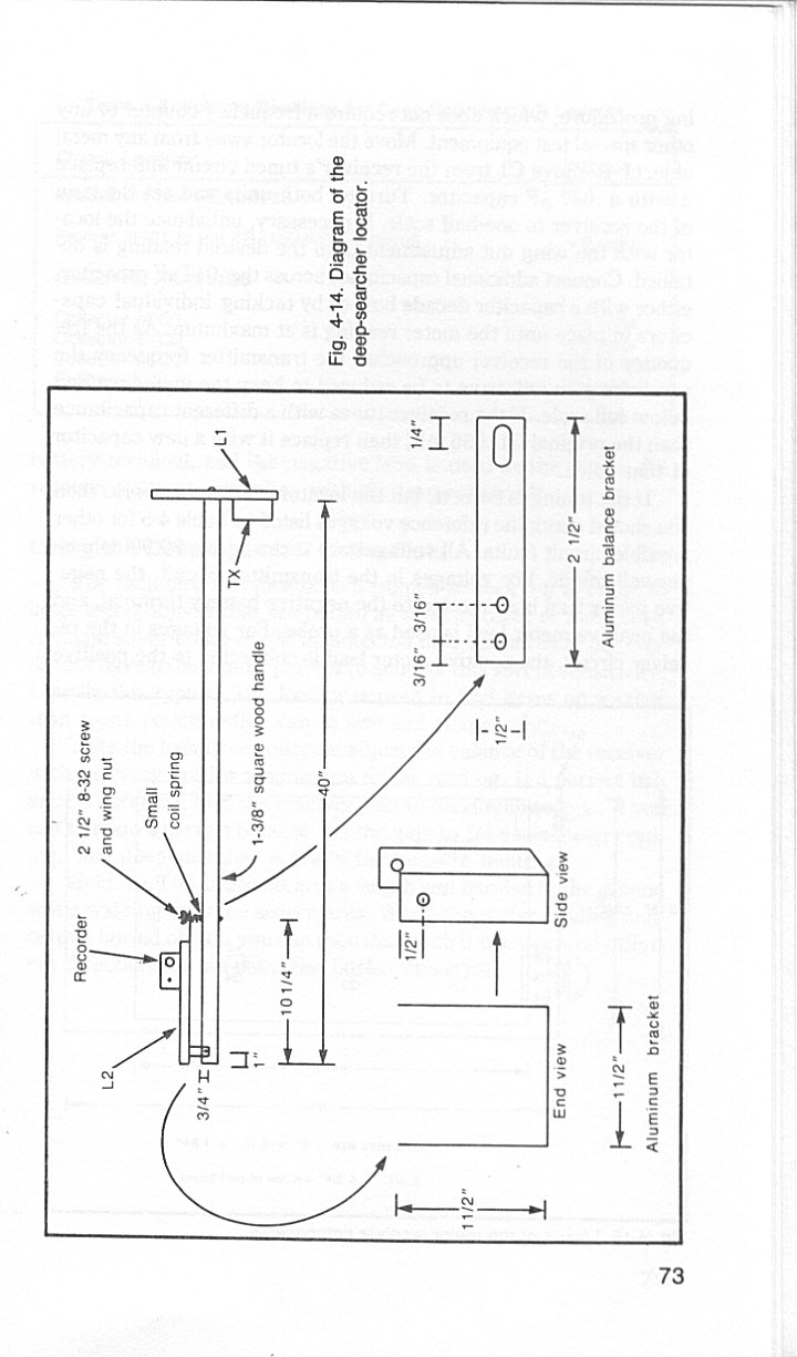

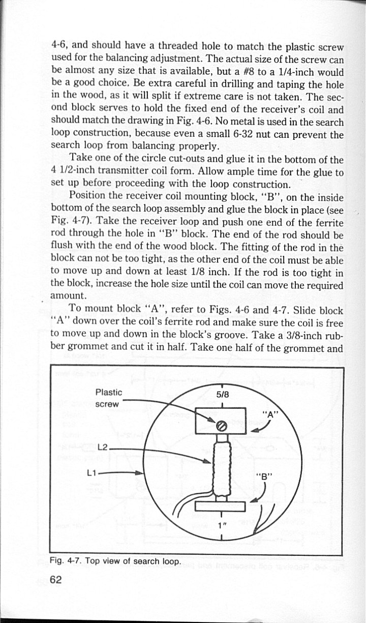

                  Yes I have seen that one before.
                  To me it seems a bit too simple to really be that sensitive in most ground. But a lot has to do with coil alignment.

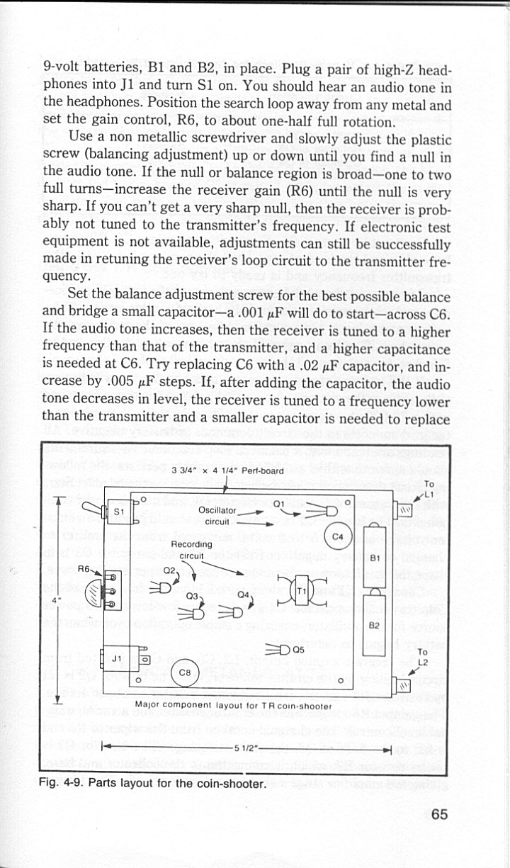

                      I'm Working on it.
                      However there are some Definate Changes between the Schematic I Saved fro this posting, compared to the PCB Overlay, also posted here.
                      So Now I am Not Sure Which is Correct????????
                      For One, the Overlay shows a 4049 IC, but only 14 pins.
                      A 4049 is 16 Pins.
                      The Overlay, also Does NOT show the Supply pins Connect to Supply Voltages.
                      How can this IC Run? REALLY STRANGE!
                      Additionally the Schematic Only Shows Q1 and Q3
                      But the Overlay shows Q1, Q2 and Q3.
                      Lastly there are Two 1N4150 Diodes on the Schematic, But they do Not appear on the Overlay, nor does there seem to be any Connection points for them to mount too. ???
                      There are a few other variations also.
                      So the Problem Now is: WHAT IS CORRECT?
                      Or am I Missing Something in my old age?
                      • Or am I Missing Something in my old age?
                        Gary, the authour did the schematic on a dummy bread board. Ivan himself did not make a PCB. some people did the layout image what you see. maybe best solution will be do Overlay as new? I do not know...
                        I did add these like to Tesoro's schematics. not originally...
                        pls also add a place on PCB for capacitor I image here. I think may it is necessary?..
                        regards.

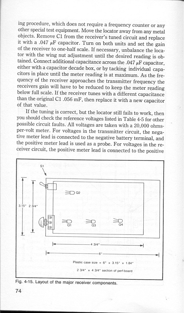

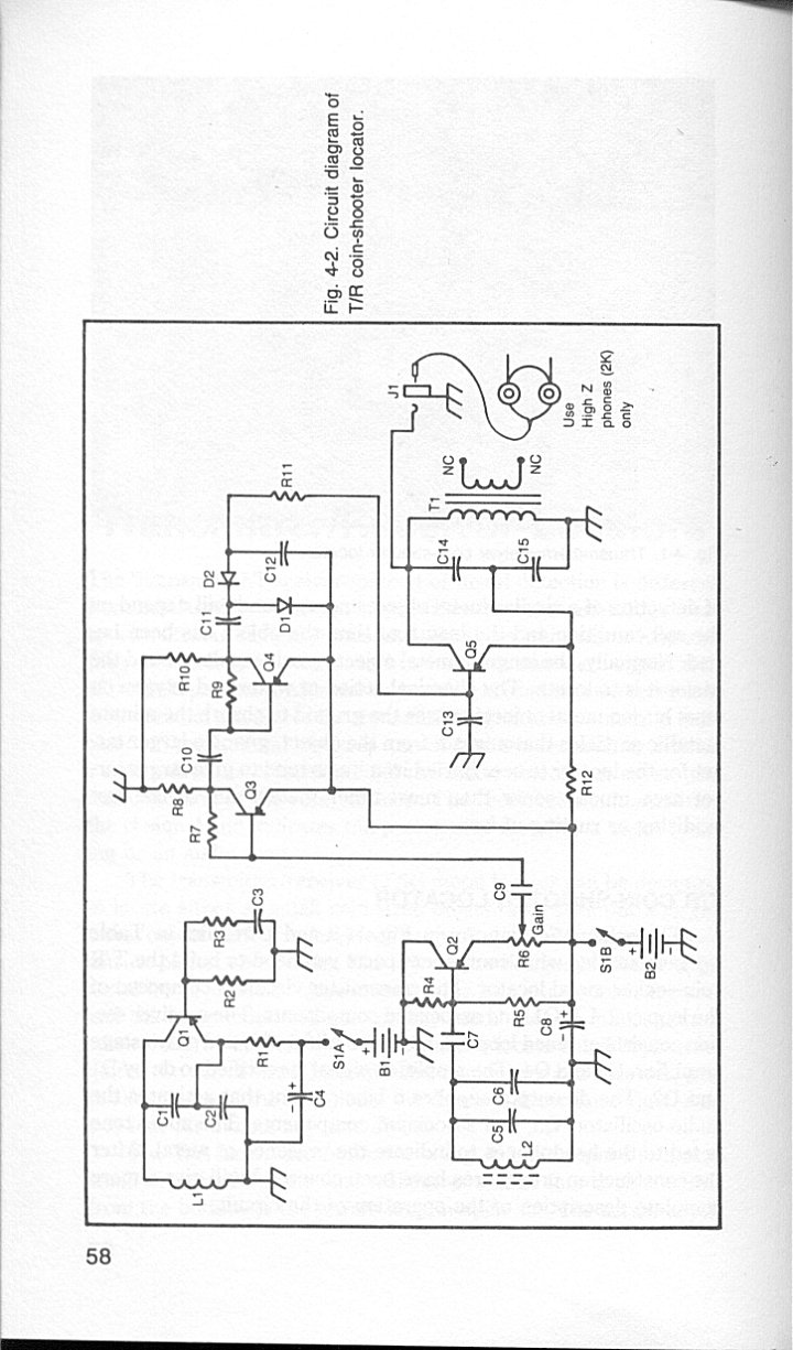

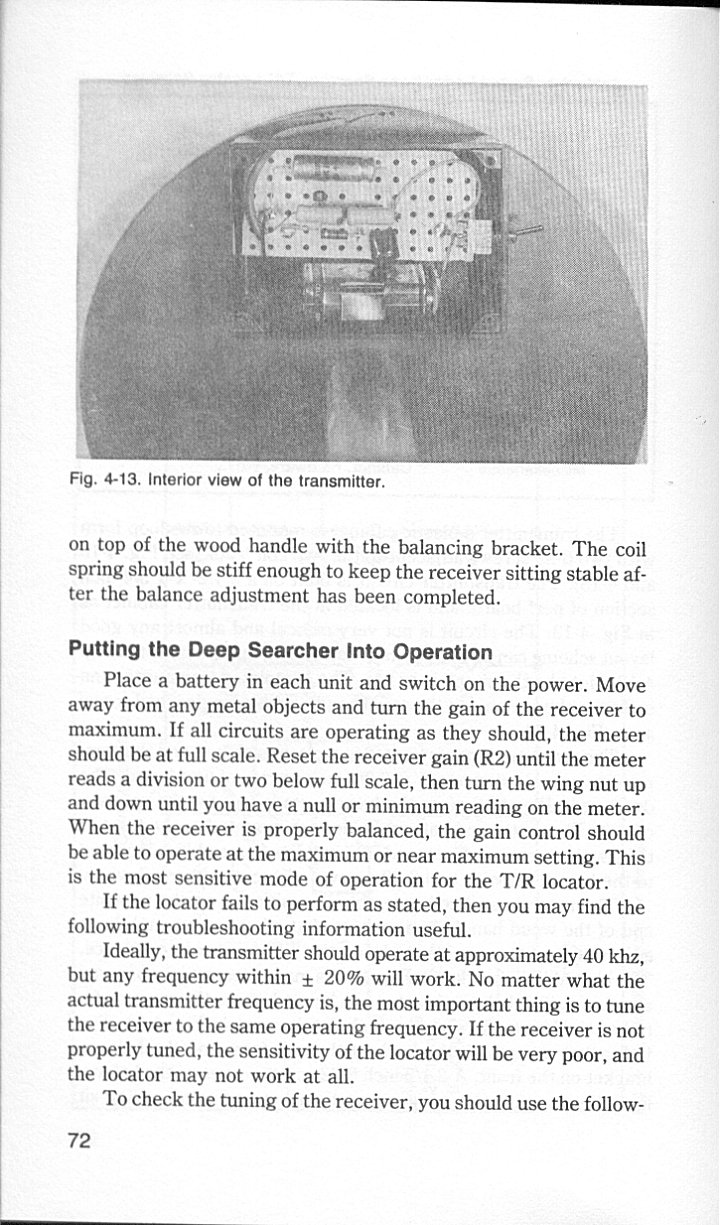

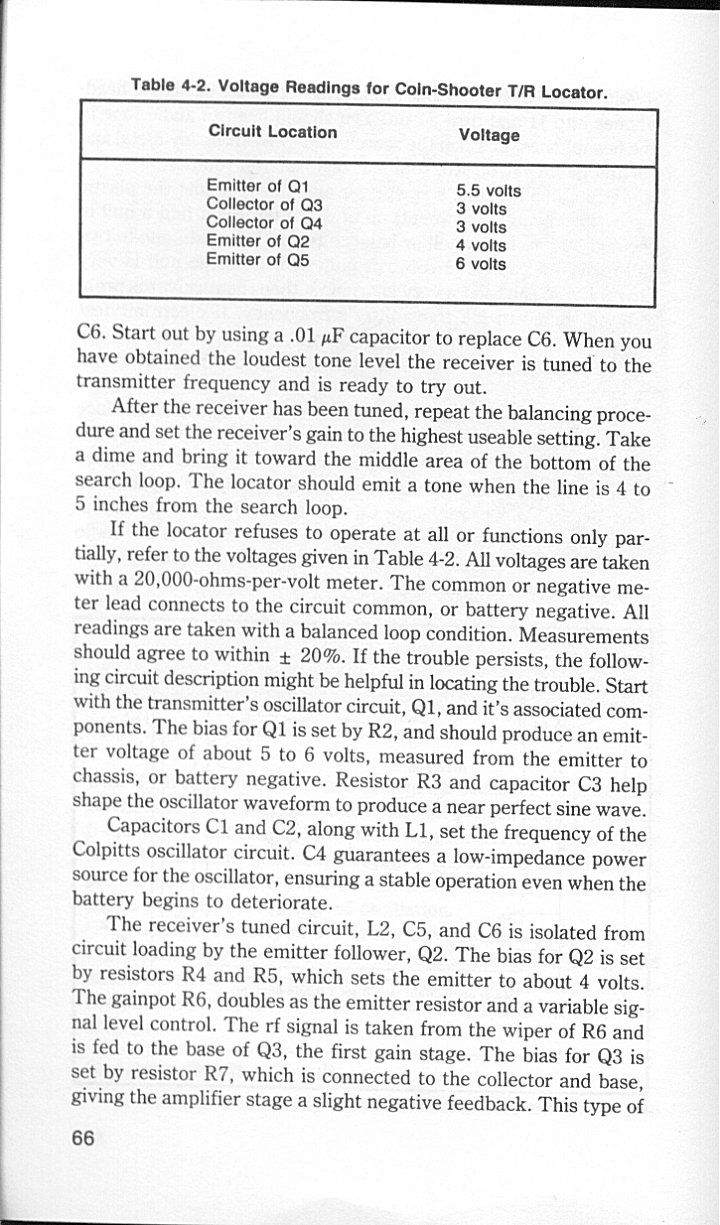

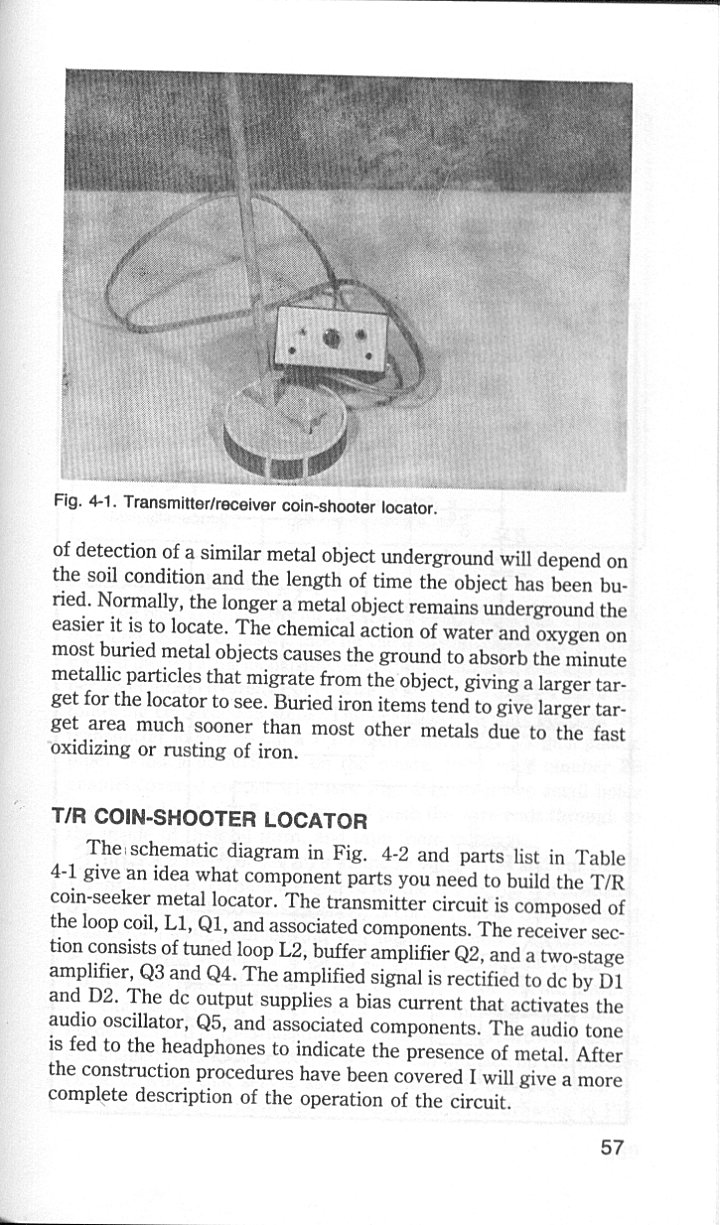

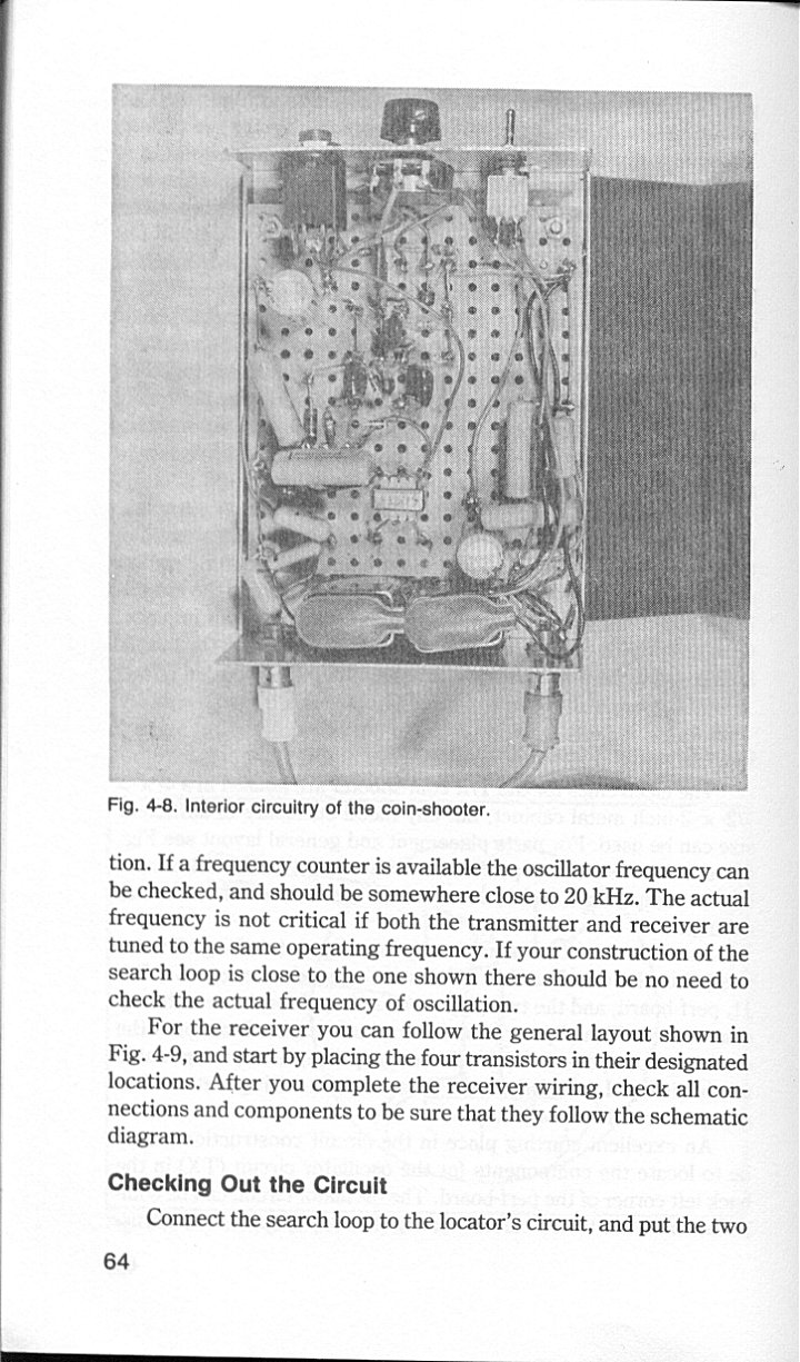

                              Pages 56 to 64 of Chapter 4 attached below, plus list of contents:
                              More to follow...
